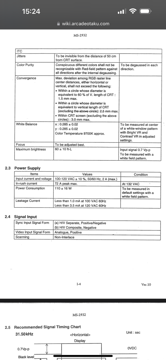

the scart2vga has a switch for sync splitter. The monitor is a nanao ms2932. I’ve no idea if this accepts RGsB.
This page shows its accepted type of sync. Am I right in saying this is composite sync or h/v sync and RGsB is not supported?
