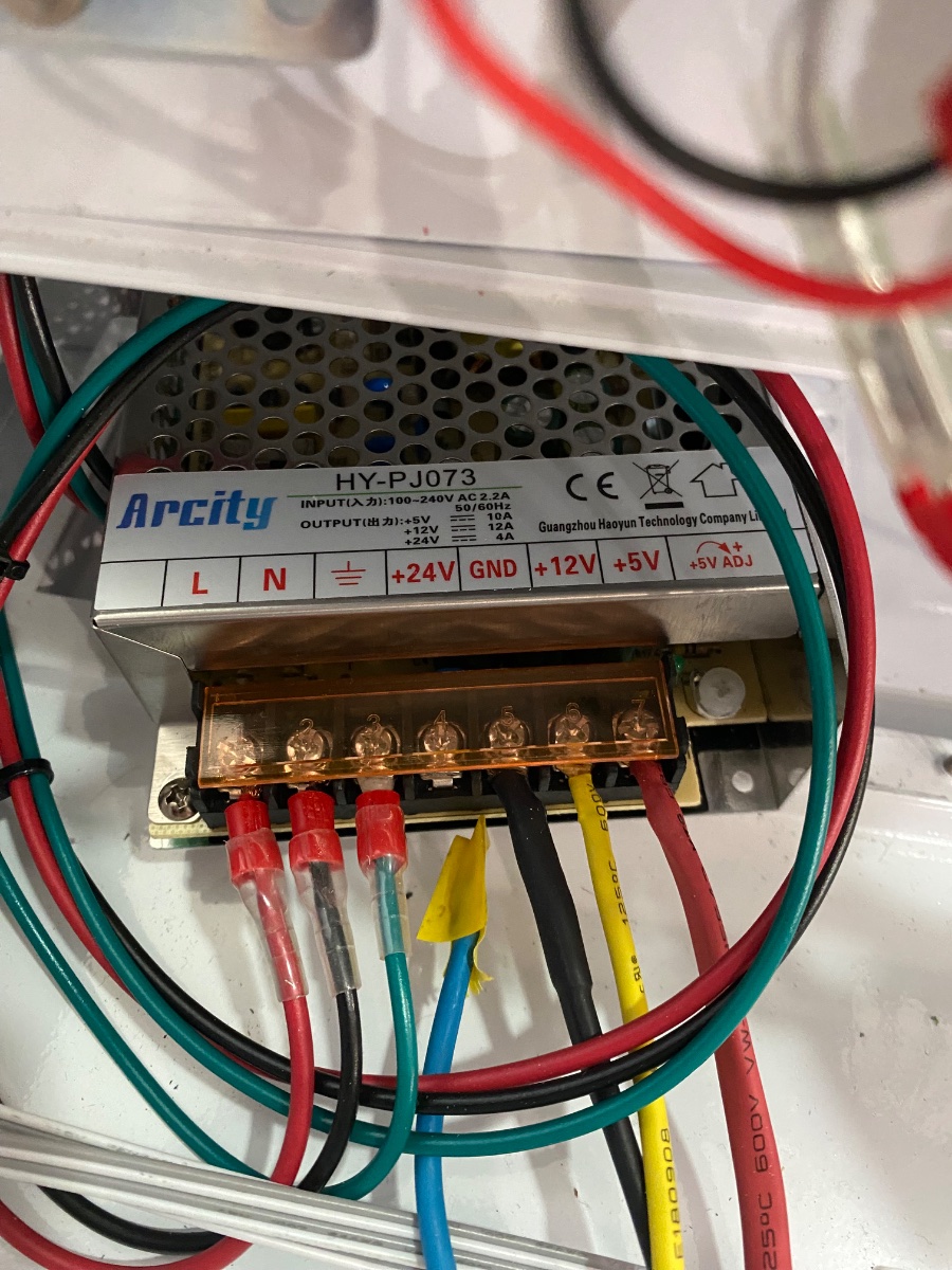

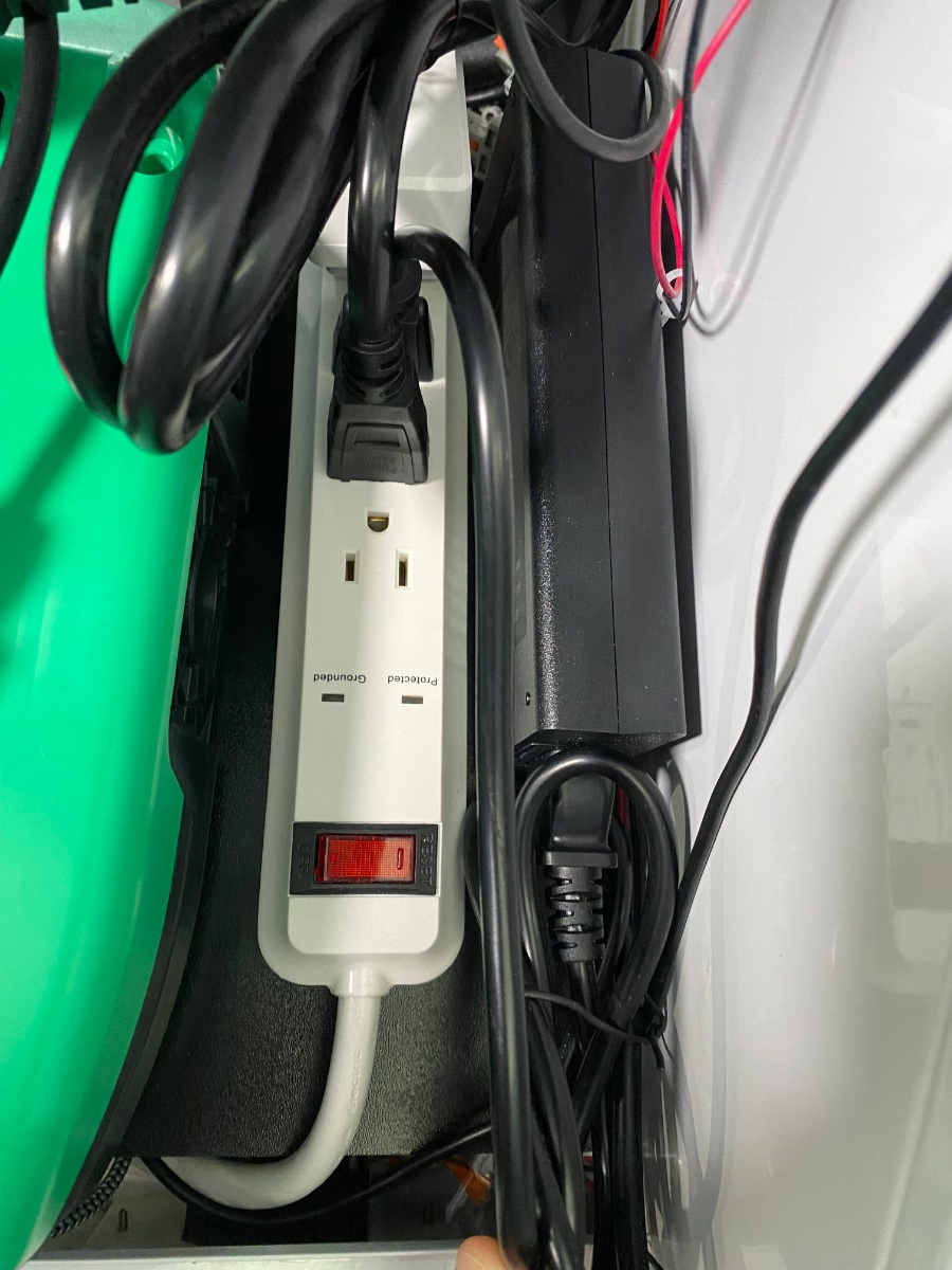

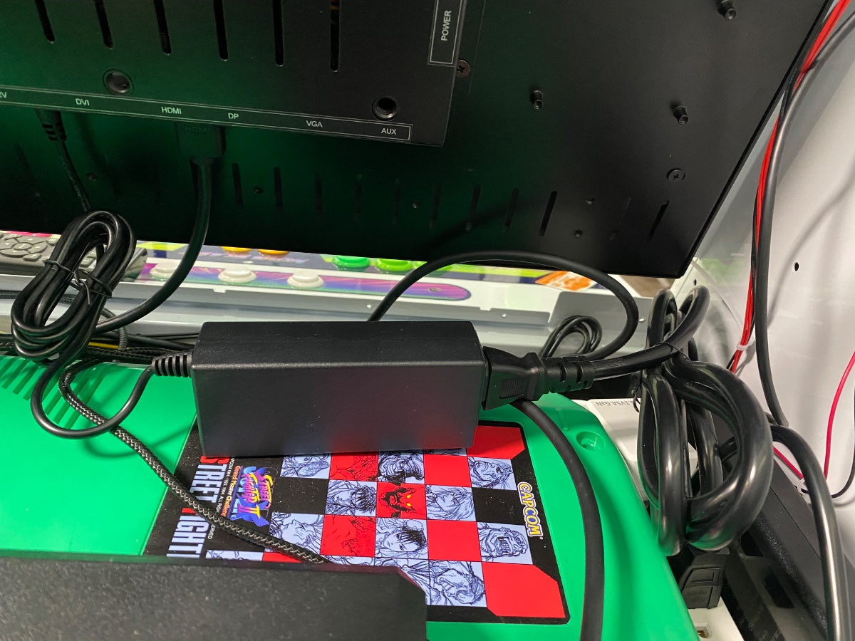

Appreciate you reading. I have converted over a Nova Blast cab into a more traditional candy cab with a dedicated PSU for the Jamma and introduced a power strip to feed my monitor and several USB-powered items. The power supply I am using is a 5V/10A attenuated PSU I bought from Amazon (link).

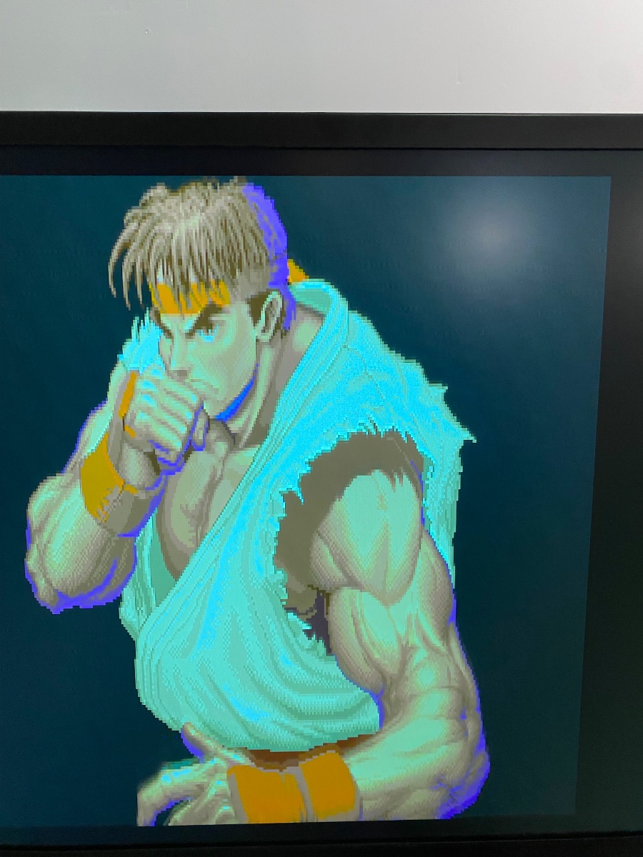

I didn't really notice the ripple until I got my new monitor. It is an Arcooda 4:3 Ratio Arcade LCD Monitor 15khz 24khz 31khz up to 2880x2160. After testing the monitor with other sources and reconnecting the old monitor, and confirming it is there but less pronounced, I went back to reviewing my setup. I figured the issue is between the PSU and the Mini Gun. I started reading about earth grounding and the importance for older monitors.
My PSU does have an earth ground port, which I have tied to the green wire in my power cable. I thought that would handle any grounding needs. Do I need to tap off of that port and ground to the inside of the cabinet, too? Also, this is present on a new LED arcade monitor with its own power supply plugged into a surge protector. It doesn't exactly mirror the described smoking gun scenario. If I am getting AC ripple, can I ground the supply, or would I need to replace it? Or is this just want I should see and I didn’t notice in the past playing on CRTs? I attached some photos.
In case anyone is curious, I took two videos, one showing SSF2X and another using my laptop when connected to the monitor. Sending a video into the monitor not tied to the PSU or jamma setup passes fine. Through Jamma, I seem to have some interference unless I am just mistaken, and that is normal?

You may wana bridge ground on dc side and ground on ac side of your power supply
Thanks for sharing this! Okay, so would I bridge them or tied out to a grounding spot in the cabinet?
If I am doing a grounding spot, I would need to create one… any guidance there?
And sorry last one, does that look normal, or does it seem to be some kind of interference from your perspective?
I had same problem in my setup and bridging DC ground and AC ground completely resolved it
You can read it here
That’s amazing! OK I will try that this evening. What gauge do you recommend? Assuming AWG 18 would be fine?
