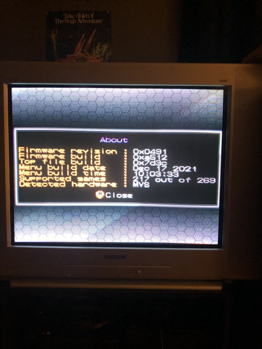

Here's the info on my MultiMVS About screen:
FW Rev: 0x0491
FW Build: 0xa512
Top File Build: 0x7d3c
Menu Build Date: Dec 17 2021
Menu Build Time: 10:03:33

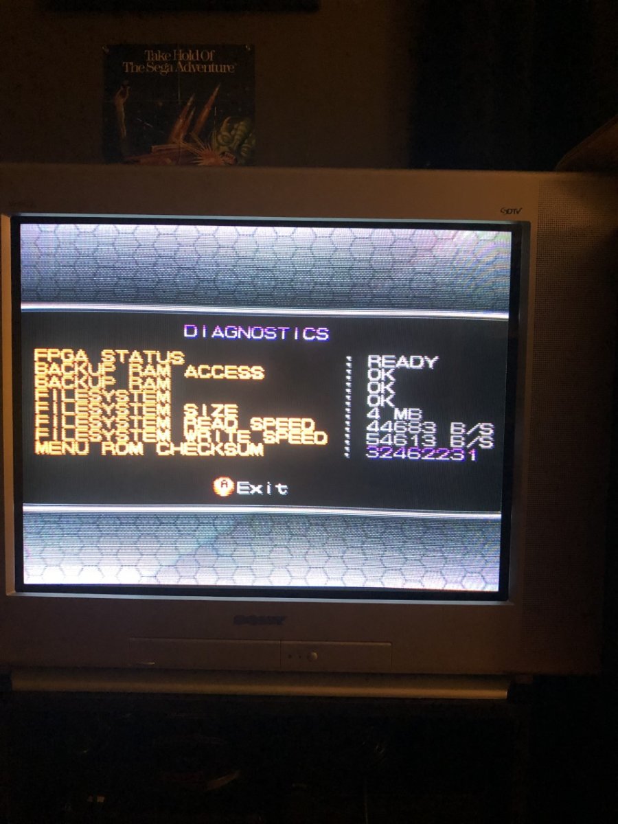

Here's the MultiMVS Diagnostics Results:
FPGA Status: Ready
Backup RAM Access: OK
Backup RAM: OK
Filesystem: OK
Filesystem Size: 4MB
Filesystem Read Speed: 44683 B/S
Filesystem Write Speed: 54313 B/S
Menu ROM Checksum: 32462231

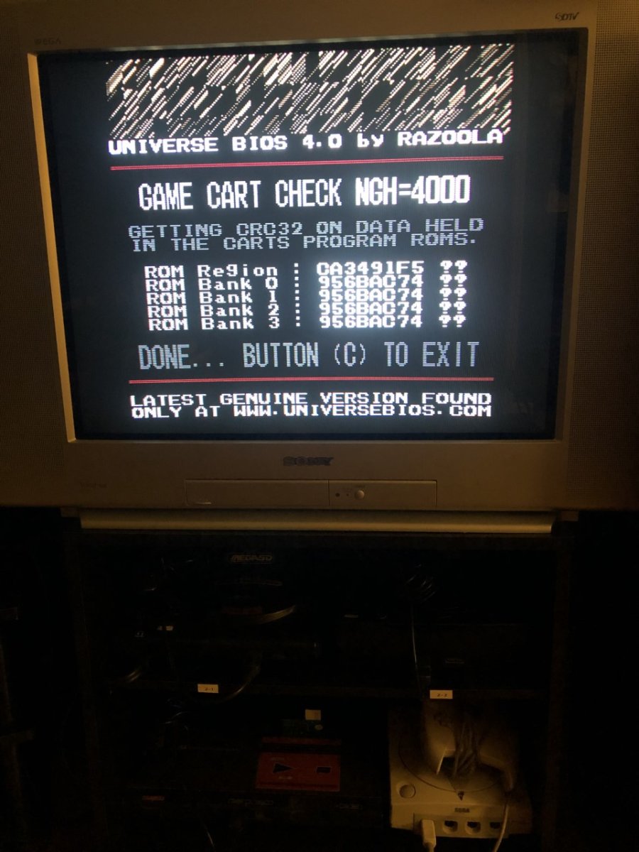

Using the Unibios cart checker, I get:
ROM Region: CA3491F5 ??
Rom Bank 0: 956BAC74 ??
ROM Bank 1: 956BAC74 ??
ROM Bank 2: 956BAC74 ??
ROM Bank 3: 956BAC74 ??
FW Rev: 0x0491
FW Build: 0xa512
FPGA Status: Ready
Backup RAM: OK
Filesystem: OK
