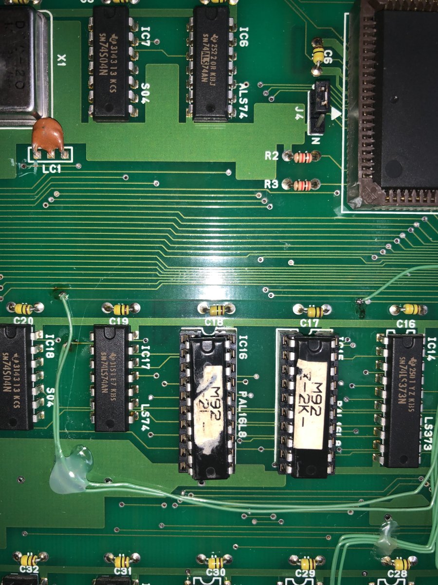

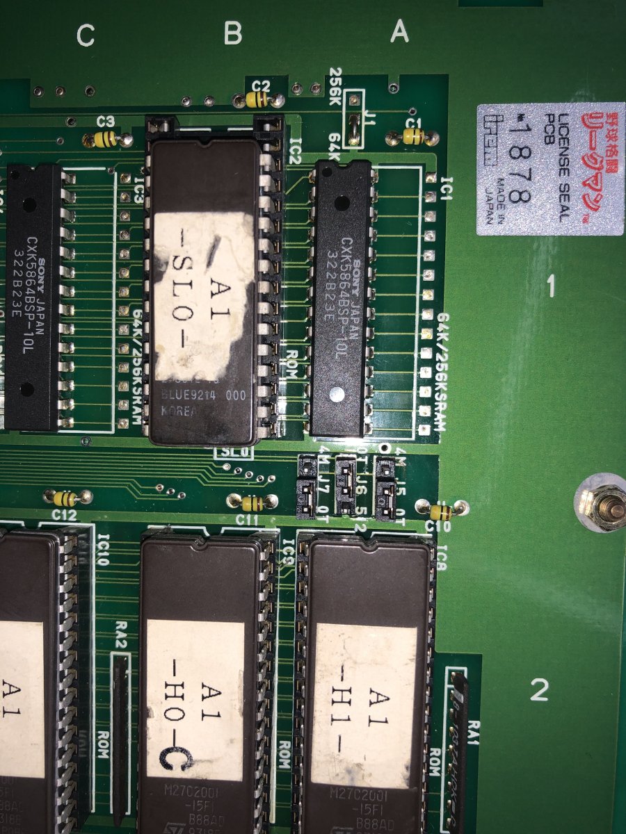

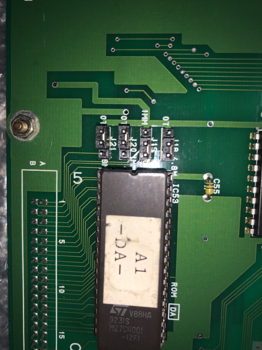

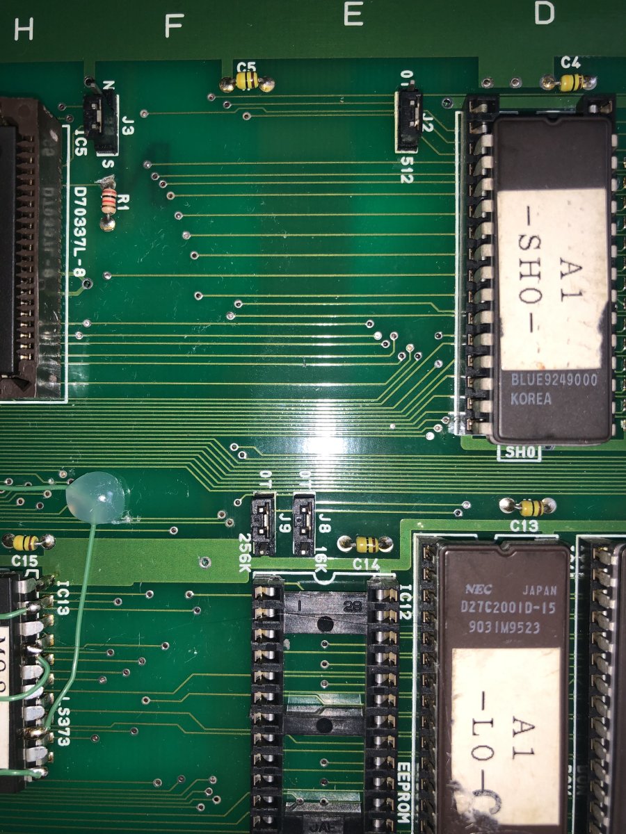

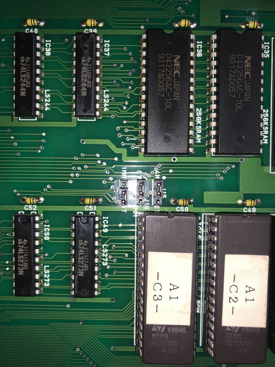

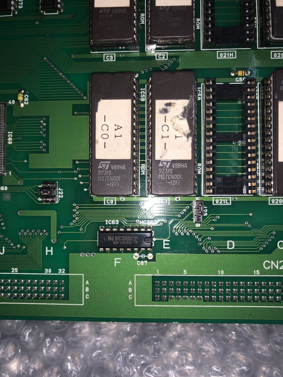

I bought my Ninja Baseball Batman (jp vers) from Fujita in 2005. It might probably be a factory conversion by Irem from another game rom board since it has the seal of the game on the rom board and not on the mother board. Plus many bridge wires on the rom board.
I ain’t got much knowledge about the different M92 rom boards but if a picture of mine could help to compare with your Major Tilte 2 and see if those bridges could help or not leave me your email adress in PM 😉
Hi. Sorrry for the late reply 😓
Here are pictures of my rom board where jumpers are located 😉
I hope this could help…
