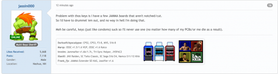

I've never plugged in a JAMMA harness backwards...
I continued to edit that post so you know where I'm coming from (agree or not).
So what you're saying is they removed the feature where it shows that a post has been edited, and how many times?!?!

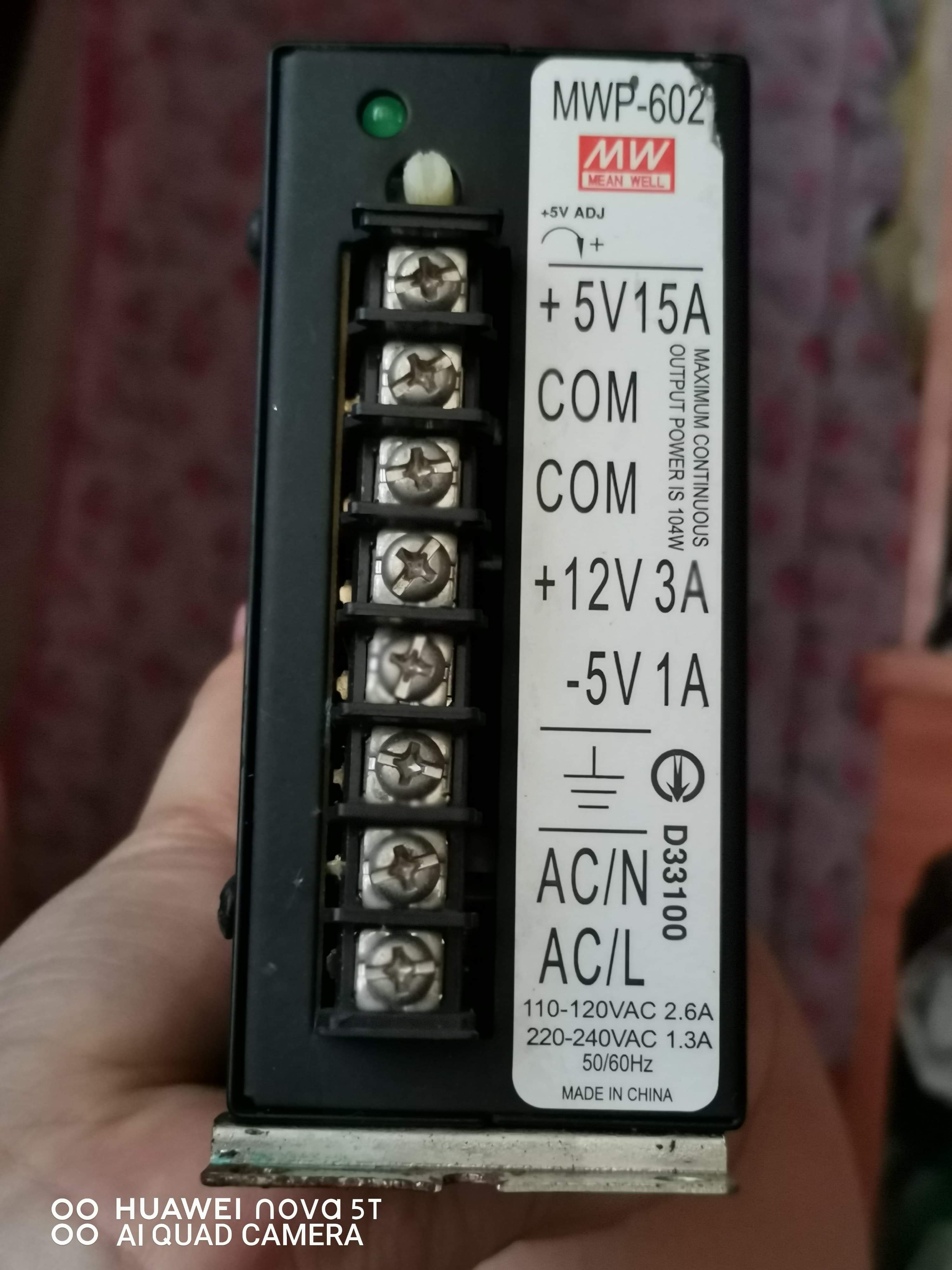

I have same accident like this , but i have a power supply that automatically turned off once it detect or put accidentally the board in backwards , then from now on i search those specific power supply to use in case some miss input the board backwards again
Wow, please link, this sounds like a must have!
Here's the power supply

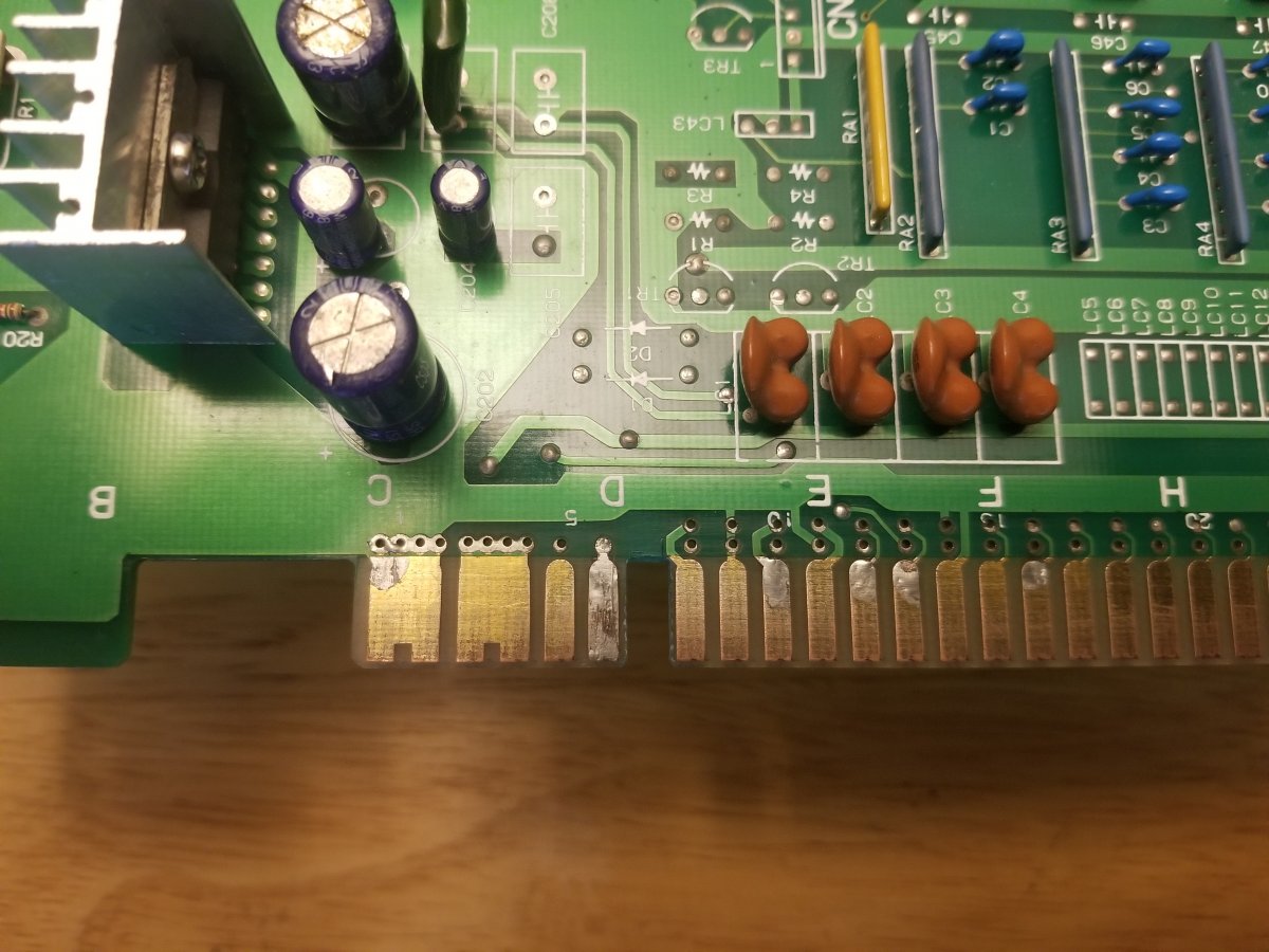

Not to bump an old thread for no reason, but I did this recently on a Korean Geostorm and it came out pretty good (board is filthy gross and has all sorts of cosmetic damage but works perfectly).
Started with a razor knife and then finished with a saw and carefully scored the last inner bit before twisting off with pliers.
the pinout is jamma, but the makers - usually bootleggers couldnt be bothered to cut the slot
