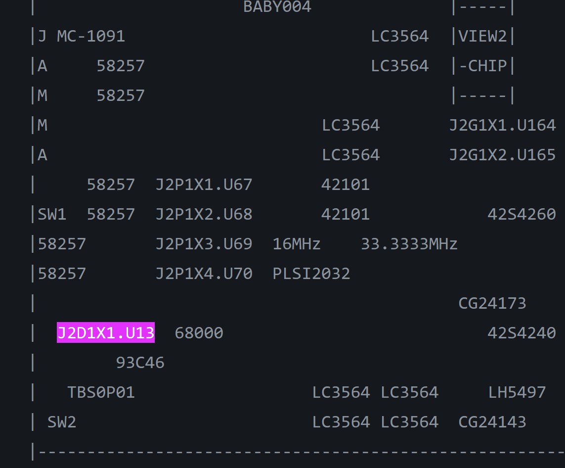

Looks like if i 'pull' that chip in mame, i.e. fill it with zeroes, I can trigger a G error. j2d1x1.u13
Good place to start!
ROM_REGION( 0x020000, "mcudata", 0 ) /* MCU data */
Yeah, it's their version of security, it's the micro controller.

Actually reseating the eprom worked, but also reset itself again. I wonder if the socket itself is just making poor contact with the eprom, at least I know where the problem area is now, thanks!
E: actually after reseating it it's resetting way more weird I may just replace the socket and also swap out that eprom with another.

Well I reprogrammed my U13 with a M27C1001 and it just werks?
For some reason there was an M27C2001 in there, probably what came on the game originally, I doubt I doubled up the bin when programming it.
I've still had it error when starting a credit once but it boots every time now, that's good enough or me. I'll see how it goes at EVO.
