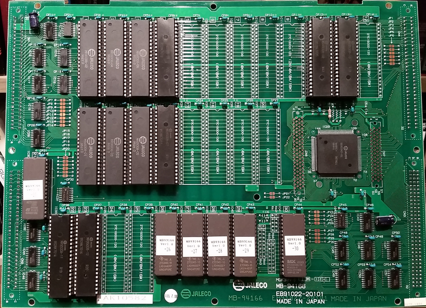

What's the version of your game (probably best taking a picture of the romboard with the shell removed)?

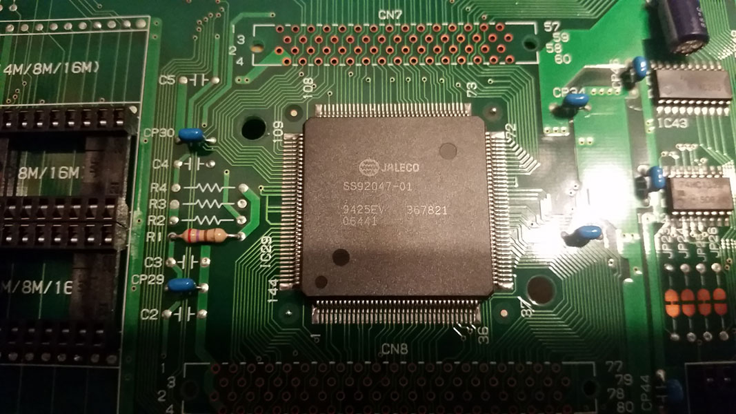

My IC10 and IC30 from Angel Kiss match with Angel Kiss in MAME, but the security chip number on my PCB is different than the one listed in MAME.
MAME says: Angel Kiss - Custom chip: JALECO SS92047-01 9423EV 450891 06441
mine is: SS92047-01 9425EV 367821 06441
I don't think the different numbers in the chips references are a problem:
9423EV 450891 06441 => 9423 is probably the datecode (year = 1994, week = 23), followed by the batch/lot number
9425EV 367821 06441 => 9425 is probably the datecode (year = 1994, week = 25), followed by the batch/lot number

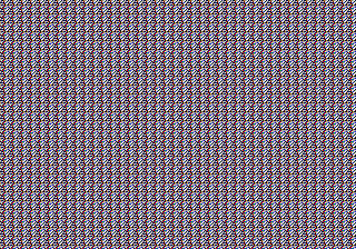

Here's what I get in MAME if wrong security chip is used:

it does look different than your picture, mine LITERALLY looks like classic TV snow, it's not still either, it even moves like it:

I haven't really looked at how the main board is laid out, but most of it is covered by the ROM board (it's similar to the Taito F3) so probing the CPU might be difficult. I'll see what I can do though.
