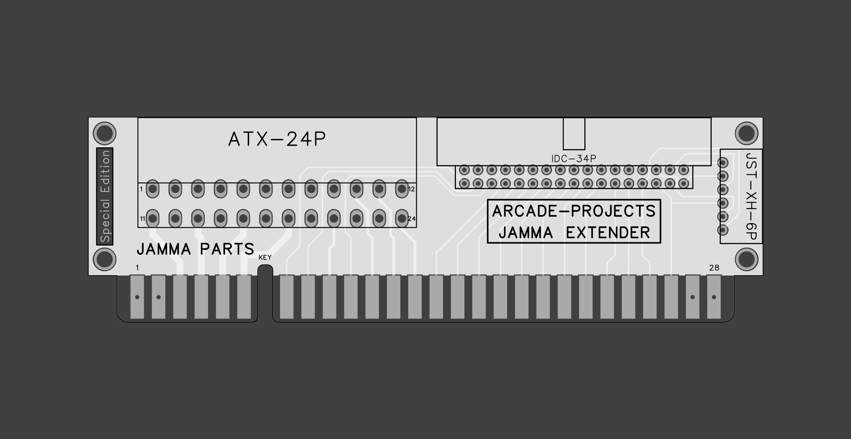

I will be doing a run of jamma extender boards which feature HAS kick harness support.
You simply connect your HAS kick harness cable from the arcade game board to one end of the jamma extender (which has the same kick connector as found on the HAS).
At the other end, a supplied 20cm patch cable will run from the HAS to the other extender PCB.
These will be fully assembled with all wiring looms included. I'll be making the ATX cables myself with braided wire.
I AM NOT SUPPLYING "HAS" KICK HARNESS CABLES.

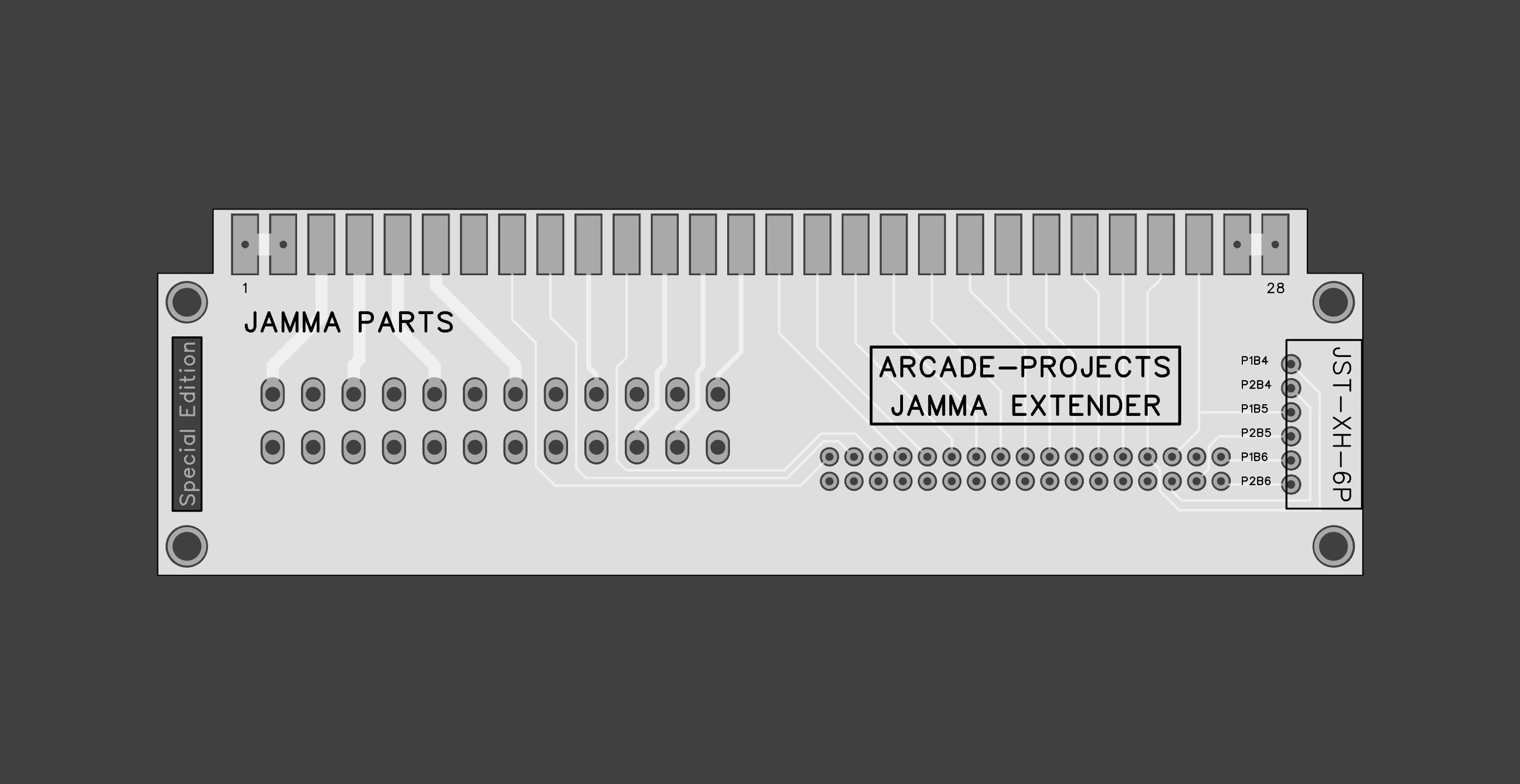

An idea to optimize the design - the HAS (and many other superguns) is capable of outputting 6 button signals via the JAMMA edge, so maybe you could connect the 6th button on the JAMMA edge (the one that goes to the supergun) and maybe add jumpers/dip switch on the other end of the harness? This will eliminate the need of having a harness between the supergun and the extension end that goes to it. Without a means of disabling the button 4 on the JAMMA connector you also get that input conflict in some CPS2 games.
Otherwise, pretty cool idea, though not sure why it should deserve the "HAS Special Edition" branding. The extension will work fine with most superguns out there.
It kind of makes me want to have my own take on designing an extension harness :D
Thanks RGB, that is a great idea! I will implement it.
I called it the HAS edition as it follows your kick harness pinout. My pinout differs so as it stands it wouldn't be compatible unless one rewired the kick harness to suit. I'm not sure what other superguns are using, I imagine anything will be compatible with an appropriate harness.
