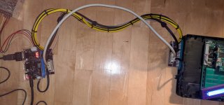

I designed my own JAMMA extension setup. The prototypes just arrived. I'm wondering if I should order more and offer them for sale?
  • A HAS/Minigun style kick harness port is included on each end.
  • The power channels use a molex mini fit jr 8 pin connector
    • GND (3 pins)
    • 5 Volts (3 pins)
    • 12 Volts (1 pin)
    • -5 Volts (1 pin)
  • Audio uses a 1/8 inch TPS (GND, Audio+, Audio-)
  • Video uses a DE-15 (VGA)
  • Everything else uses a HPDB50 (50 pin SCSI 2)
My idea for using SCSI 2, VGA and 1/8 TPS ports was to make it easy to buy pre-made cables of whatever length was required. The power cable is not off the shelf. I was able to get some power cables made by a seller on aliexpress for a reasonable price.
If I do sell these I think I would either sell bare PCBs or assembled PCBs. The buyer would need to source the cables themselves.

Let me know if you are interested.

Humm it sure looks interesting :)
You just have to buy the cables and its good to go?

so an extension would be best :3 i could put the pcb besides the cab.

Certainly, just leaving the audio cable disconnected on my boards will mute the audio.
I have not tested it yet, but I think running the audio cable from the CPS2 RCA outs directly to the audio input on the supergun/cabinet extension board would result in neo geo MVS style stereo.
