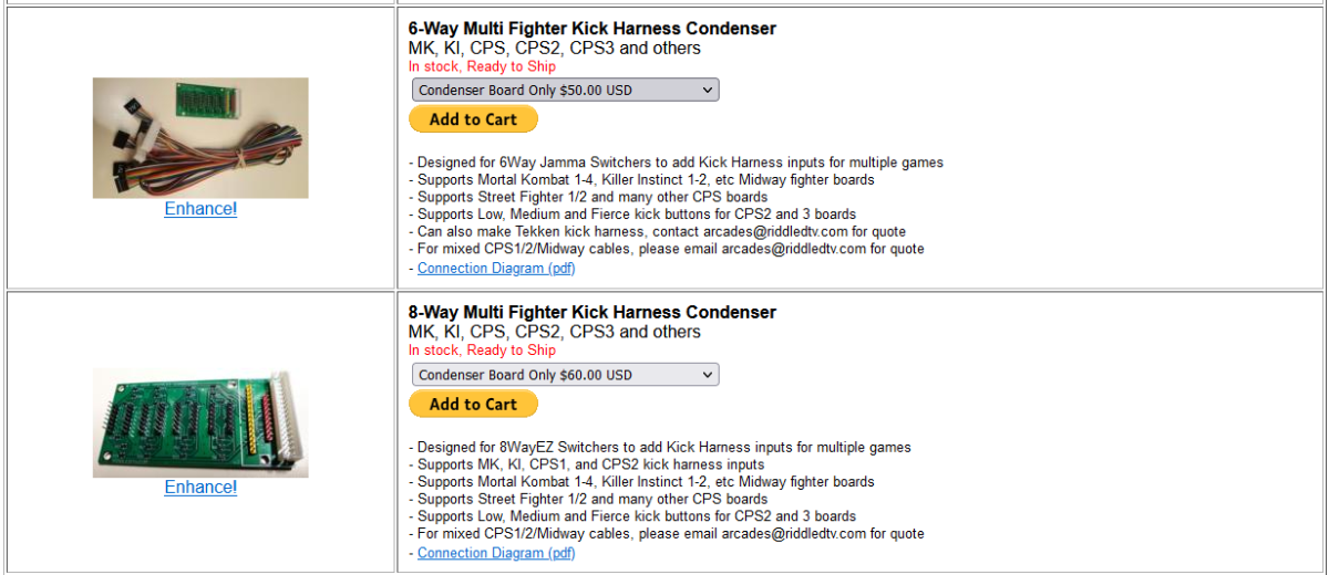

He sells Kick harness condensor boards that fix this :P I use one for my MK2 cab. have 6 games running in it. works like charm.

Dude could just have like a 6 pin 2.54 header for each board right on the PCB, and then an input header for the panel's buttons. Needing an extra $50-60 part to do the same is kinda wack
Thanks, but, I bought a 2 way switcher. Looks like his multifighter condenser for CPS1/2 etc. are for his 6 way and 8 way switchers only.

The kick condenser runs stand alone from the switcher, they don’t have to rely on each other, and have no physical connection to each other, the only negative of the proposed setup is you have 6 way kick and only 2 way PCB, so are paying for 4 more kicks then you can use.
I’ve got multiple 8 ways, 2 ways, kick condensers…etc all from riddled tv.
Have a chat to Jim and explain your desired setup and he will be more than happy to address any issues or concerns 👍
you should just be able to connect both boards inputs at the same time.
the pullup resistors wont pass enough current to be an issue
