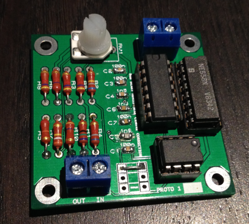

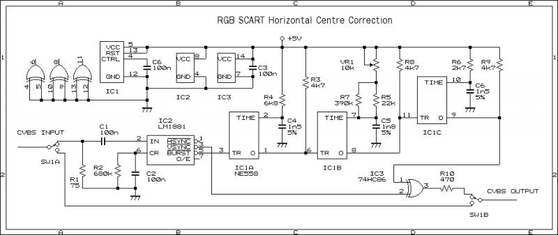

Yesterday, i finally received the last part for my build of Villetim 's H-Sync Shifter.
And here's my build to be tested ;)

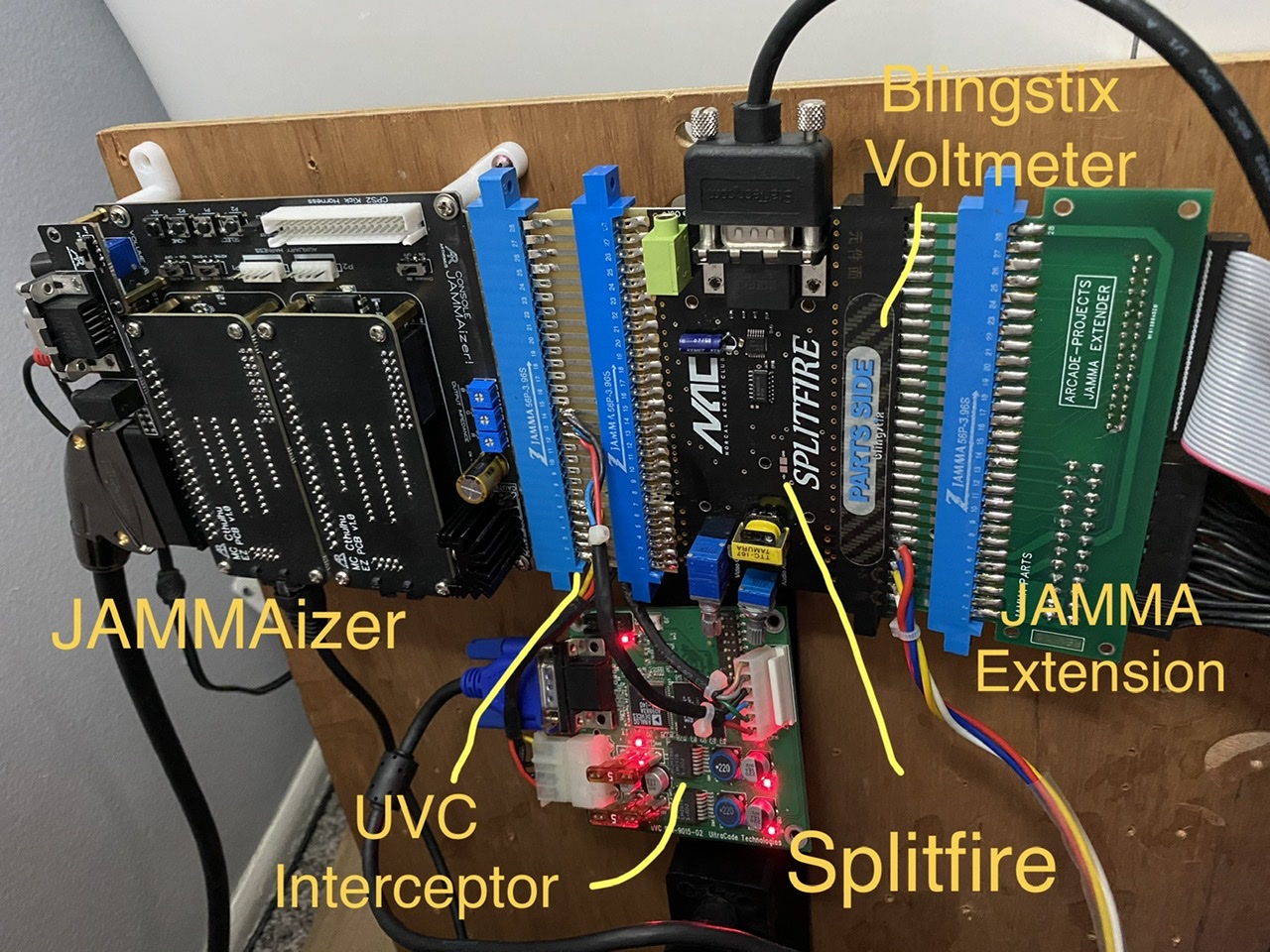

Getting the shifter is more for convience and accessibility from outside the cabinet. I plan on building a PCB switcher cabinet that sits next to my NAC. The Switcher cabinet is going to host an 8-way switcher, and output through a JAMMA extension cable to my NAC. My goal is that I don't want to keep opening up my NAC to adjust things. Having multiple PCB's coming from one box, plus Consoles through the JAMMAIZER having a handy shifter without opening up my CP everytime would make the process easier.
