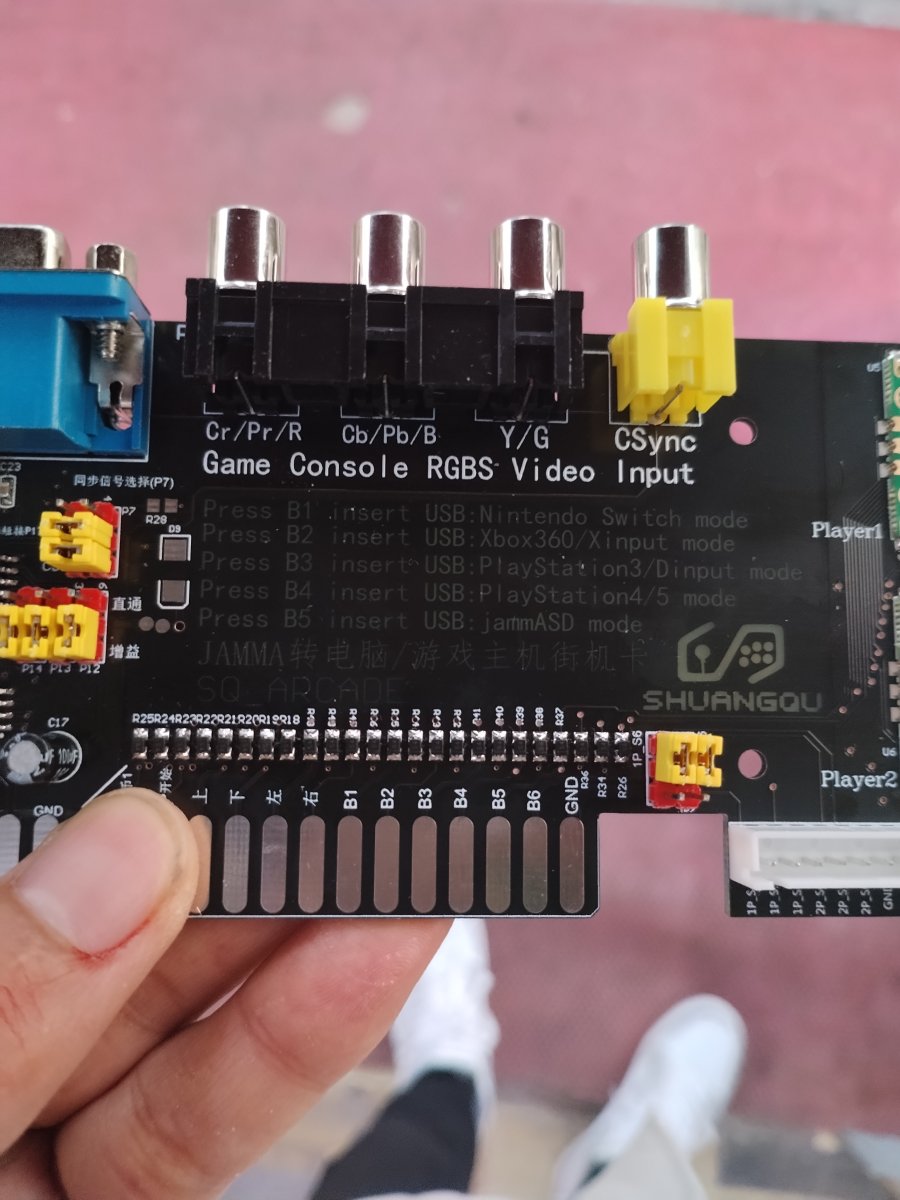

你好,需要配置成PS4 work mode,请看图片。按住BTN4然后再上电,配置成PS4模式,玩家1和玩家2都需要这样配置。

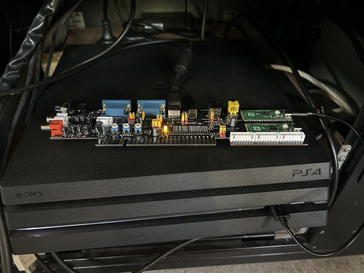

Can I please have a picture that shows it connected to a ps4 working. I have tried multiple different setups and none work. Here is a photo after I setup with jamma connected and pushed button 4. Now LED has changed from green to yellow. Still not recognised by PS4
单击展开...你好,需要配置成PS4 work mode,请看图片。 按住BTN4然后再上电,配置成PS4模式,玩家1和玩家2都需要这样配置。
你好,需要按住jamma金手指的B4按键不放,然后再插入usb线到ps4,才可以切换为PS4 work mode
记得跳线模式切换到 JVS2PICO模式。才可以用JVS控制您的ps4
