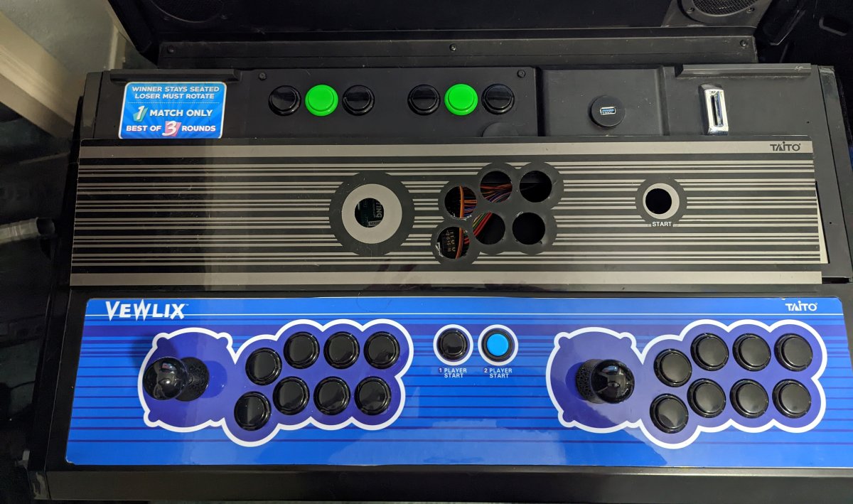

Couple questions - would anyone know what a single player (6 button) control panel would sell for? I took the one in my cab out and don't need it. Its a Chewlix/Repro/Knockoff, not an official Viewlix, so I dont want to say "GIMME 10,000!!" when it might be worth $2. It looks like this:
