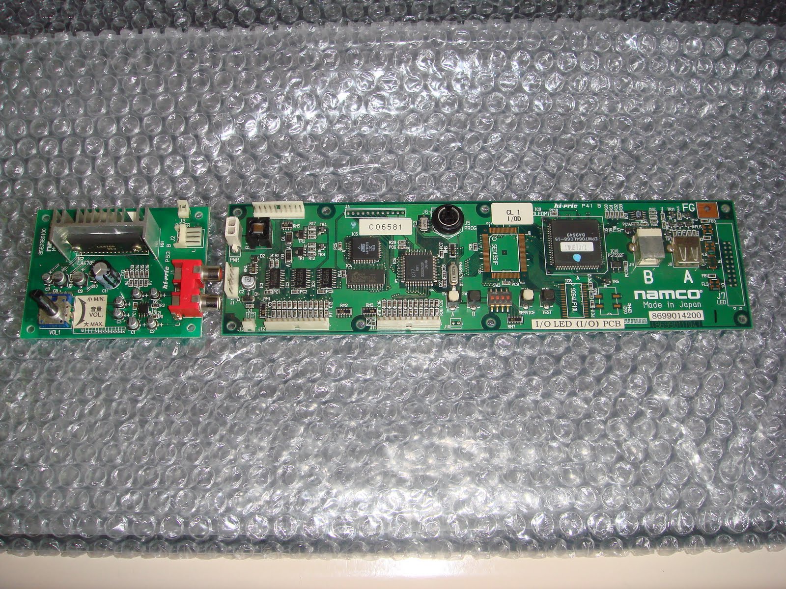

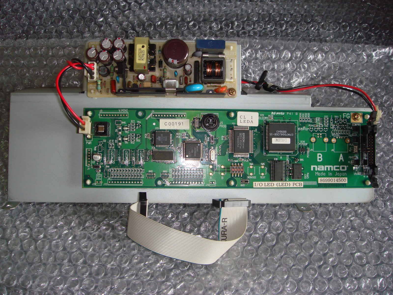

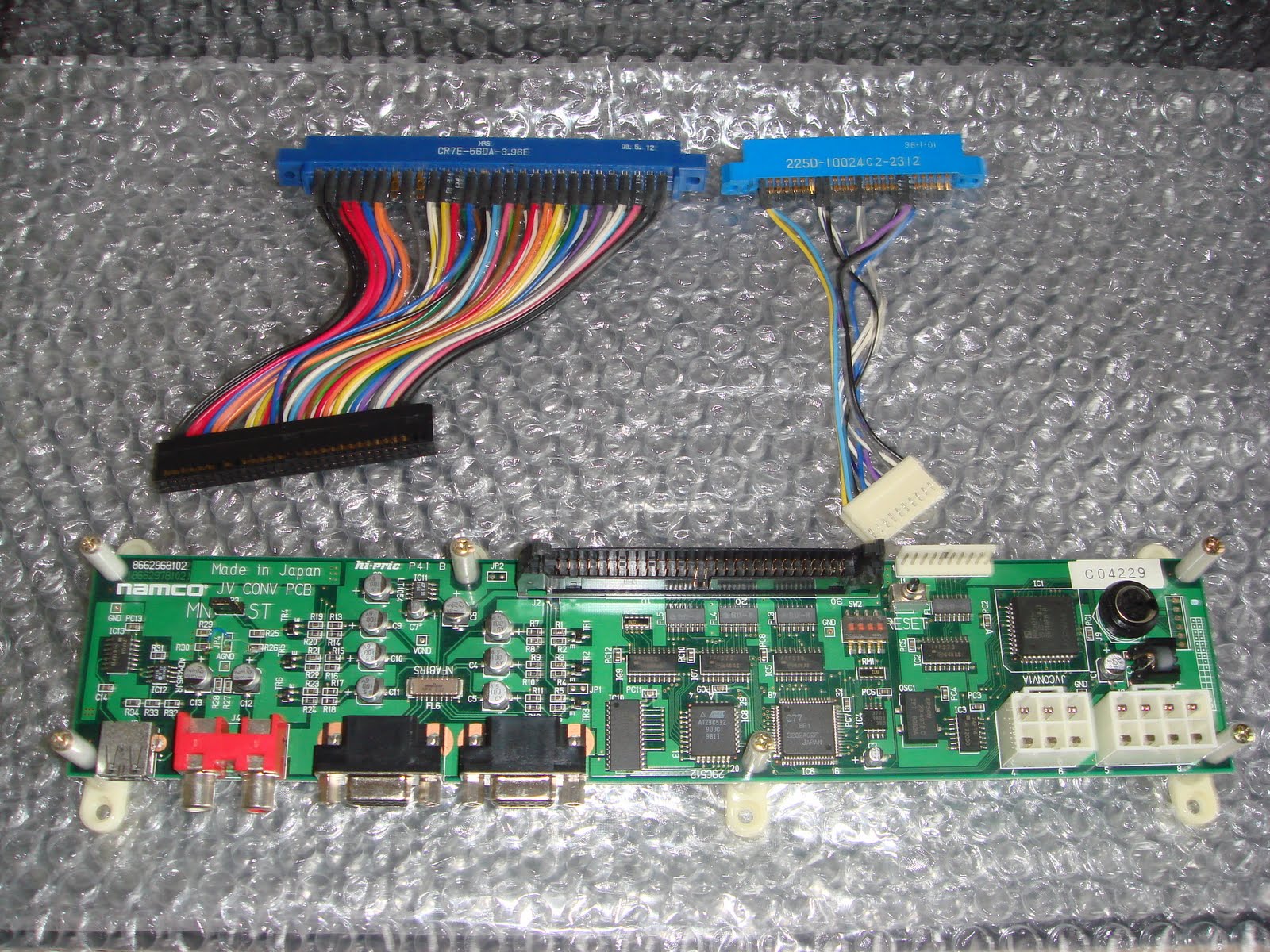

This is your board - It has a jamma side and a JVS side
Which of these do you have in you cabinet? You probably have both, When you use JVS show the exact connections and how they are connected that you are using
Jamma to JVS I/O
JVS/LED Marquee I/O
LED Controller
LED Panel
I have all the options as you describe them in my cab, the PCB's listed above are connected with the JVS part directly and I do not use any of the Jamma connectors or adapter.

The board which is crossed is stricly the JVS/Jamma adapter which is not needed when connecting a JVS pcb.
The led board and control I/O board are one and the same, this is standard Cyberlead.

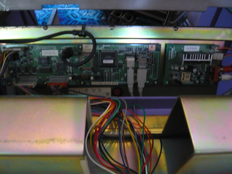

I think you are missing JVS connections, check inside cab somewhere on top of the coin box and see if there is another board in there. if there is, post a pic.
Then make all connections from the game pcb,vga/audio/jvs-usb to that board.
Then, from that board should be another A & B usb connectors and rca/audio, connect those 2 jvs usb to the I/O board's usb ports,
also the audio rcas to the small audio amp board with he volume knob.
You should have this board somewhere in the cab:
Game PCB goes connected to this
From there, the 2 JVS go to the I/O
Yes that board is in the cab as well, it is currently NOT connected and all connections bypass this board.
This is the system link board to connect 2 cabs together.
But who knows, I will give it a shot over the weekend and try connecting everything via this board.
Do you know the function of those USB cables as there are 2 going to the I/O board?
