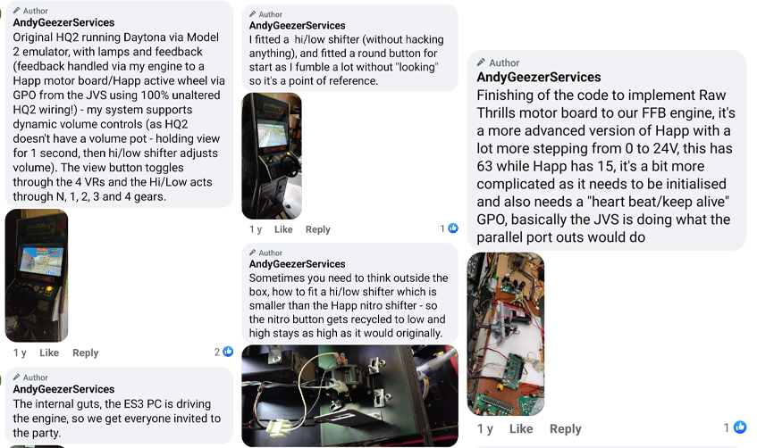

Andy Geezer was working on something like this, interface a PC and emulators directly to a JVS wired cab.

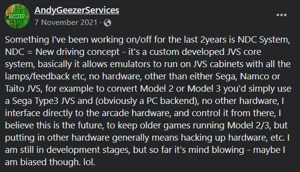

As it as already been shared, here is the full Geezer post
