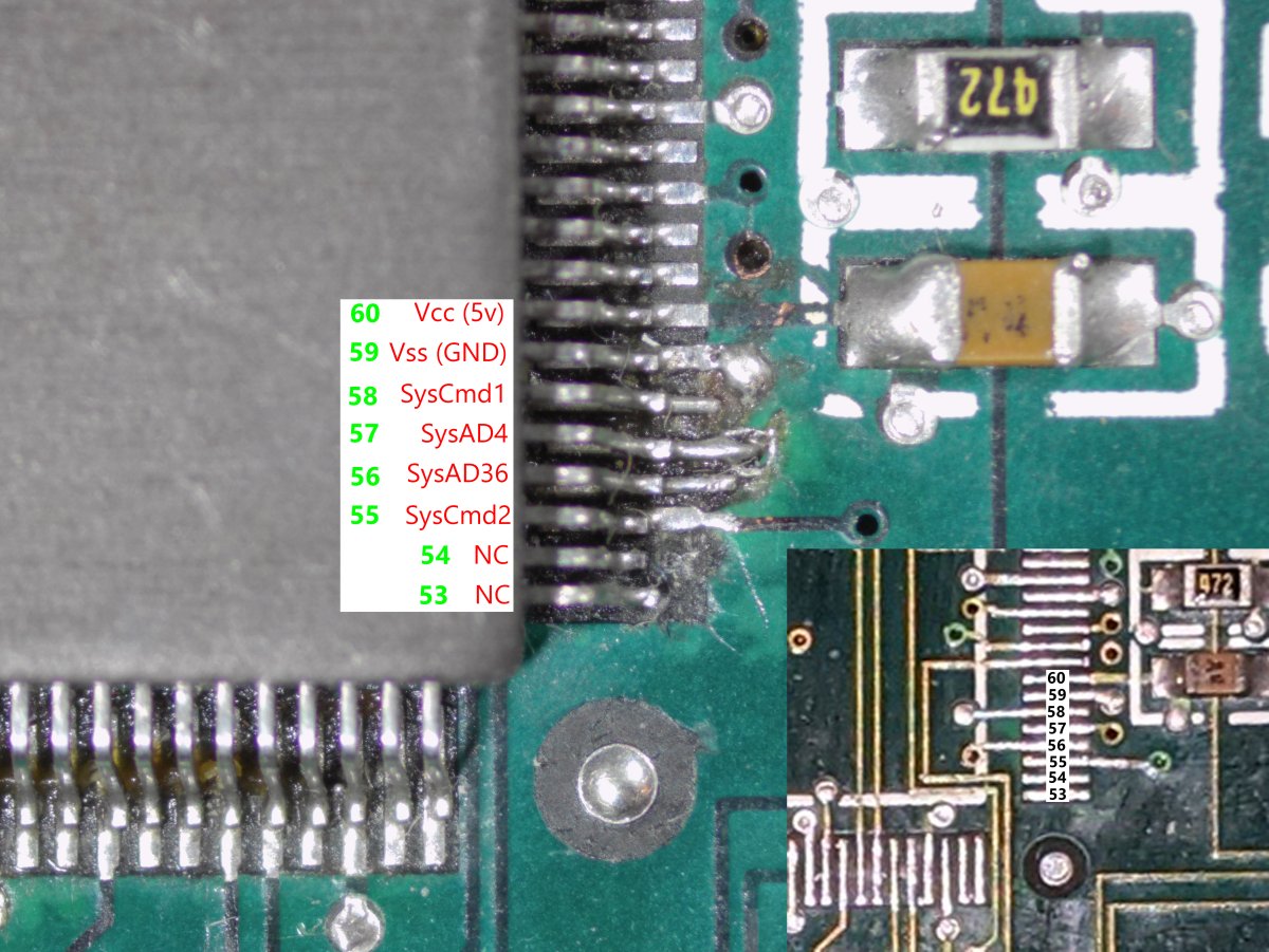

Then, I inspected the main CPU with MM and microscope, and sadly found a huge mess on one corner (6 pins at least, maybe 7, starting from #53)
No other pin look lifted and I did my best to check continuity between the legs and the pads of all the other pins of the cpu. Everything seem well soldered.
Here is the mess:

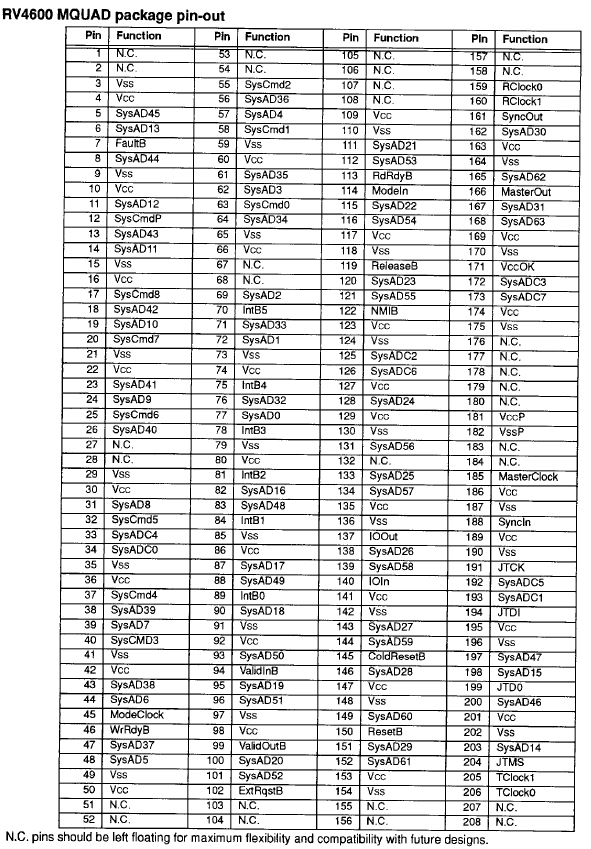

My first though was it's dead, because of the missing 53 and 54 pads. But according to the datasheet 4 pins on each corner are N.C., so basically useless ?
After a deep MM test, despite appearances, all the pins are connected correctly except for pin 57.
Pin 60 is connected to the cap
Pin 59 is connected to the solder blob, connected to GND
Pin 58 has continuity with his counterpart on the other side of the PCB (managed to understand where to check thanks to the picture showing the traces under the IC), same for pin 56 and 55
The only one I can't check is pin 57, it's not exposed on the other side of PCB and seems to go nowhere. Maybe there's an intermediate layer of the PCB, invisible from either side ?
Do anyone know where is it supposed to go, and how to check ?

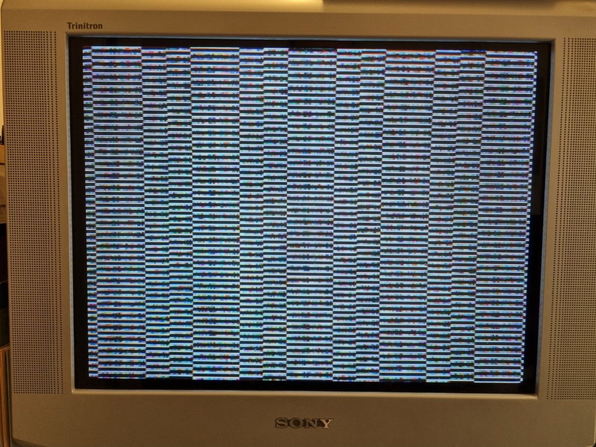

Ok, after the diagnostics, I was optimistic but, to my dismay, this is the only thing I got from powering up the board :
What you think about ?
I read in another topic with the same image on the screen that it could be loose pins on the Main CPU, loose pin on a 74 chip or a bad 74 chip.
There's a bunch of 74 chips .... is there a way to test these chips ?
Don't know if there's one or multiple "bong" at the moment cause I still missing the parts in the audio circuitry...
That is the screen you will see with a dead cpu or bridged pins or pins not making contact with the board.

looks like some tracks are corroded - strange unless it was stored in a stack of other pcb's that had a battery among them.
@MickyMac I've looked for 79R4600-100MS on utsource and found this listing https://www.utsource.net/itm/p/9226474.html Is it a fake ? I asked the support why the listing shows a 79R4650 picture and they told me it's a mistake. The part is the 79R4600-100MS and they're available, used but available. According to the description 98% chance the part works 😁
@stj You mean around the 53 to 60 pads ? It makes me think they tried to desolder the cpu and they tore off a piece of the pcb when pulling the cpu, while solder weren't totally melted. Then they tried to repair the mess but the pcb still doesn't boot, and they quit.

No idea on the specific "74 chip" that can cause these symptoms. Perhaps message CoolFox to ask what 74 chip he was referring to?
