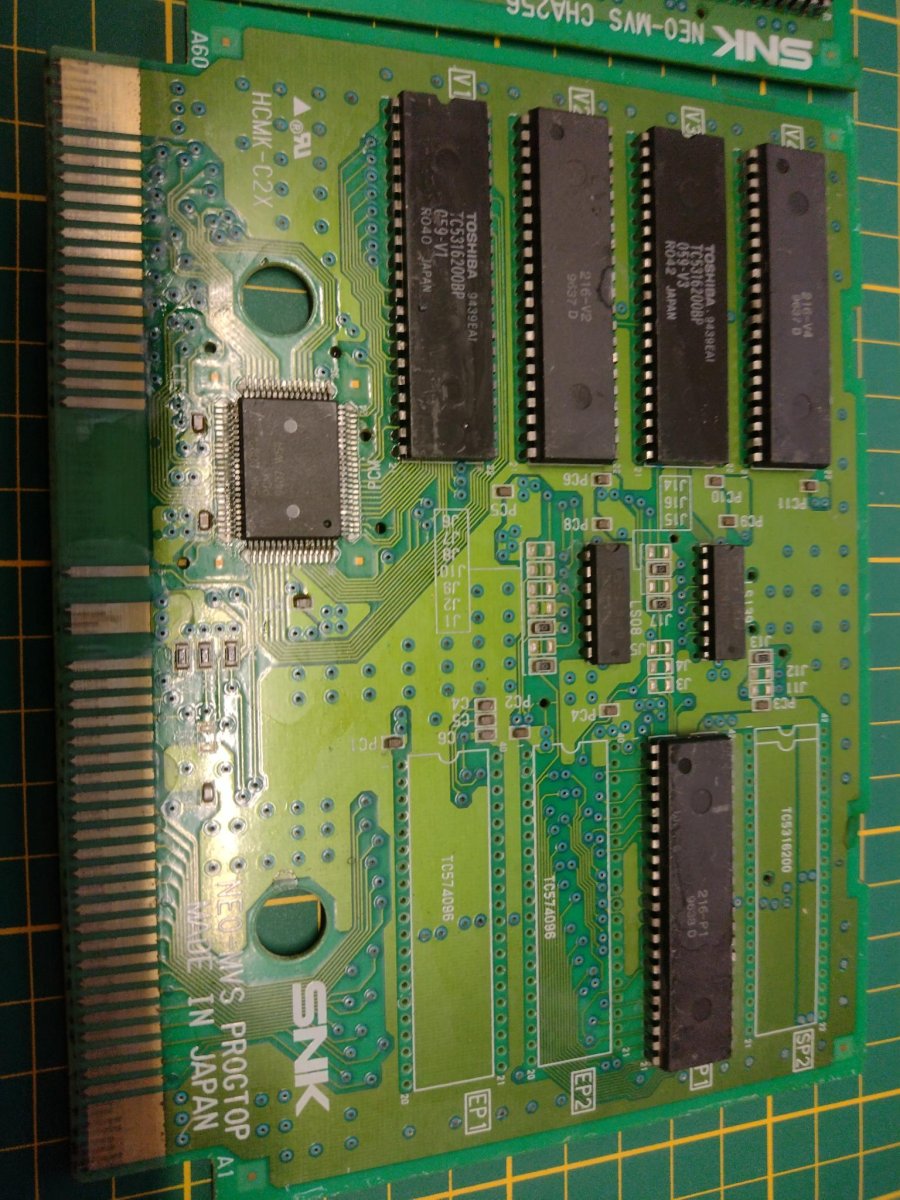

Take a nice and hi-res picture of Prog board, and post here. So we can see.

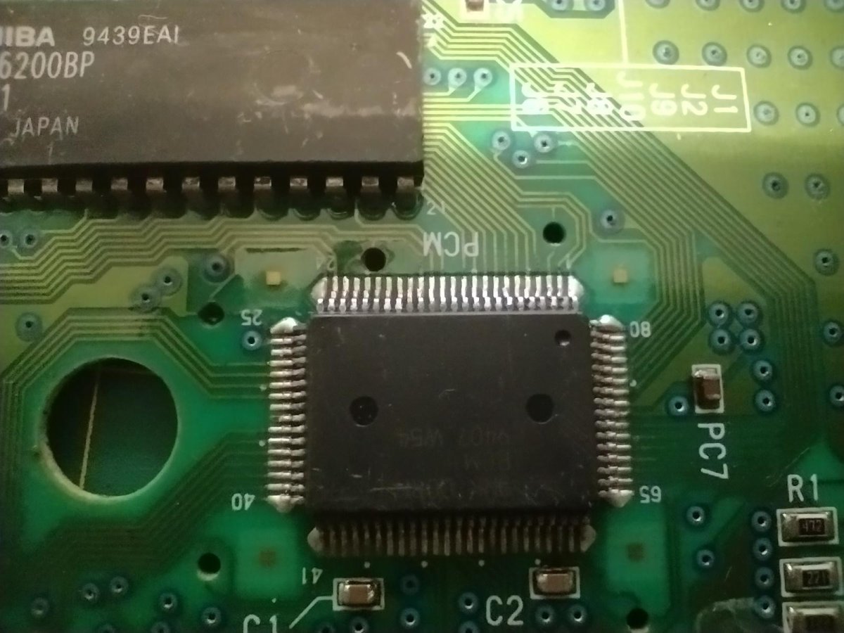

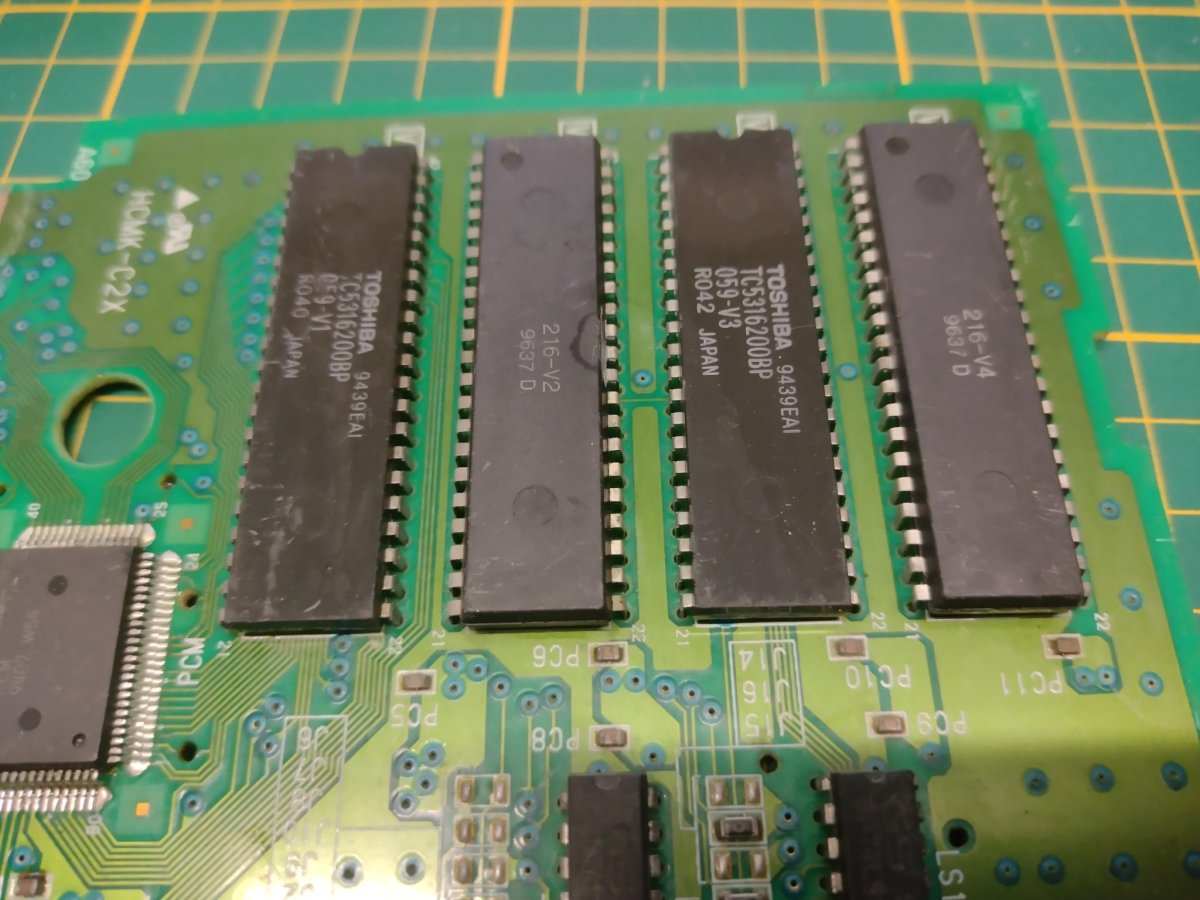

Looking at the picture, 216-V2 seems to have some liquid spilled on it in the middle. Check the three IC legs yet? What's on them? It looks like some white crap?
The discoloration on top and on the site where there from the get go (mechanical stress or heat damage no clue really). On the pins might be residue from the methylated spirit (had no iso on hand). The three legs/solder points seem, visually at least, to be fine.

If some fluid dripped on it when the board was running, it may have shorted out the data/adress lines for that chip.

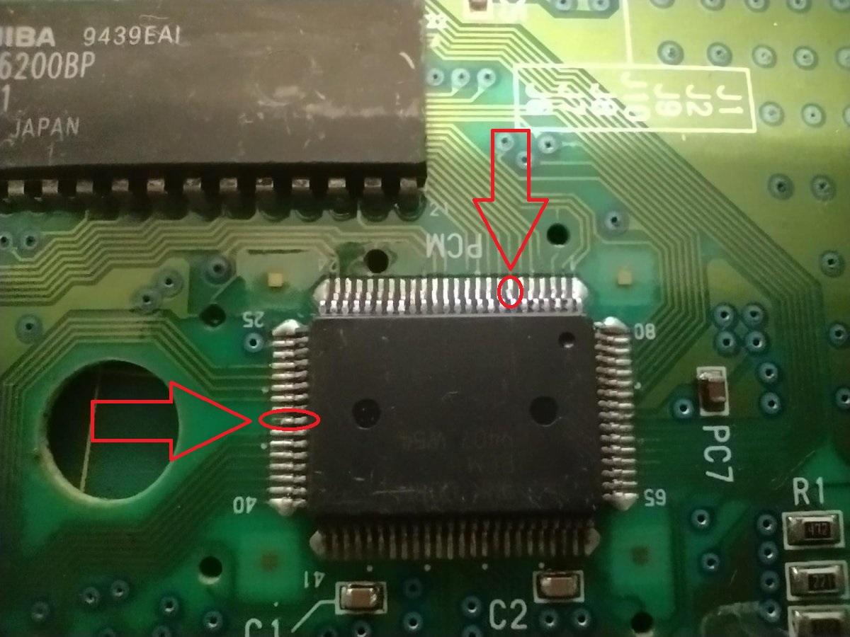

What the hell happened on this PCM Chip ;( ? Check if pins is moving and reflow it.. look like that some one have already changed it..

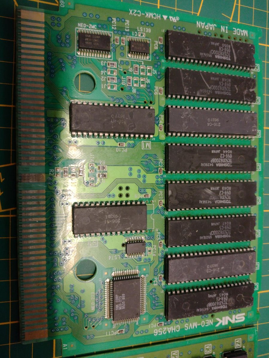

what happens on the other side of the board ? photos ?
yes v2 needs a deep cleaning and a crc test, definitely !
Sometimes you'll get lucky and simply reflowing a V rom will be enough.
