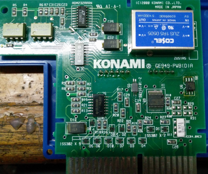

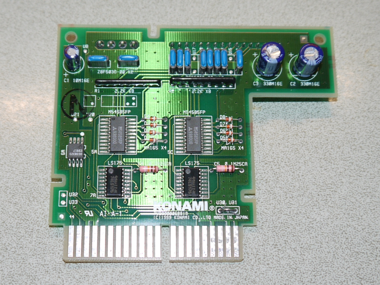

so far tested game : drummania GQ881 and percussion freaks 4th mix.
so basically, there are two arduino tools here.
securechiptool goal is to asses and to clear or mass programmed (a term for a fresh manufacturer setups where all password and fields are zeroed) secure chip in security cart, which is a must before using master calendar.
mastercalendar is to be connected to usb port located in front of motherboard, before the game booted, so the game can recognize it and proceed to the security chip initialization.
both arduino are to be connected to pc via usb for displaying debug messages.
some security cart variations...

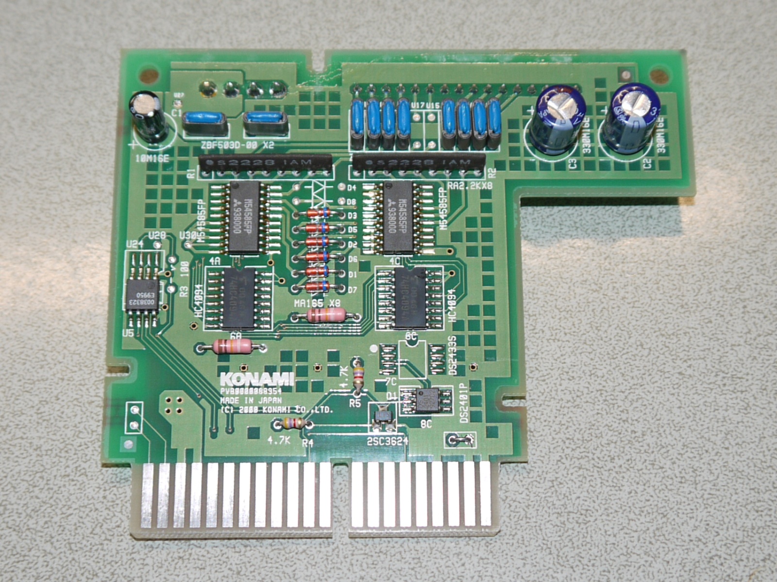

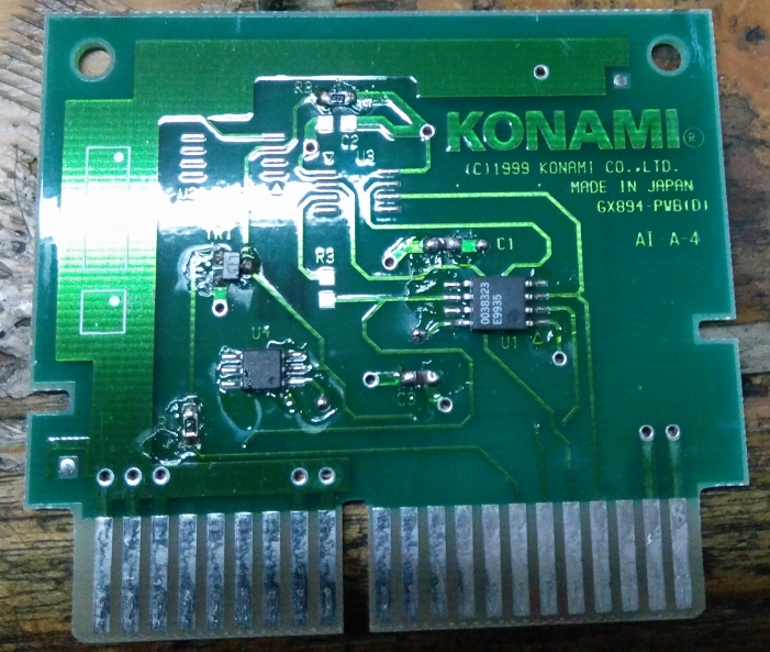

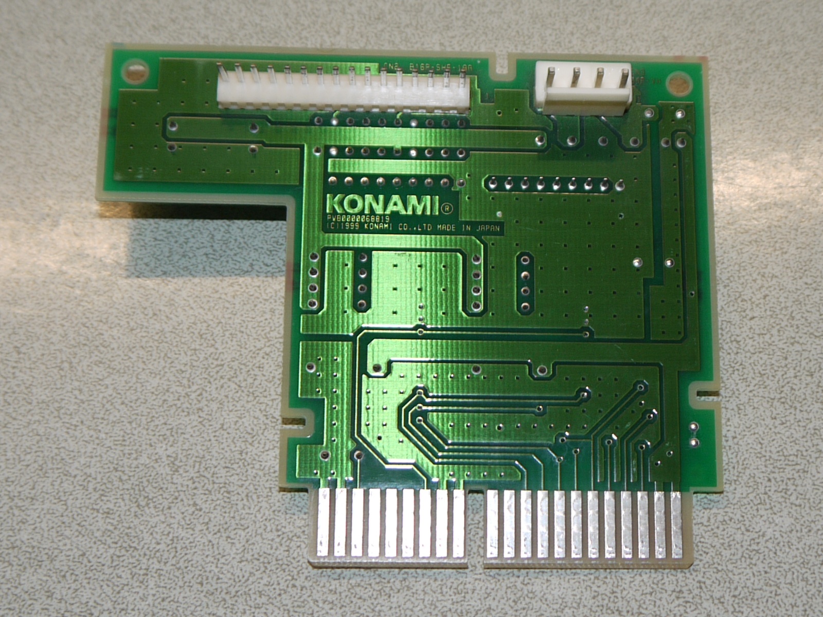

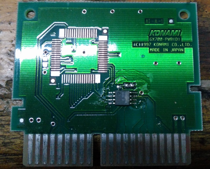

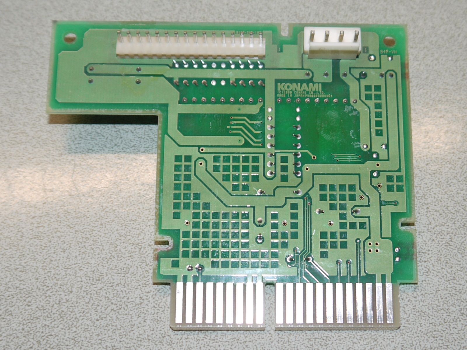

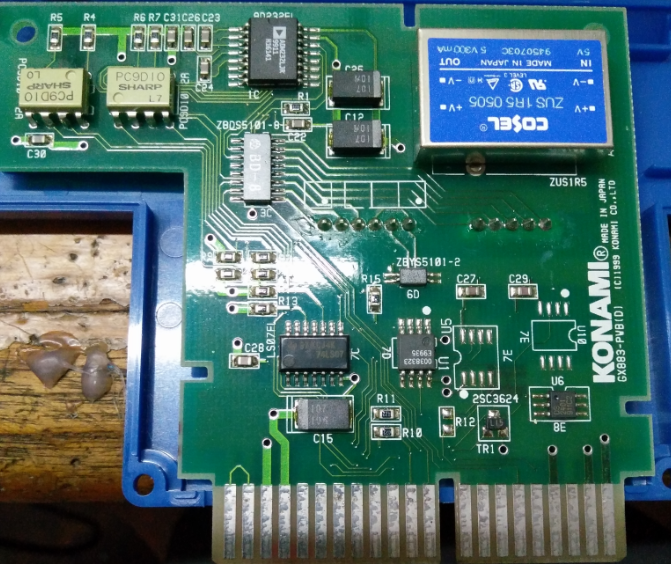

Earlier games using gx700/gx894. I haven't tested all earlier games so i don't know if the cart for operating mode and install mode is separated, but for GQ881 i tested, i don't need separate one. Begins in ddr3rd mix afaik, it used gx883. and later games used ge949 which is zs01 based cart.
clearing/mass program chip
for x76 chip, you need to know the password first. you can refer to mame keys.

so basically, there are two arduino tools here. ...
Let me see if I understand the process correctly.
First you build the Secure Chip Tool by flashing an Arduino Uno with your securechiptool code
Then you "reset" the security cart by wiring the Uno to the correct pins per your diagram and powering on the Uno.
Once the cart is cleared you build the Master Calendar Tool by flashing the Arduino Mega with your mastercalendar code and wiring it up to a RS485 adapter per your diagram
Then you "program" the security cart by connecting the RS485 adapter into the JVS port on the 573 and then powering it on with the appropriate game disc in the drive.
Is that correct or are there steps I'm missing?
When using the Master Calendar will I Need controls hooked up to handle prompts on-screen?
Can Any cart version work with any game or do you have to use the correct cart PCB for the game? So can I use a GX700 Fisherman's Bait Cart for Hyper Bishi Bashi that uses GX883?
Does this work with Discs made from MAME CHDs or will they only work with original Discs?
Thank you for releasing this tool to the public, it's a shame we weren't paying attention to this sooner!

correct.
no, you don't need controls hooked up.
But, be warned, this is not a finished tool. i still have problem programming one of the solo mix that used x76 chip. Been trying to debug with mame help, it's kind of hard. Been trying to edit mame source to accommodate jvs, i don't have enough skill.
no, not any cart. as you see, i posted above there are at least 4 kind of carts that i know of. early games used x76 cart for install and another x76 cart for game mode.
later, they used x76 for install, and zs01 cart for game mode.
and about 5th mix above, they used only one cart (zs01 cart) for both install and game mode.
you can actually find this information from ksys573.c in mame source.

Looking through Mame Source there appears to be 5 cart variants
"Cassette X" : x76f041
"Cassette XI": x76f041 with ds2401
"Cassette Y" : x76f100
"Cassette YI": x76f100 with ds2401
and
"Cassette ZI": zs01 (with ds2401)
The the games that use these carts are broken down as follows:
Game: X - x76f041
Install: none
?????? darkhleg - Dark Horse Legend
cassx ddr
cassx ddr2ml
cassx drmn
cassx fbaitbc - Fishermans Bait
cassx gchgchmp - Gachaga Champ
cassx gtrfrks
?????? gunmania - Gun Mania
?????? konam80s - Konami 80s AC
?????? powyakex - Jikkyou Powerful Pro Yakyuu EX
?????? strgchmp - Steering Champ
Game: XI - x76f041 w/ ds2401
Install: none
cassxi dsem
cassxi pnchmn - Punch Mania
cassxi pnchmn2 - Punch Mania 2
Game: Y - x76f100
Install: none
cassy hypbbc2p - Hyper Bishi Bashi Champ 2 player
cassy hyperbbc - Hyper Bishi Bashi Champ
Game: YI - x76f100 w/ ds2401
Install: YI - x76f100 w/ ds2401
cassyyi ddr3m
cassyyi ddrs2k
cassyyi dsfdcta
Install: none
cassyi ddrsolo
cassyi dsftkd
cassyi gtrfrk2m
cassyi salarymc - Salary Man Champ
?????? stepchmp - Step Champ
Game: ZI - zs01
Install: XI - x76f041 w/ ds2401
cassxzi ddr3mp
cassxzi ddr4ms
cassxzi drmn2m
cassxzi dsfdr
cassxzi gtrfrk3m
Game: ZI - zs01
Install: none
casszi ddr5m
casszi ddrusa
casszi dmx
casszi drmn4m
casszi gtrfrk5m
casszi gtrfrk7m
casszi mamboagg
?????? games are those that are not explicitly defined but rather inherit their security properties from another game. I used my best guess figuring out which cart config they used.

the naming convention, was defined by : static MACHINE_CONFIG_FRAGMENT
for example :
Code:
static MACHINE_CONFIG_FRAGMENT( cassxzi )
    MCFG_DEVICE_MODIFY( "cassette" )
    MCFG_SLOT_OPTION_ADD( "game", KONAMI573_CASSETTE_ZI )
    MCFG_SLOT_OPTION_ADD( "install", KONAMI573_CASSETTE_XI )
    MCFG_SLOT_DEFAULT_OPTION( "game" )
MACHINE_CONFIG_END
it means the game mode uses zs01 cart (which usually include ds2401, hence the 'i'), and the install mode uses x76f041 with ds2401 cart.
i think i found one wrong information on ksys573.c when i experiment with the install cart, especially the 'i' utilization. But i don't remember which game.
and as a note, when mame said x76f041, in reality, the chip itself is marked with konami's own custom chip number. but iirc, i already include a way in the arduino source, to detect which one which.
i had a bunch of 573 carts. but iirc, when i 'resets' them all, i did not find any x76f100 or the 'y'. all of them was x76f041.
