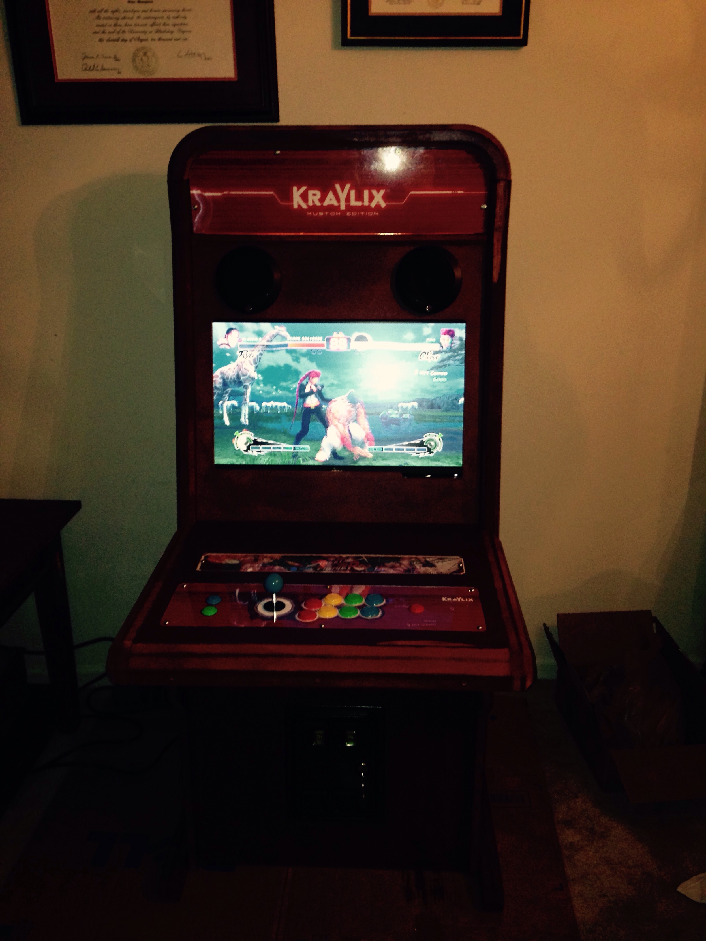

Not sure if this goes under a project but.. here it is… Kray's work is amazing.. I highly recomended Kray, he answered all my nob questions and gave me recommendations on what to use.. I received my kit on Friday and strated working on it.. I have never put anything together or painted so be gentle:)
Completed the cab today and play Street Fither 4.. very cool all is working..

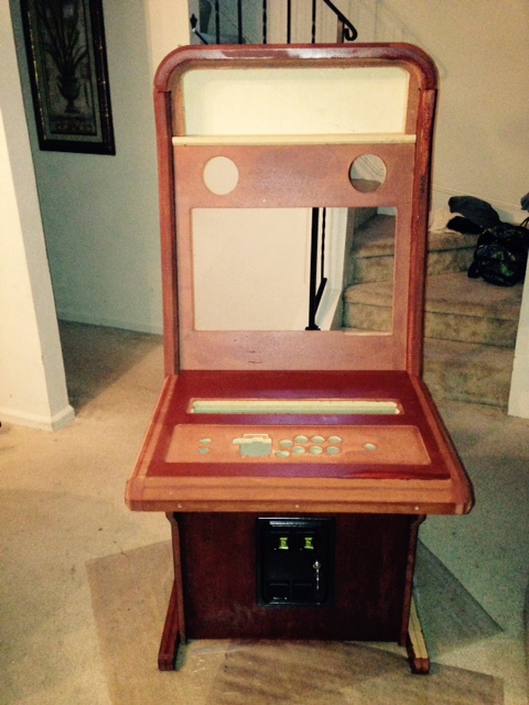

The coin door
http://www.ebay.com/itm/360127648947

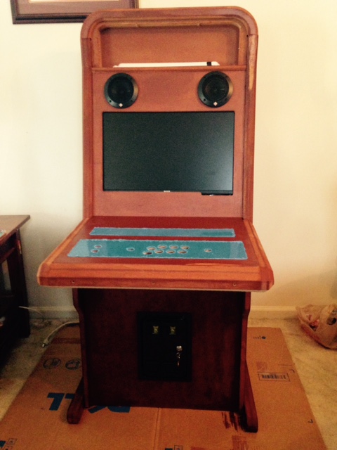

Monitor
the Shmups guys recommended DELL U2414H IPS
Used 4 M4-0.7 30mm to mount HomeDepot
Kray recommends a monitor but it is a TN panel.
Amp and speakers Kray's recommendation
http://www.amazon.com/Pyle-PCA2-2X4...sbs_267_2?ie=UTF8&refRID=01HE6R00RR0T75G60CAB
http://www.amazon.com/Rockford-Fosg...sbs_200_6?ie=UTF8&refRID=00SH8QKKSZ6RZ67KH4S4
RCA to 3.5 - to the dell U2414H and RCA to the Amp
http://www.amazon.com/Mediabridge-3...8&qid=1440252686&sr=8-1&keywords=rca+to+3.5mm

For the marquee, CP and arts Kray will give you the link. Take the file to a FedEx store for printing, mine cost $45. I used out door banner paper, the marquee does not light up as much but it does the job.
For the paint I needed something simple to use and that I could retouch in the future when it gets dirty or something happens. The only drawback about stain is that it takes a long time to dry up, over 8 hours.
Paint/stain used = minwax wood finish gunstock 231 Lowe's
Sealer = Bulls eye shellac clear transparent. Lowe's

@Stomm thank you very much for the link. At some point I will add the graphics on top like he did. The Funny thing about my slim is, that in person it looks much better than the pictures, the pictures does not do the cab justice. I am very sure that the same can be said about Donovan's cab:)
Absolutely :thumbsup: I saw a clip on Youtube a long while back of someone using Logitech speakers doing a real nice mod incorporating them into the frame/bezel. I'll see if I can dig it up again.
@Gondar.. Thank you very much.. I am very happy it turned out so cool:)
@Stoomp...thank you!
