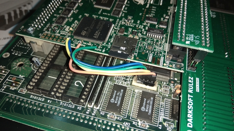

I soldered the 4 wires to the Multi and attached the dupont to CN9 (rev7 B board).

You did the upgrade before soldering the wires?
Can I see how you attached your wires?
Yeah, first I did the upgrade, then I soldered the wires.
Pic attached.

Ok, I tried with /update/flash.img and it seemed to fix the problem, but when I reconnect the wires everything becomes stuck again.
I rechecked a billion of time connections and they are ok.
What's going on?!?
SOLVED!
The trick was updating the firmware (in /update folder, not in root) with the wires connected, not disconnected!
Now it works flawlessly. :)
