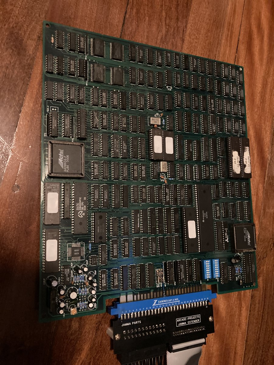

THE GOOD:

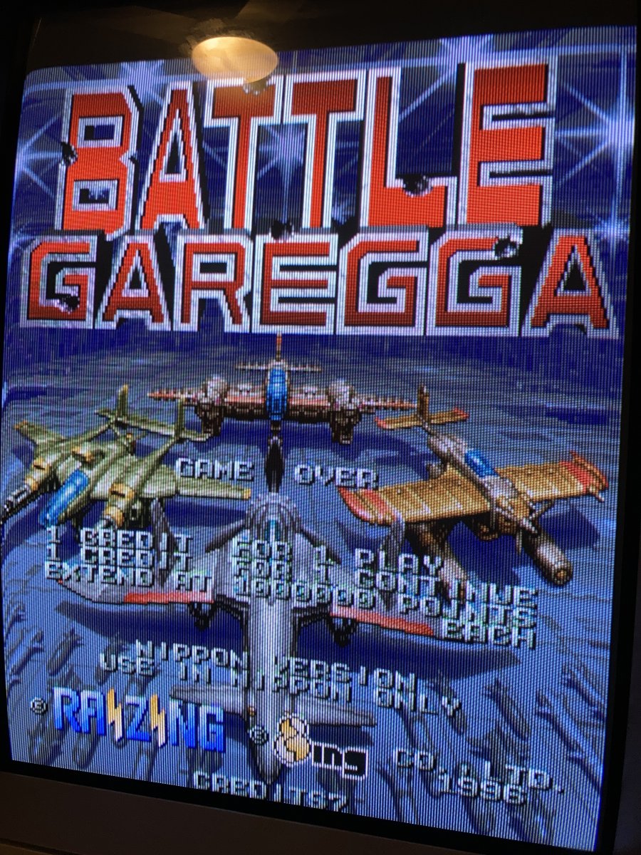

Tested with my HAS and It boots, however it only displays on my 20L2MD PVM and not on the 20M2MDA PVM. On the 20M2, image is displayed once I turn on my monitor then slowly fades out to black over about 8-10 seconds. Anyone know what that could be?

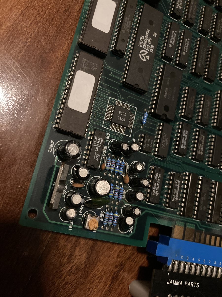

Board is fairly clean, compared to the last one which was pretty gross. There's some grotty gunky flux at the top which will need a bit of cleaning, but hey, it's a bootleg.
This board has no JAMMA notch, and came with a Yamaha Sound chip

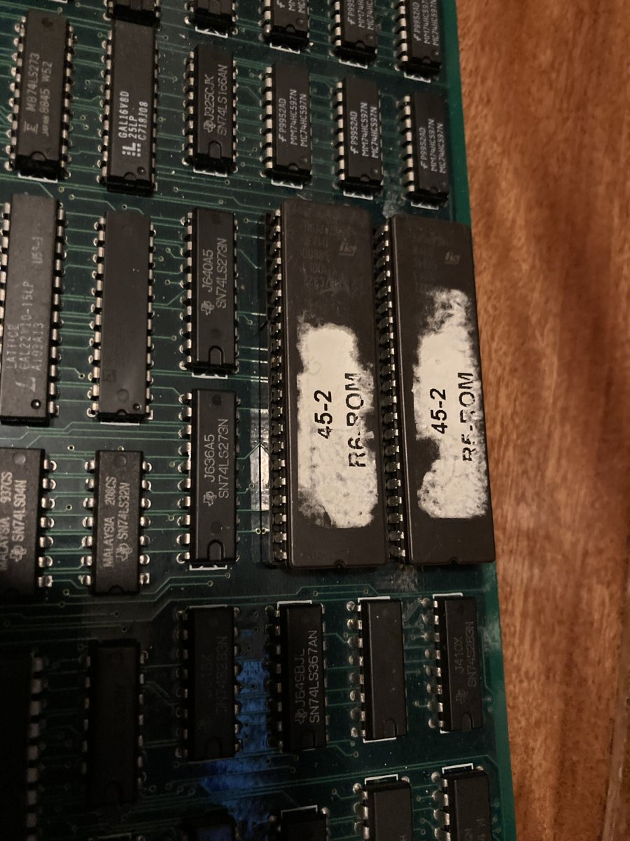

EPROM labels here might help identify what version this was:

There's no sound whatsoever (haven't tested on a cab yet), I'm assuming this is accepted as "normal" when using this board with a Supergun?

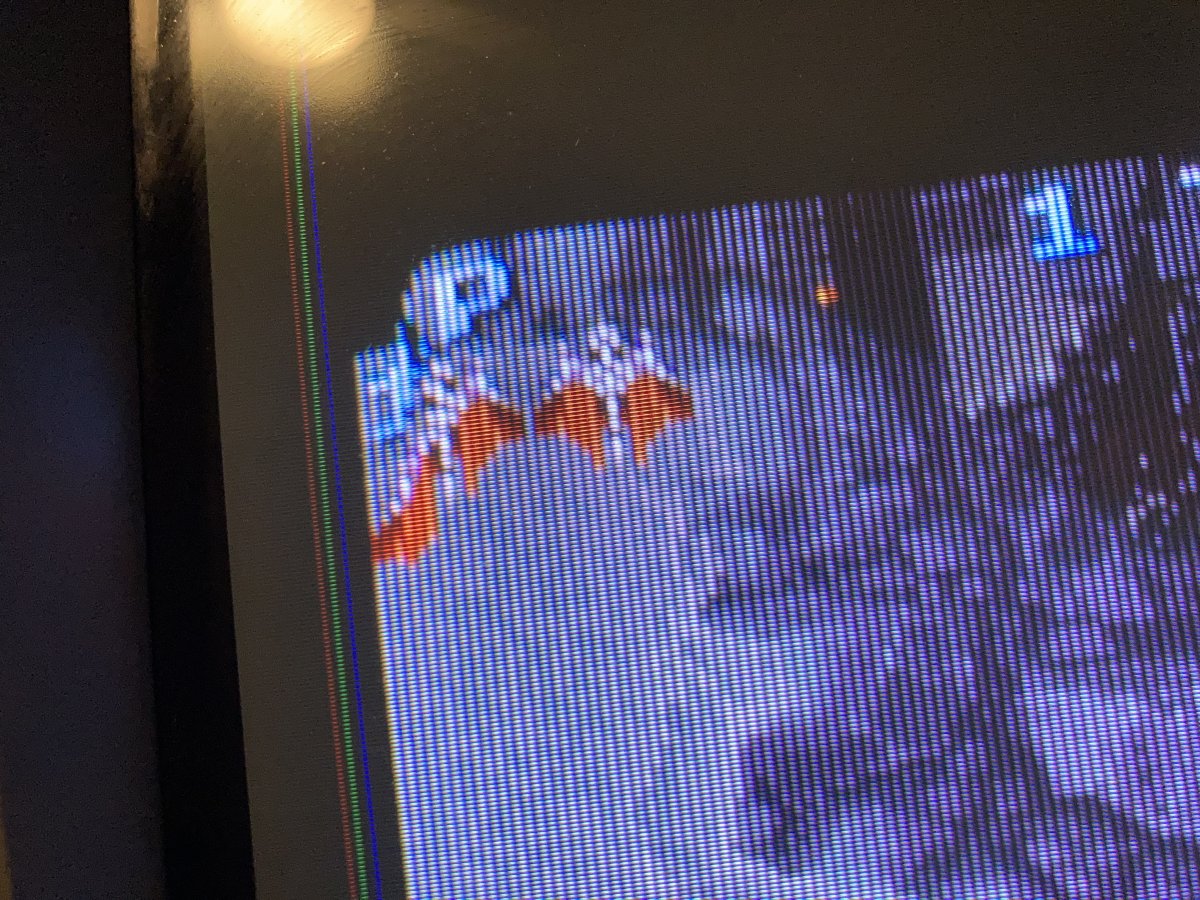

Also, I have some screen curl to the top left (in TATE) on the monitor, it seems to get worse the longer the board is left on... might be something PVM/sync related though?

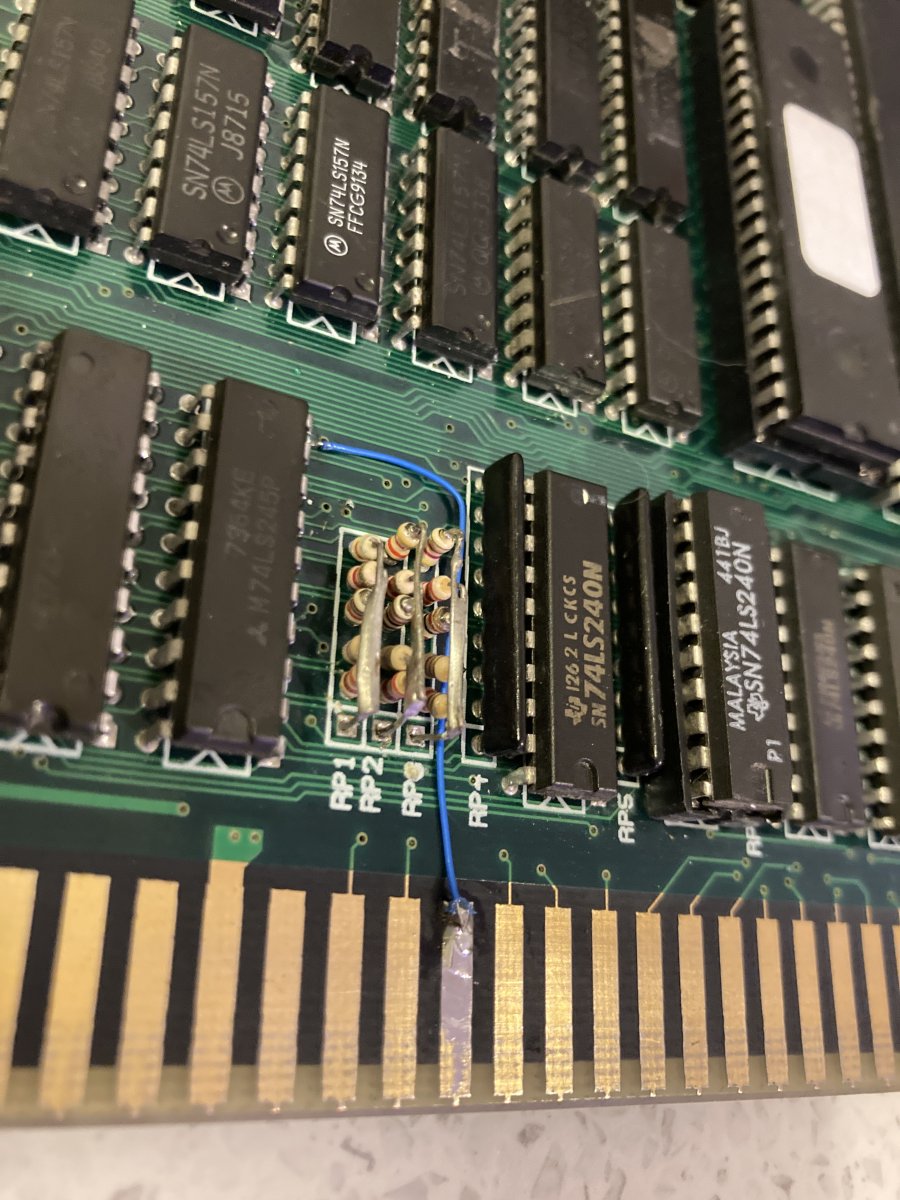

These resistor arrays need to get changed out at some point!

Have you checked if the "regenerated" CSync setting on the HAS changes anything with the screen curl?
That fixed it! And it also now works on the PVM that would “fade out” to black previously… another reason I’m glad to be using HAS now over any other Supergun, thanks!

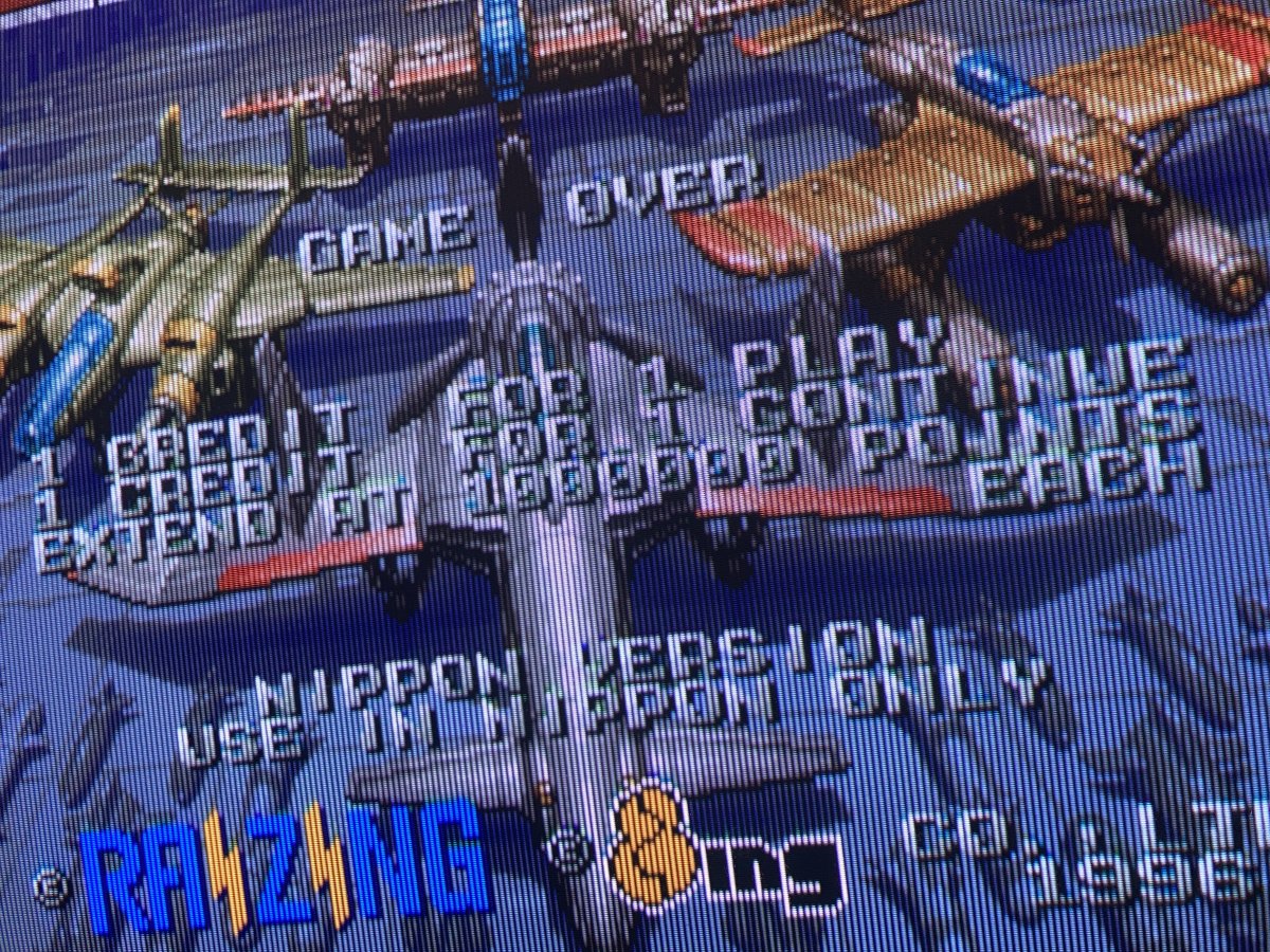

The only issue outside of the non-working audio I am facing are these green artifacts around the text on the title screen (see around the “F” and other letters in the picture below):

I just got a Garegga boot of the "first batch" / without the correct jamma edge:
as others reported, sound output is "switched" to speaker -. Conveniently speaker + and - is handled by to toggle switch on the Jammafier.
Gameplay and video seem to work correctly with this board version but the sound is "mixed" differently. Nothing like the reported humming of the second board revision.
The board has some crazy fast and glitchy address line transitions for the palette RAM. What you're seeing is a speed related issue but it's not simply fixed by using faster RAM. Socket the palette RAM and just keep trying different brands and speeds of the same time until these go away. It sounds stupid and hillbilly to fix something that way, but the board is stupid and hillbilly to begin with. Garbage in, garbage out.

I had one of these boards and I actually had to change the entire PLCC socket for one of the ACTEL chips because it was warped or the pins were worn out and making poor contact to the chip
That could be the case on mine as well. The socket looks very bad if you check my picture. Does the socket have a specific part number / name?
