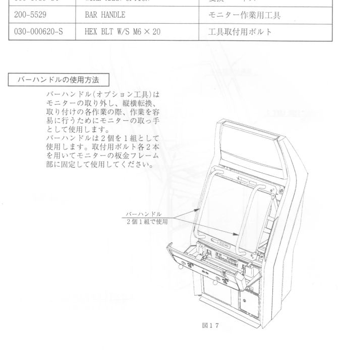

does someone make handles as all these monitors have the holes for the metal handles to go in. Makes it a lot easier if you attach the handles.
I sold a Blast City somewhat recently. The buyer then contacted later if I had the monitor handles. I was like, the what?
Sure enough, in the manual, on page 30:
I have never seen these things. They're huge. How the hell do you get them off?
Anyway, my Madonnas have small handles (that are parallel to the frame) on the MS8-25 monitors as stock. I gotta admit, they're really nice.
