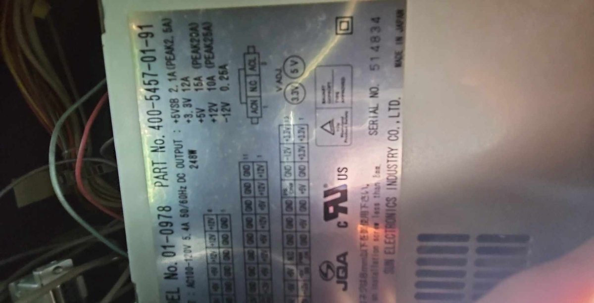

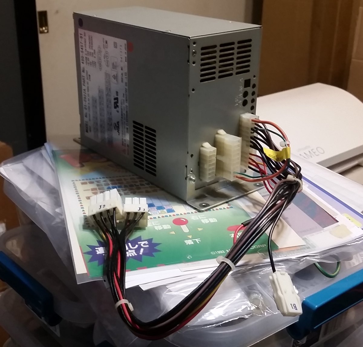

The Lindbergh power supply has 2 modes, JVS and ATX. There is a switch on the power supply that controls this. If the switch is set to ATX mode it will not power on when it is not connected to your Lindbergh motherboard. If you switch it to JVS mode it will always power on even when disconnected from your Lindbergh.
Do you know where the switch is on the power supply to change from ATX to JVS mode as i'm having the same issues and can't find the switch
Its a small square hole above 2 small round ones on the side where the Lindy mobo power cables come out.
Not my picture btw credit goes to solid-orange.
http://solid-orange.com/1593
