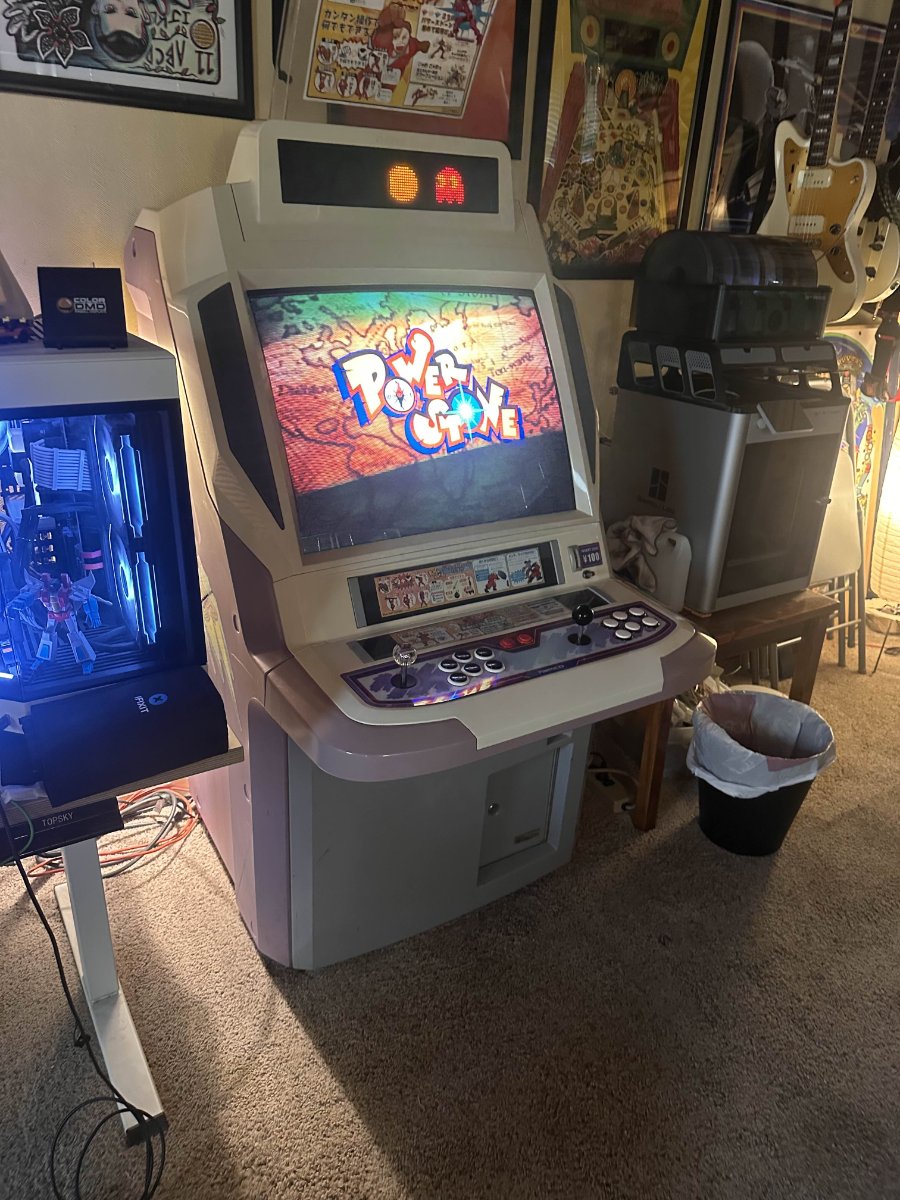

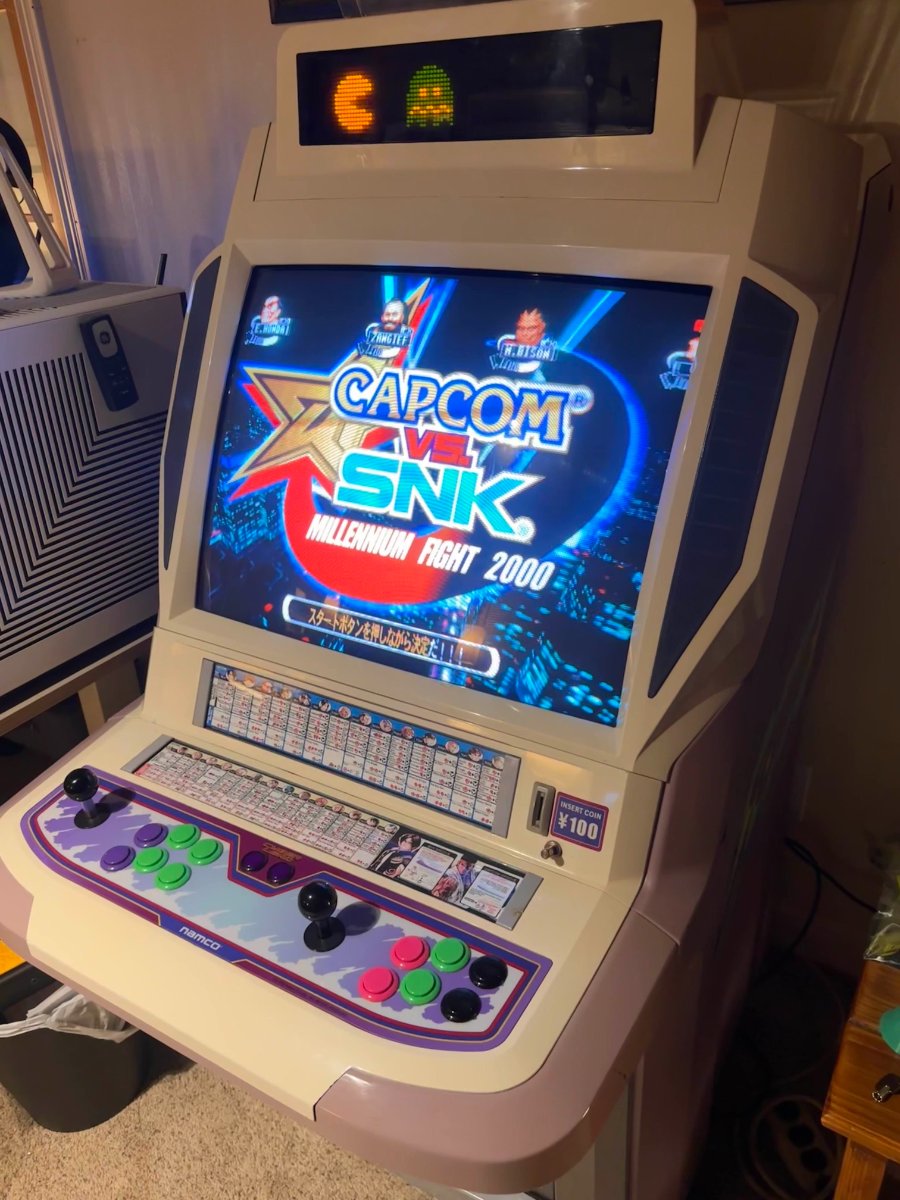

I recently picked up a very nice Namco Cyberlead from a friend, and I am looking for a bit of advice. I have been out of the arcade world for 10+ years now, mainly doing pinball. I have been wanting to pick up a candy cab again (owned an Atomiswave in the past) to play fighters on. The Cyberlead is setup for JVS/Naomi and has a working Naomi 1 system inside. I do plan to run a CF setup inside at some point. However, I would also like to be able to run either a MisterFPGA with a JVS converter or a Mistercade and maybe use a Jamma Converter. The monitor is a Nanao MS9-29ND22W, which from what I can find is a dual sync 15/24khz monitor. The Naomi games run at 15k right now.
From the limited research I have done, it seems if/when the stuff finally comes back in stock, that maybe a MisterFPGA setup with a Mister JVS Expander from Irken Labs might be the best and easiest option. I am really mainly interested in CPS2 games, but the rumblings of Mister CPS3 support is intriguing as well.
Anybody else have any experience with this kind of setup? Again, I have a lot to catch up on while I have been out of the loop, but I am excited to get back into the arcade side :) I already have Power Stone and CvS1 carts for it, so that will keep me busy until my CF stuff arrives.
