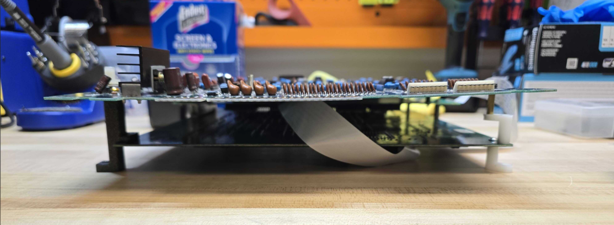

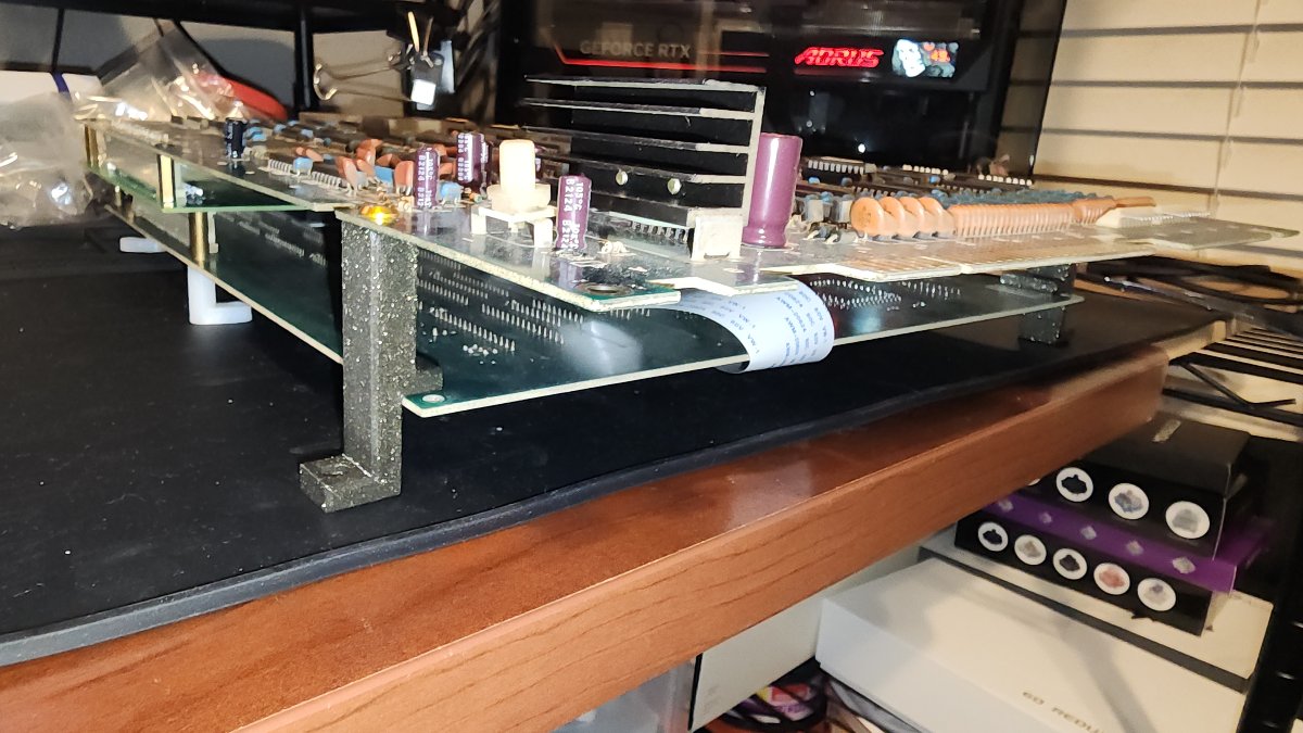

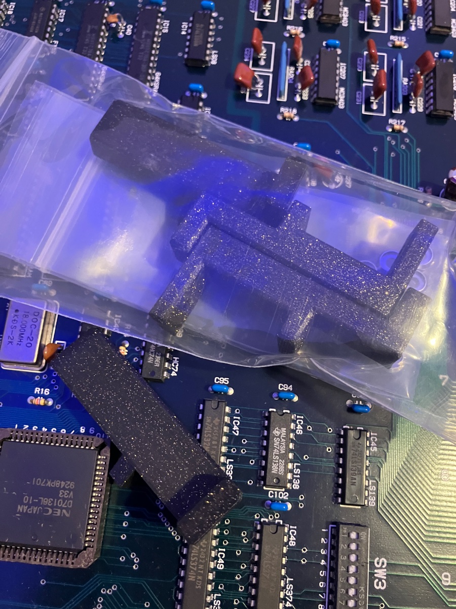

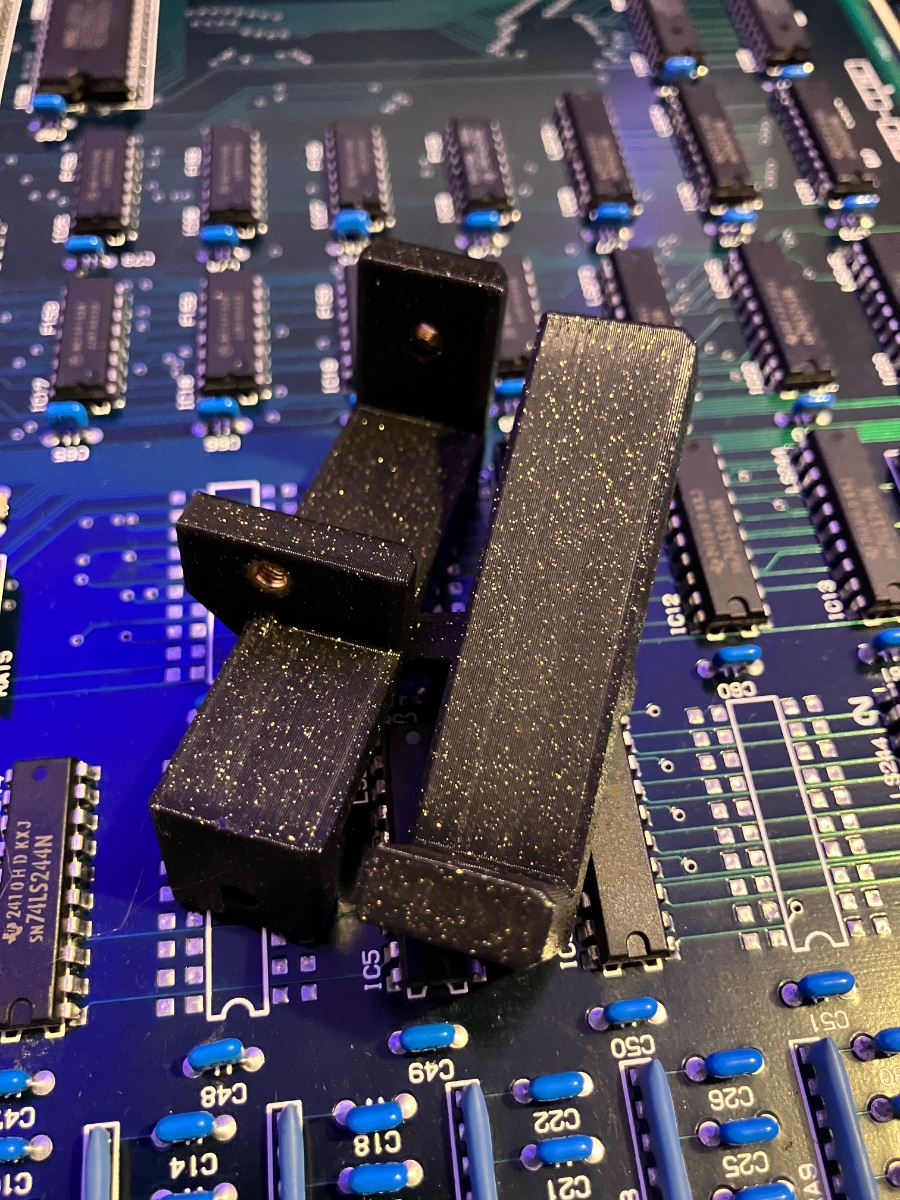

The M92 Multi (everyone should have one!) uses a spacer + PCB foot to act as a standoff stack on the front of the board. This solution is ~1.4mm taller than the rear board stack-up, causing an equivalent amount of flex on the top board.

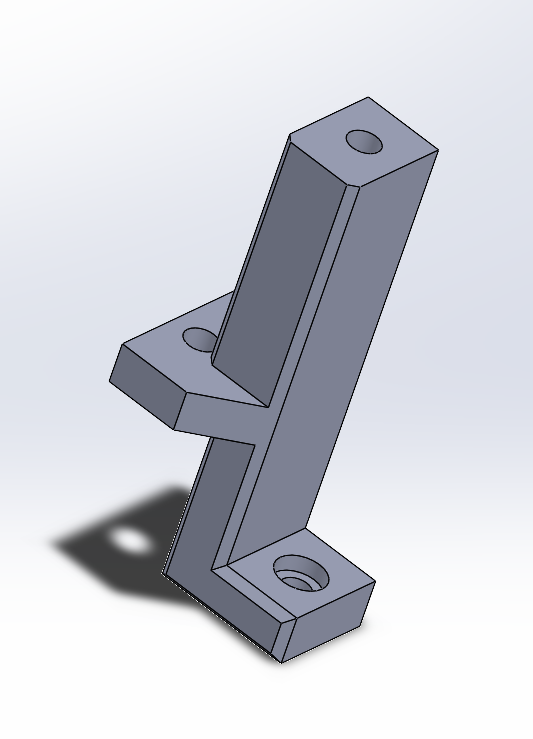

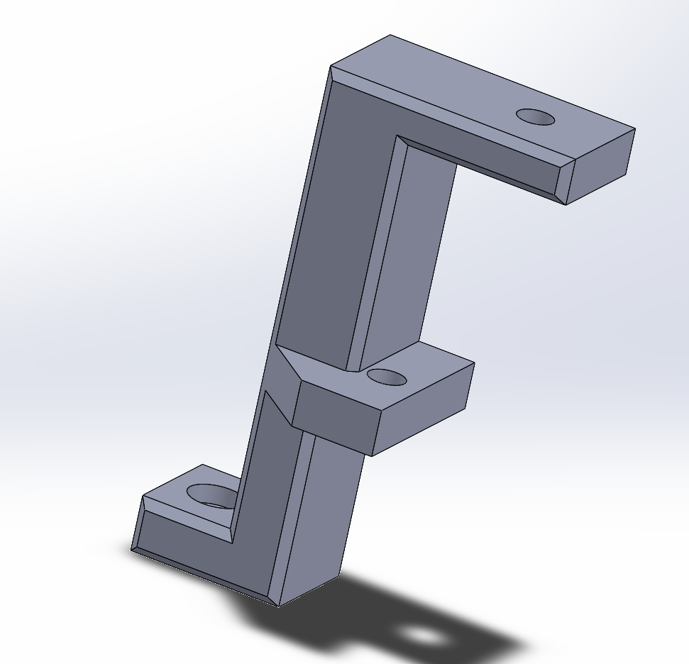

While I work on a proper enclosure for this, I did a (very) quick model of a printable spacer to remove the flex. The hole offsets were measured with a digital comparator, so location should be very accurate.
The part was designed for M3 heat set inserts, but you could also use a longer bolt + nut.
I included STEP files so that adjustments can be made in the event that other people are using different length standoffs, or any other number of variations that could exist. I think the model as-is will cover most people.
If anyone who needs one does not have access to a 3D printer, post here -- I can probably help.

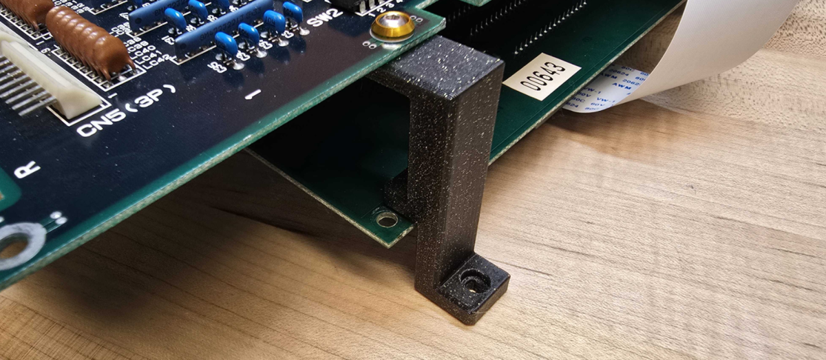

Right:

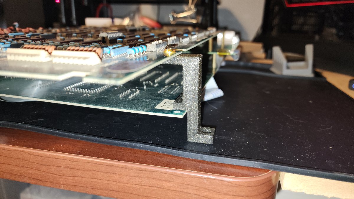

Left:
Here you can see the difference in height + flex (slightly exaggerated as my board had some flex already) when only swapping one bracket:
Thanks a lot for sharing! - On your photo is the upper pcb bend or is it just the camera lens?

You're welcome! If you're talking about the bottom photo, it's two fold: I only installed one mounting bracket (left) to illustrate the height difference and just how much it bends. I edited the post to better clarify. There will be no bend when you install both brackets.

@plasticfactory and @Mitsurugi-w please correct me if I'm wrong: original M92 spacers are 17mm and PCB thickness is 1.6mm, so to me we need 17 + 17 + 1.6 = 35.6mm spacers at the front.
I believe the PCB feet that come with the kit are 20mm, giving 37mm total when coupled with the original spacers, or 1.4mm flexing over 20cm, doesn't look to be much to me (I have PCBs with feet sagging 5mm in the middle).
But definitely your solution @plasticfactory is nice.
@Ape Cosplay Yup, that's correct. When I was typing this up I erroneously added the PCB thickness to the front spacer, so the flex is actually only 1.4mm, as you said.
I don't think the setup as-is will cause any real harm, but I'd definitely prefer everything be equal height.
Got a couple of sets of these and installed them on my multis. I have to say the increased stability is instantly noticeable. This is *essential* for everyone getting a M92 multi — the included PCB feet/spacer solution “works” but shouldn’t be considered for the long term when this exists IMO.
Thanks @plasticfactory for looking out for the community and making these little niche QOL improvement pieces! Get your 3D print on!
