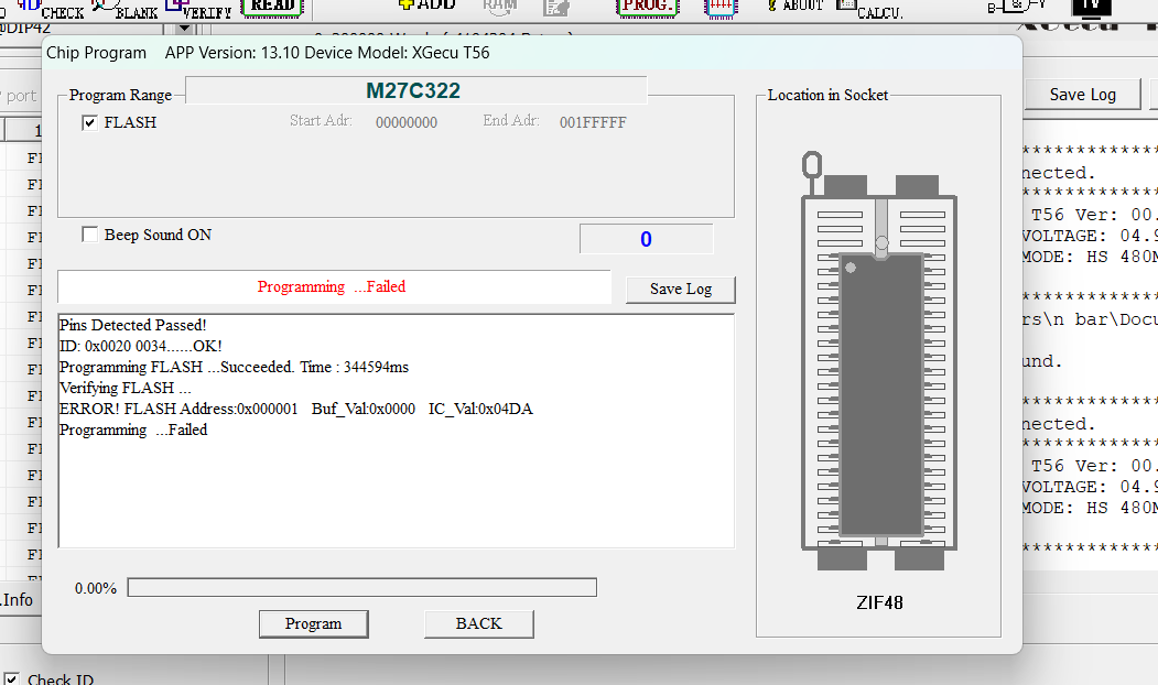

Did anyone manage to programme their M27C322 EPROMs with a T56 ?
I keep getting the below error

If some one could advise on programming the M27C322 using a T56 that would be awesome, as that has to be the likely culprit.

Bump the programming voltage up.
Should work unless it's a bad eprom. Finicky thing.
