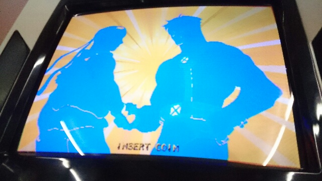

Main characters' indication is wrong.--SOLVED (post 11)

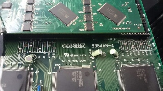

I installed my CPS2 multi kit in a suicided jap Vampire saver B-board (revision 4).
I think it's without mistakes. I want you to tell me how to do. Please help. Please

Did you verify all the jumpers with a multimeter?
Also, is there already a jumper wire soldered on the bottom of your B-board?

That jumper on the bottom is meant for a G pal. What happens if you insert the PAL without removing the pin or soldering the wire to the PAL on top?

Remove the bottom wire and just use a wire between the pal and J17. Its definitely some sort of B-board issue.

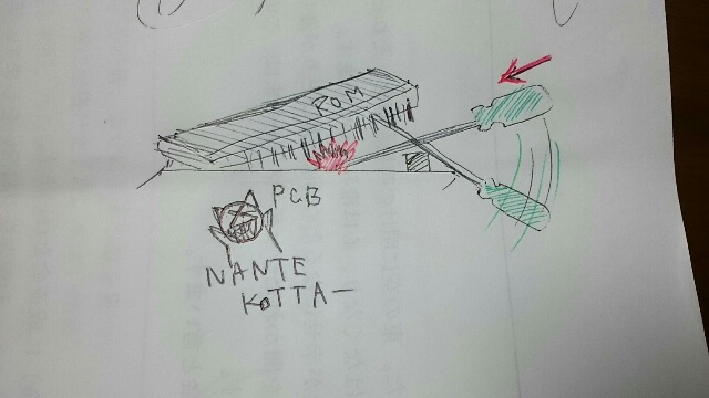

And I found it
I spent very worthless time
When I removed ROM, the cause was the mistake that I committed
Thank you for advice!
He blew the trace with the screwdriver while removing the orignal mask roms... Ouch...
