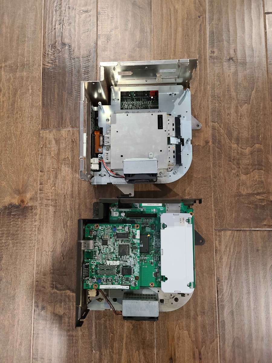

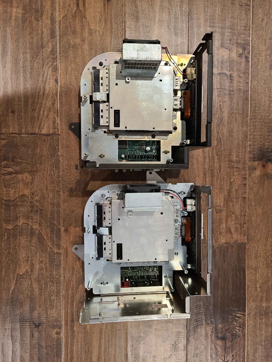

got the type 1 converted to a type 3, will test it tomorrow since i have to meet someone by the arcade tomorrow to grab their crt to try and fix it, also if this does fix it, im going to swap the gamecube boards and see if that gets it working or if its something else
okay update, game will still not boot, tried removing the game cart and got nothing, removed the board with the serial port and it would try to boot, i would get a green screen, i removed all of the top boards hoping to get a message about them being missing but i get nothing, sometimes some green screen flashes but thats it
