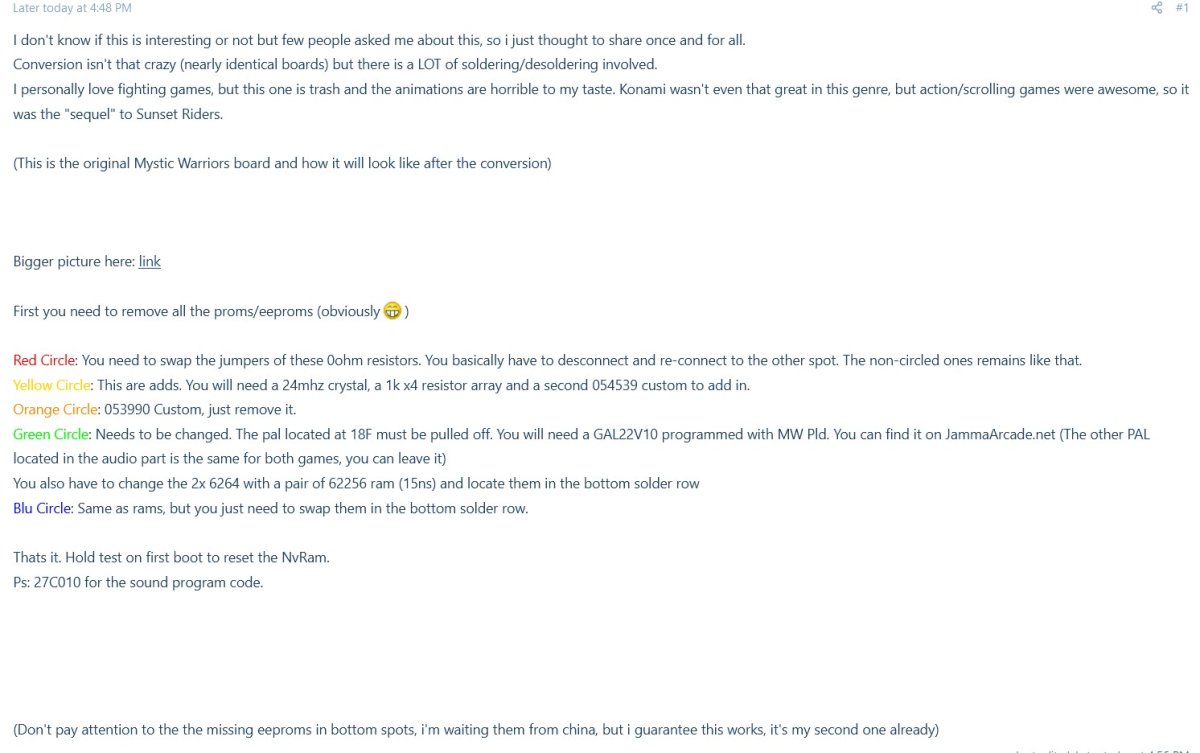

So I reposted it.
I don't want to take credit for what isn't mine. This is the original post found through the wayback machine, screenshotted and posted here again.And thanks for doing so, your post is great and I think covers all the major points.

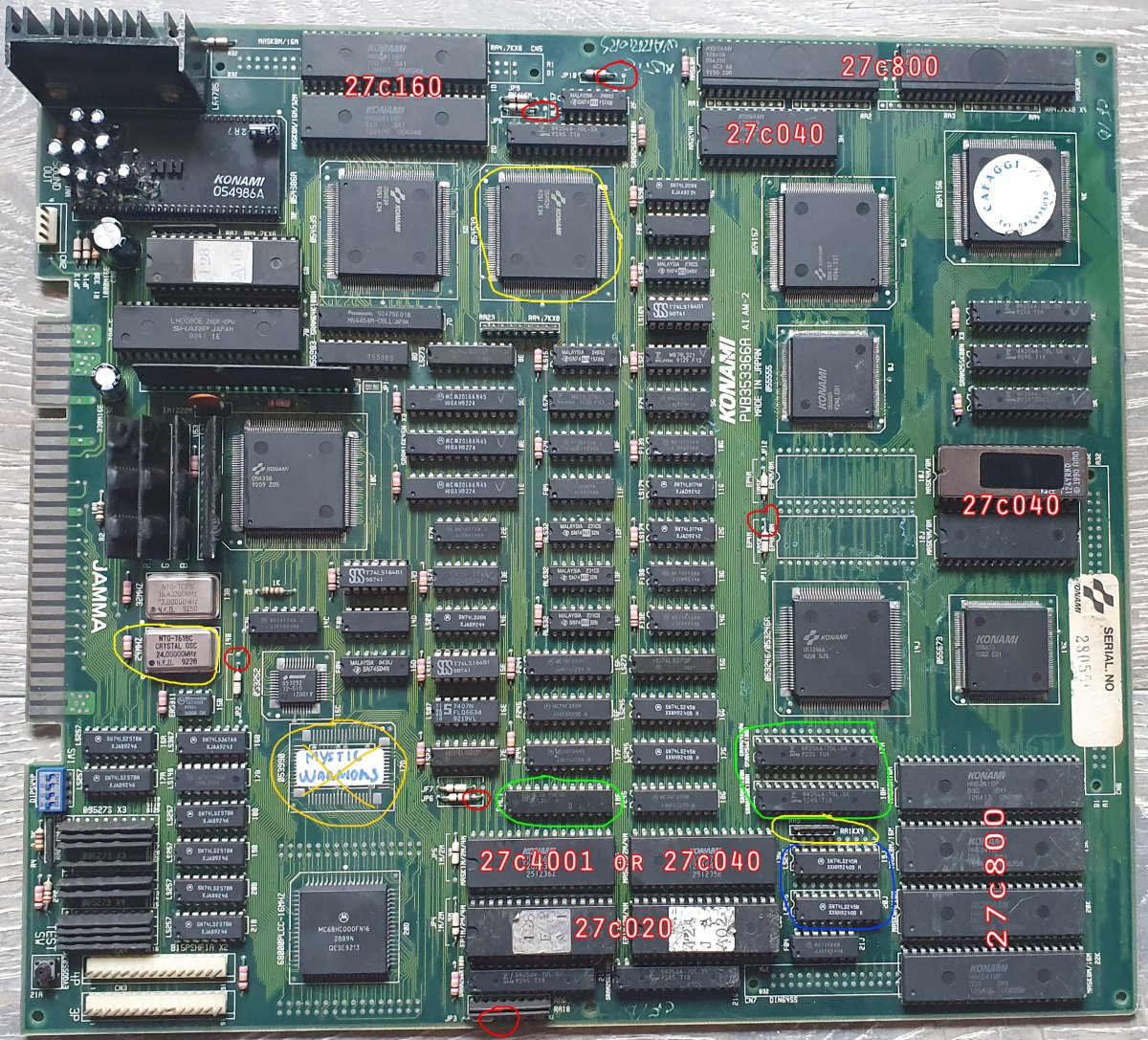

Out of curiosity, do you happen to know what value the resistor array is that has to be added?Here's some pictures to help you out per your request:
Me? No, no idea. I had this made and the creator did an excellent job as far as the board goes, but I didn't ask him technical questions.Out of curiosity, do you happen to know what value the resistor array is that has to be added?
I've never understood how resistor arrays are sold/labeled/etc, so probably not, ha. But not because you aren't helpful, more because I don't know what I'm looking at. I've only had to replace one once and I just had a parts board and pulled it.Can I answer your question by looking at it or getting better pictures?
there is a standard label scheme for resistor arrays, unfortunately a lot of resistor arrays on arcacde boards are actually custom arrangement of resistor and capacitors and don't have generic counterparts (and likewise also don't fit the naming convention)I've never understood how resistor arrays are sold/labeled/etc, so probably not, ha. But not because you aren't helpful, more because I don't know what I'm looking at. I've only had to replace one once and I just had a parts board and pulled it.
I have the page saved in my PC. When I have access to it I'll tell you the array you need.Out of curiosity, do you happen to know what value the resistor array is that has to be added?
Thank you so much!@rewrite It's a A102J 5pin 1KOhm resistor array
That definitely explains why sometimes I can't figure out what I'm looking at, ha. Thanks!there is a standard label scheme for resistor arrays, unfortunately a lot of resistor arrays on arcacde boards are actually custom arrangement of resistor and capacitors and don't have generic counterparts (and likewise also don't fit the naming convention)
