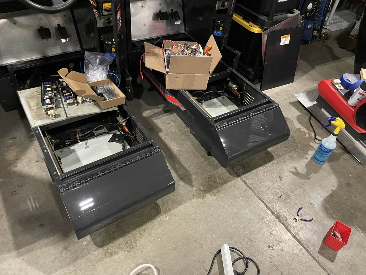

Ripped out the step-down transformer and all the power supplies and found some more funny operator hackjobs. Yep, power supply held in place with hot glue.
Found the missing filter cap, was wondering where that went haha

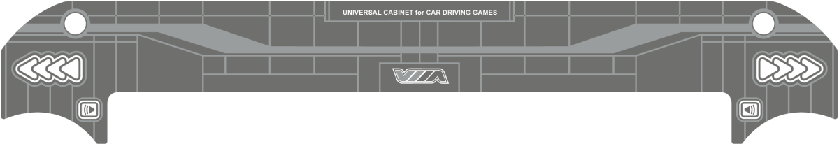

Working on fixing up the horrible paint "touch ups". The paint on the China cabs are like one shade darker than the JP ones, but it looks fine in real life. Certainly better than before. I also applied PPF so they don't get scratched up when we move them around.
And finished up scanning and retouching the faded marquee. I will release the full size after I get some printed for myself.

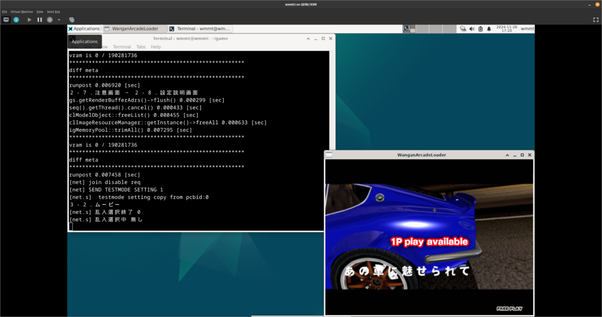

My buddy is working on packaging up something, he's a lot more familiar with linux systems than me. The Chinese cabs don't have matching drives, so we need something otherwise the games can't link. He definitely owes me some favors. :)
Proof of concept in a Debian 12 VM... Just waiting on some hardware to test with.

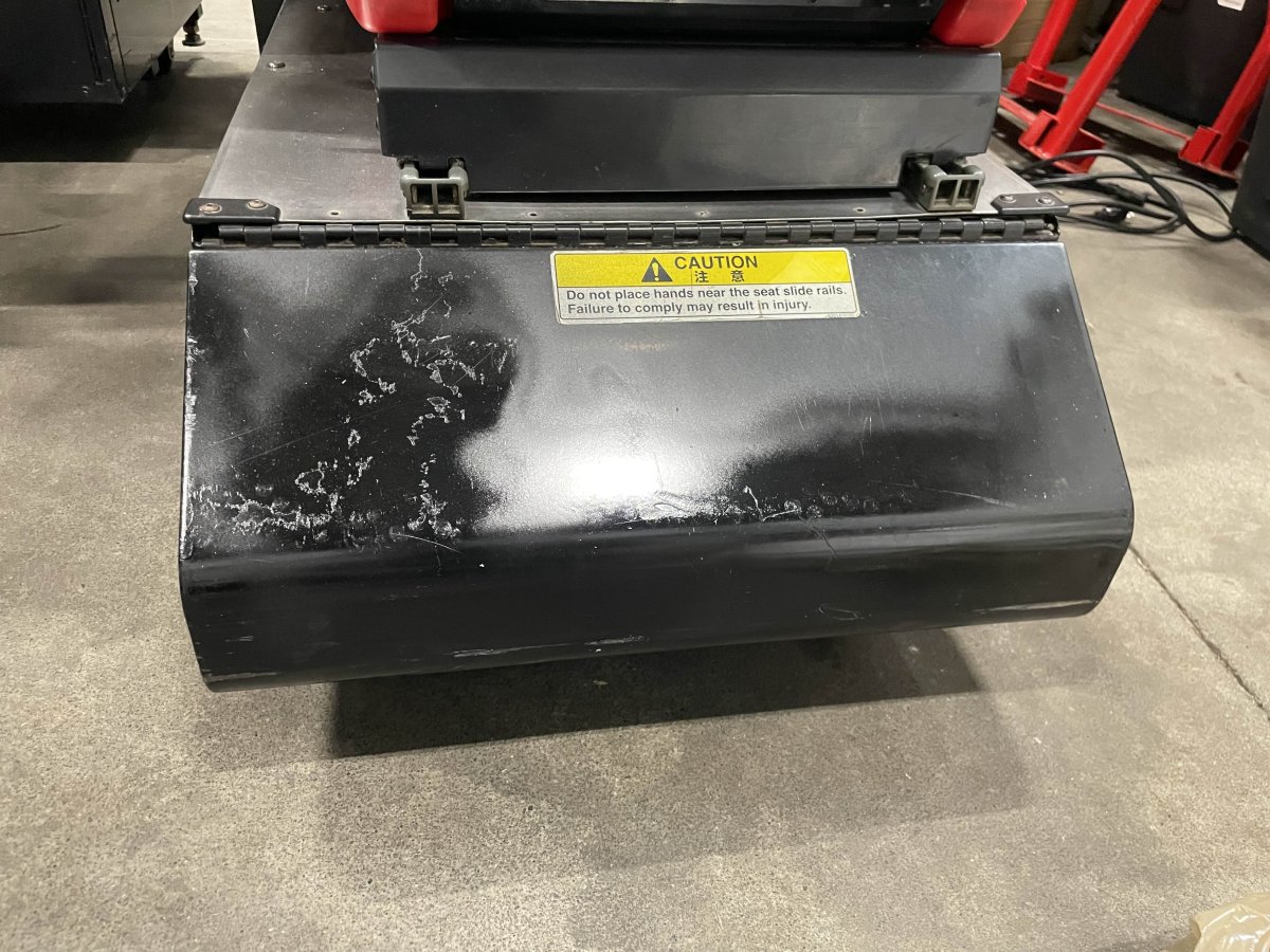

Finally finished up all the stainless. Not perfect but it's a huge improvement. The pedals themselves were quite rusty, since they're a mild steel with a chrome plating which has worn away. I did the best I could to clean them up, but eventually they will rust again. Maybe at some point I'll get them re-plated.
The rubber seat rail protectors were totally missing, so I cut some new ones.

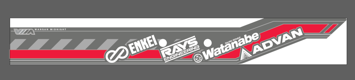

Still working on decals--just sent off a big batch of stuff to print. The Chinese cabinets don't have the wheel manufacturer sponsors on the bottom, and it was bothering me.

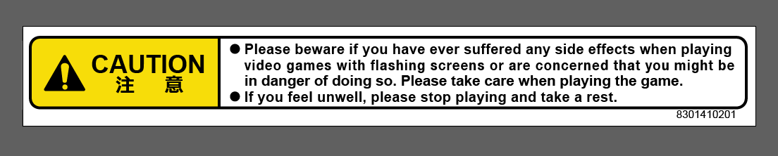

I received the prints for the seat base stickers--they turned out great, and the gray matches the originals almost exactly. Looks way better than the boring version without the sponsors.

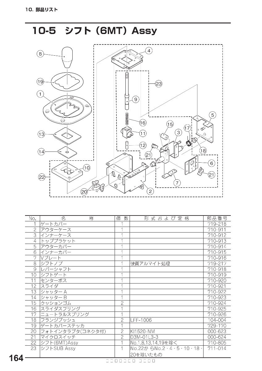

My shifter collection needs some attention. I need to refurbish two shifters for the two new cabs, and at least one spare to have on hand in case something breaks.
Everything in the ultrasonic cleaner.

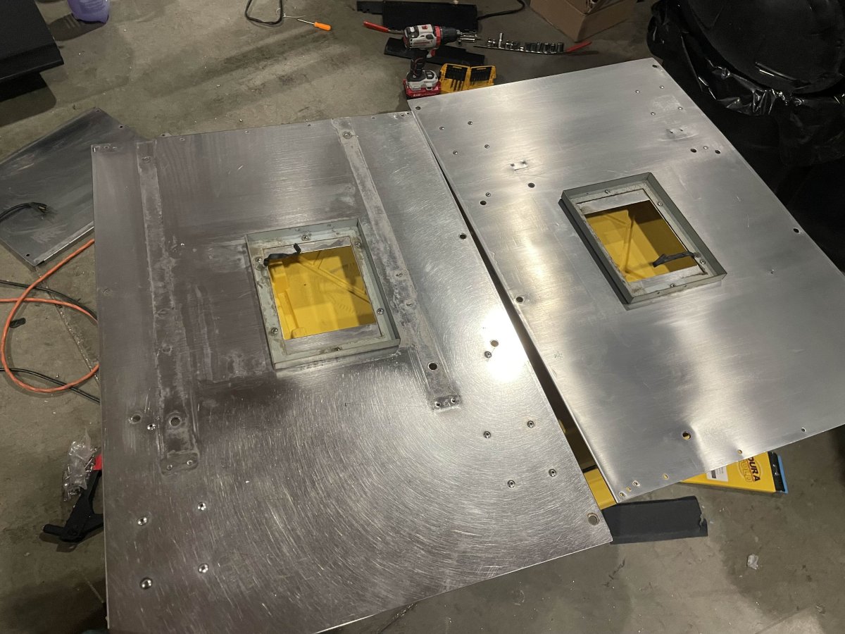

The top plates were very rusted, so they get soaked in evaporust and coated with the zinc spray for some protection.
There are a few wear parts in these shifters which contribute to slop:
-There is a delrin tip on the bottom of the chrome shaft, which is spring loaded and presses into a metal notch to create feedback. This delrin tip wears away over time as you can see above. New ones can be purchased from China for about $1.50 each.
-The metal notch plate wears down over time. Above you can see a VERY worn plate that's spent 20 years in a harsh environment. I have not found replacements for this yet.
-The delrin pivot in the middle wears down and creates a groove due to metal-on-plastic contact. These can also be sourced from China for cheap.

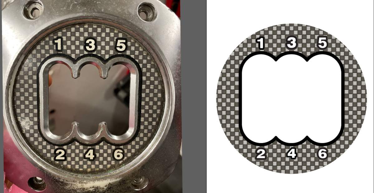

-The top gate wears away around the corners. This is not as big of a problem, but it does widen the gate openings creating some slop in 1-2 and 5-6 gears. These can also be sourced from China for cheap.
Something else I noticed is these shifters have quite a bit of front to back play in the left-right pivot, so adding a 10MM washer and grease significantly reduces this.
