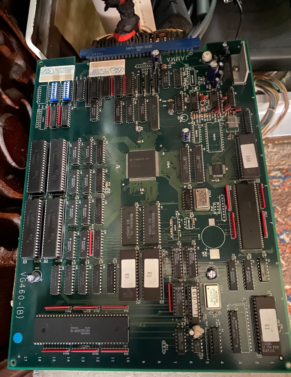

Just two two ROMs near the 8 and 9 silkscreen, those are the program ROMs
E2 and E3 are the program ROMs, if there's a difference that's where it will be.
it can't hurt checking the other ROMs but there's a high probably that they're the same.
These are the files E2 & E3 from the Lady Killer VG460-(B) . Let me know if is something need to check :happy:
