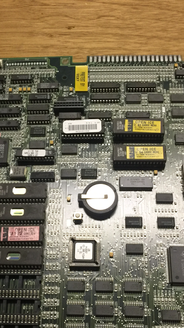

The only way to know for sure is installing those missing components I guess.
Just ordered some MK41T56N from aliex. I'll let you know the outcome...
Installed it, along with the RTC crystal. Nothing changed. Same errors. Installing it has absolutely no positive or negative effect.
Either;
a) Additional components needed.
b) The MK41T56N from aliex is a dud
...and I have 4 rows of roms and ... nothing :thumbsup: at U55 ! so looks like I'll try and do Maximum Hang time in there or possibly UMK3 ... or a multi ! :evil:

at least some work but man ... lots of roms of that stuff!!
hopefully the third erase will work!
If you're using one of those plastic cheap china uv erasers, put 2 chips max in the top right corner of the drawer and set for 15 minutes
it's an eraser that I bought with the GQ-4X4 ...
6 chips left on 26 ... almost there ! man I will NOT be swapping games often!!
Much easier to buy many blank roms ;)
Also if not mentioned for eproms you can clean the rom window with iso alcohol and a cotton swab before UV erasing.
the chips need to be up against the glass and away from the tube ends.
also, i dont know how long your doing it but i erase for 20min's+
thanks guys ... I'm using goo gone to clean the windows and yeah .. the roms were cheap but needed erasing.
doing 30 min now and much better results but one or two still giving me the finger...:D
