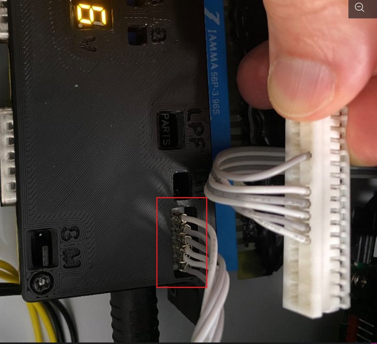

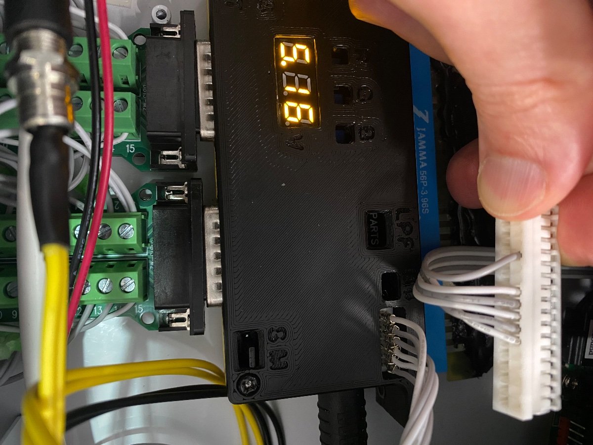

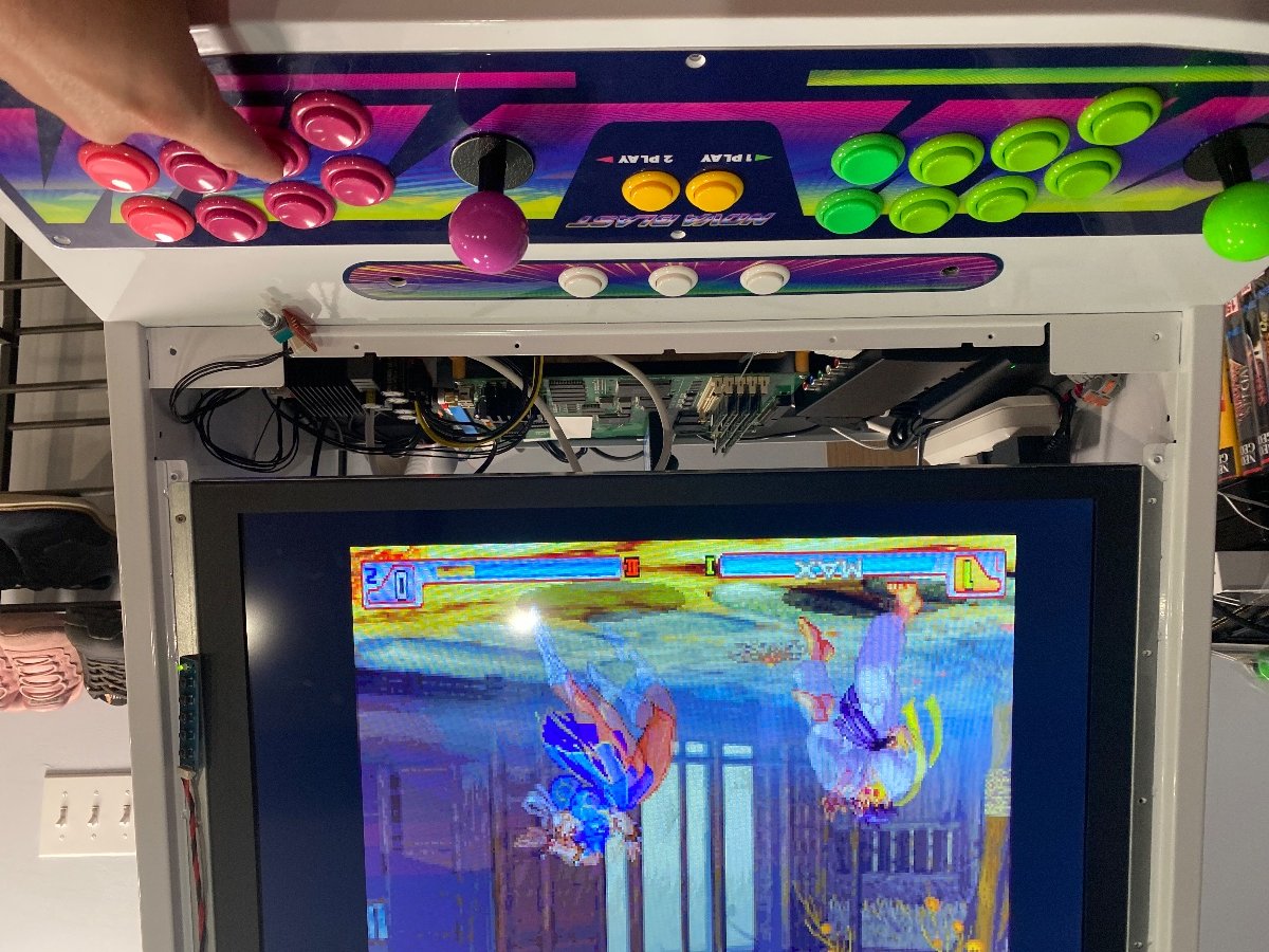

Hi All,
Thanks for reading. I recently wired a DB15 connector for my player 2 slot on my mini gun. For ease of testing while wiring I had used player 1 slot on my candy cab. Everything check out. Once I connected both player 1 and 2 db15 connections I noticed something odd. While player 1 works as expected player 2 buttons 4 and 6 do not seem to work. Button 5 seems tied to player 1 button 5. If I connect either my SSFIIX or SF3S I observe the same results. If I setup a player 1 vs 2 match pressing button 4 on either side results in both character throwing out their medium kick. My guess is it has to do with my kick harness wiring but wanted to ask if anyone has seen this before. Photos of my kick harness wire below and photo of the issue.

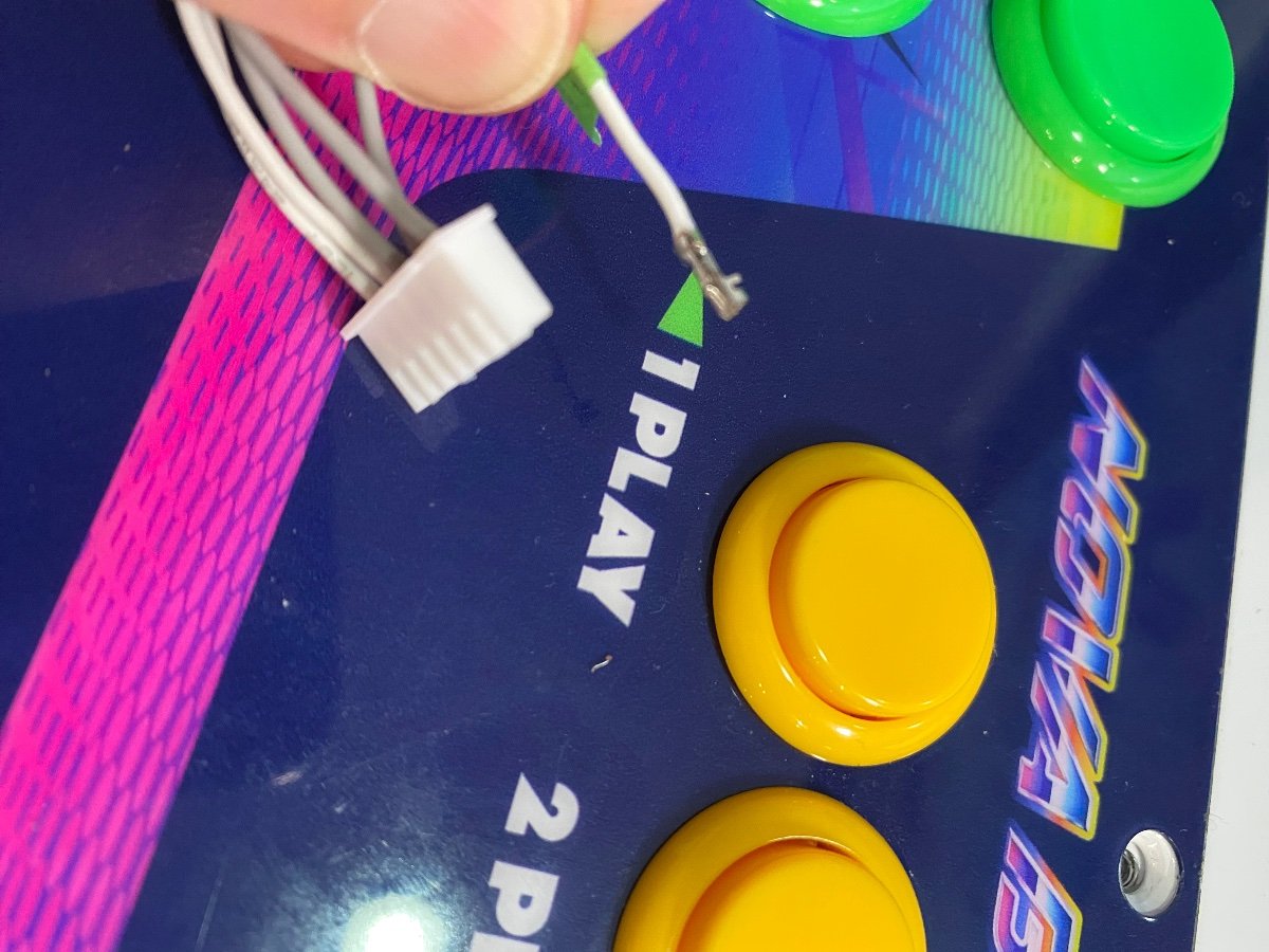

Ended up cutting back and crimping 2.54mm JST-XH tips and using a new 6 slot sleeve and we are golden! Thank you for point this out @msamiullah
