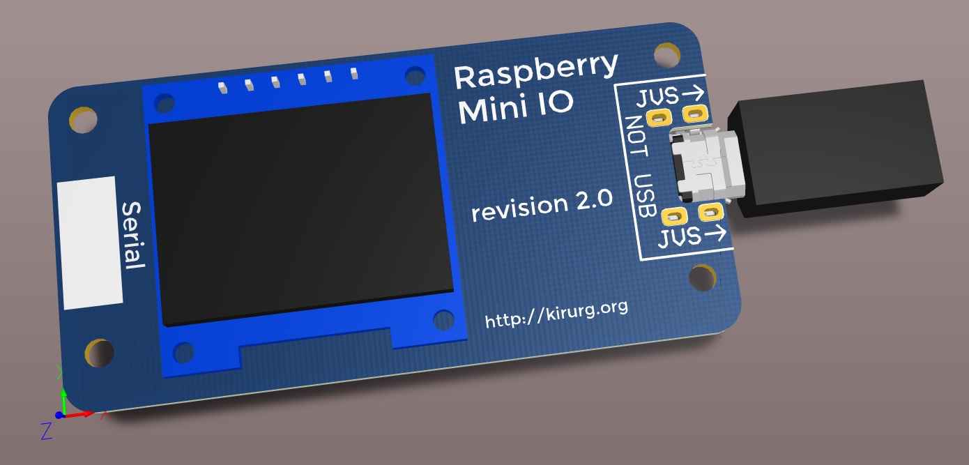

This was just supposed to be an easy side project, but got a little more involved than anticipated, as I initially thought just a couple of profiles would be needed - but there is a need for pr game config. Because of this, a PCB redesign was needed and I think you will like the result :)
Waiting for parts and stuff, so a new proto in a few weeks and I hope to have something shipping before christmas.
As for guns, I don't have the hardware and I'm not sure if any of them actually work under linux. Driving wheels are ok, but force feedback probably no as it would need additional hardware to get the signals off the specific PCB's (not JVS).
This is probably stupid and premature, but I'll give you a peek for lack of updates :)
There will not be any boards before Christmas. Been spending most of my available hobby time on the upscaler thingy, and will be abroad for a month around christmas. I have however ordered parts for a batch of the mini-io, so I'm confident it will happen later.

First goal is to get hardware I like, I just ordered a few rev2 boards which should be here in about a week.
Second goal is to mix the software parts togheter into a single user friendly linux image - and if it turns out nice, I'll have some more boards made.
The rev 2 features a small OLED, as the pr. game stuff was just too complicated to manage without a proper user interface. I have also trimmed stuff away, no additional headers, no power connector and apart from the OLED module - all components are SMD which should make for easy assembly.
I have a similar type of display in my board. Are you doing anything to support the corners on the bottom edge or do you consider the through hole header on the top edge to be sufficient support?
Baby steps.. Pretty pleased with the hardware so far, even if the SMD female headers melted in the oven at 210C :)

Any initial thoughts on what USB devices will work with it? I believe the goal is to have some form of USB gun and steering wheel to be compatible with it and to be used with any JVS setup correct?
