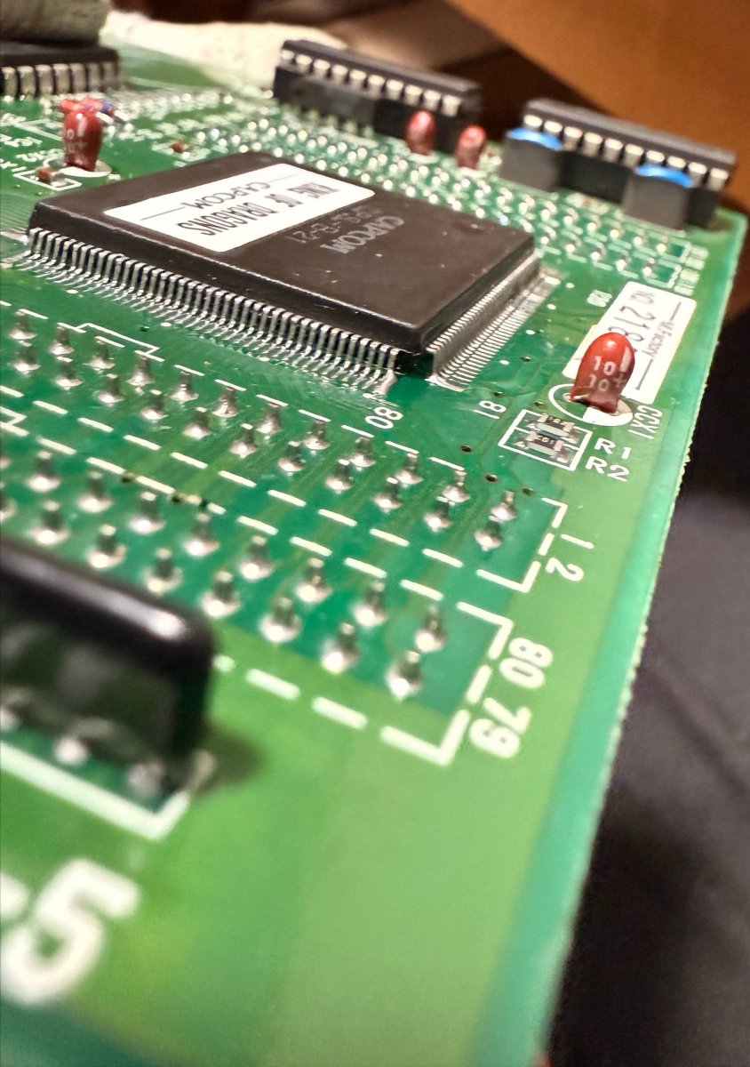

- cleaning contacts
- re-flown B chip pins from 1 to 80 and cleaning
- visual inspection -> traces looks good

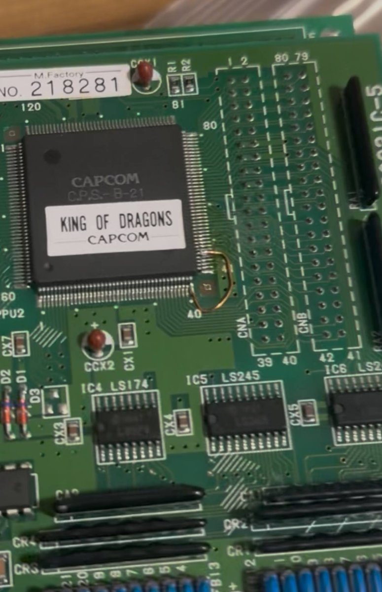

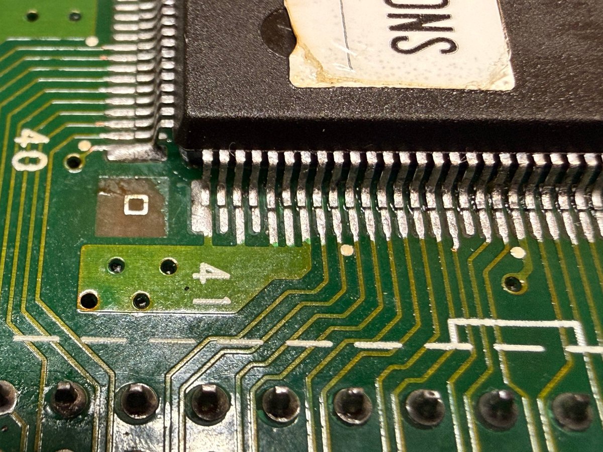

btw, this C board has been previously modified to allow non decrypted games but I reverted the modification. I don't know if the problem was present before.
A pic after reverting the modification but before reflowing

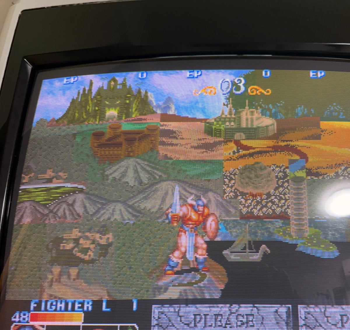

The symptoms.
