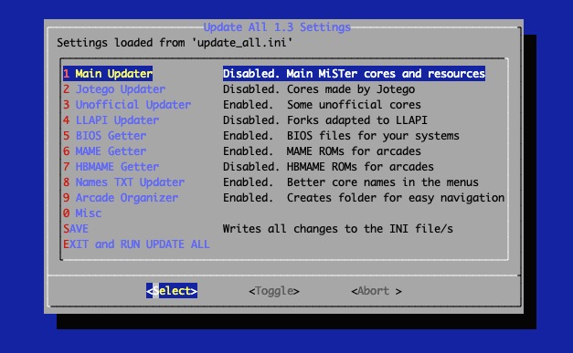

Question, if I want to use them update_all script, do I have to wait for the script to be updated? I see some people are having issues with ROM sets.
If you have option 2 enabled and ran the mame updater then yes, probably have to wait..
@digitron I wonder if I have to enable the “beta” cores? This whole zip file “key” thing Jotego has got going on is fairly confusing tbh.
I'm catching up too brutha, been out of the mister game for a minute. Check this out - https://misterfpga.org/viewtopic.php?t=2757#p27621
Though this would apply to the beta peeps.. I'm guessing once the core is public and added to the update all script you shouldn't have to do anything.
Heads up, it seems that even though the core is “public”, it’s still in “beta”. So you have to enable downloading of beta cores in the “update_all” script options which also downloads all the stuff behind the Jotego paywall/DRM key thingy… But them’s the breaks.
