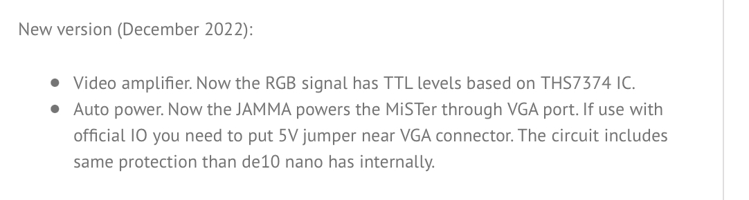

Ah he even fixed the power I see now too. I had an older one that worked well on a normal 15khz cab but wouldn’t power it through the jamma
