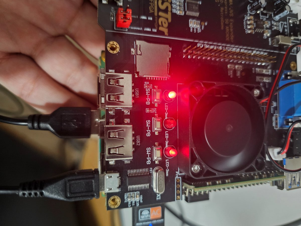

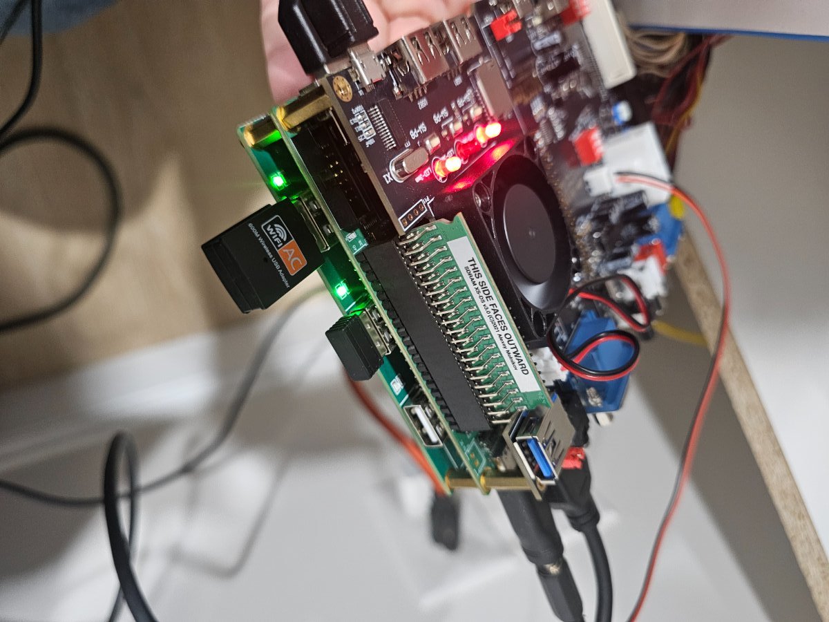

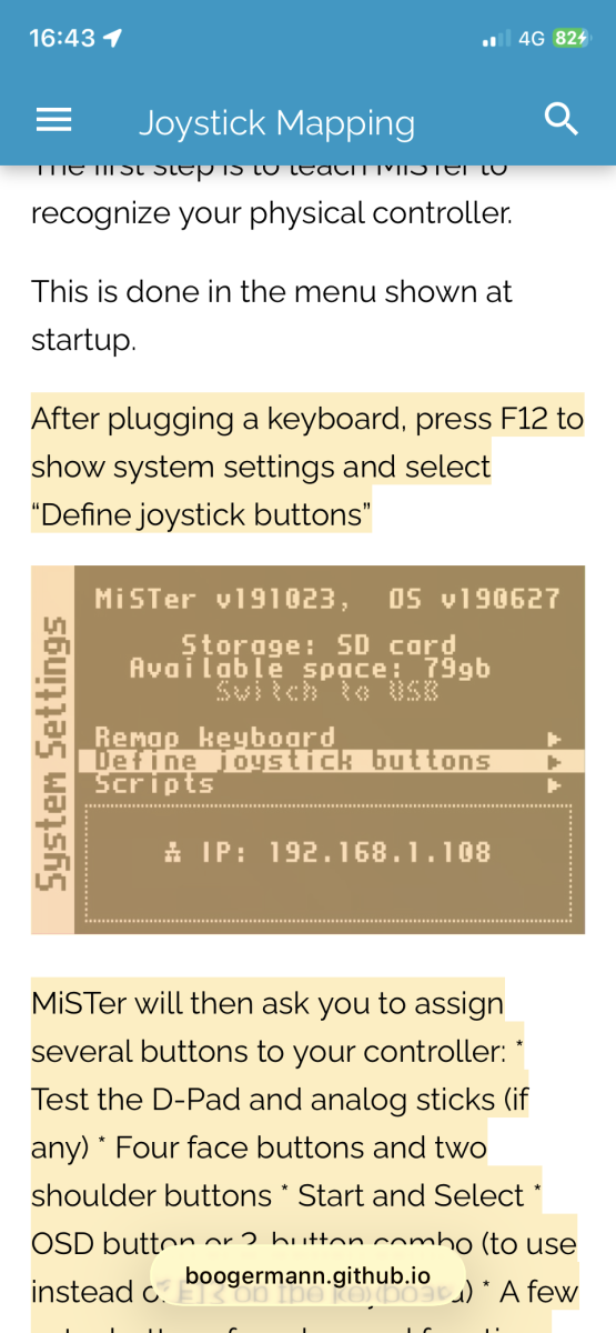

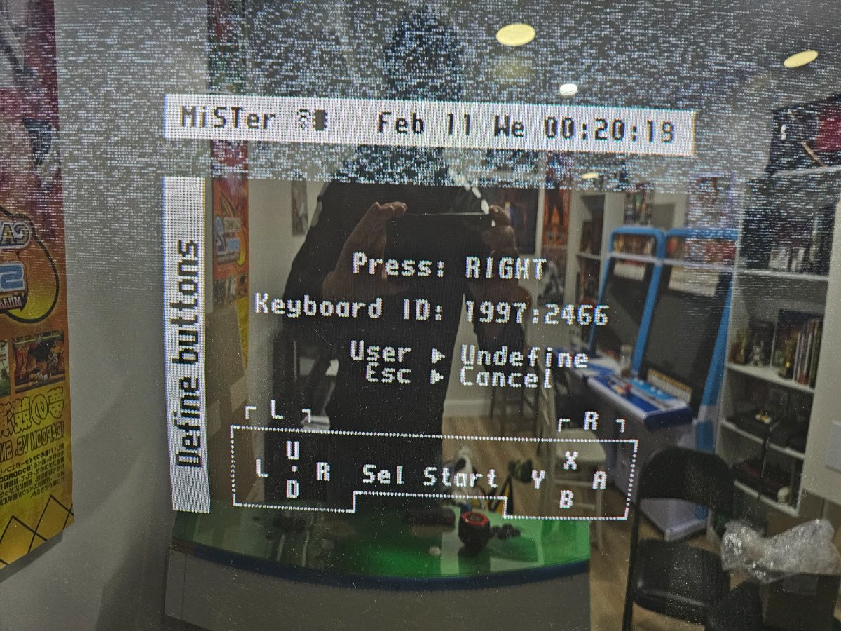

I go to system and define joystick buttons. It ask for dpad test i press my joystick nothing happens.Skip ?
Can you press Right on your stick
And it register?
How do I undo it?Ah
This is your problem
Your keyboard is set as your control device !
Yeah I'm returning it and getting a different one.If you cannot define stick and buttons in mister main menu
Here
It’s something with the Ali express pcb
I just switched it and still don't work, so it has to be the board itselfYours are opposite way ..
Up and down so to speak
Yeah just tested it on my Pandora and my naiomiDo you have a jamma pcb to test your harness ?

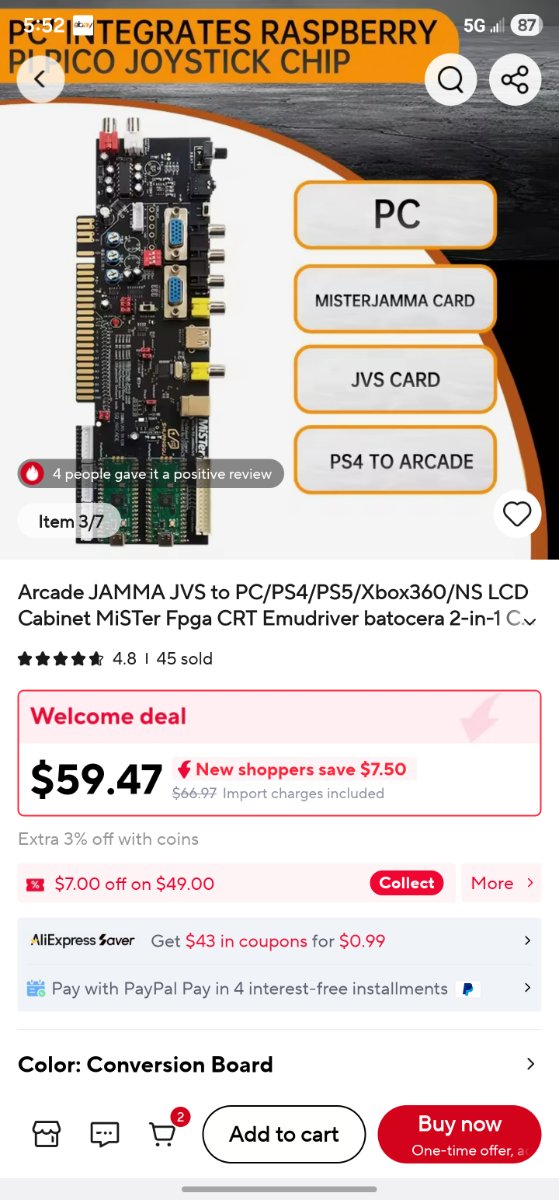

I ordered thisCool …
Shame …
Maybe it’s the pcb
At least this will confirm if its your Ali expressI ordered this

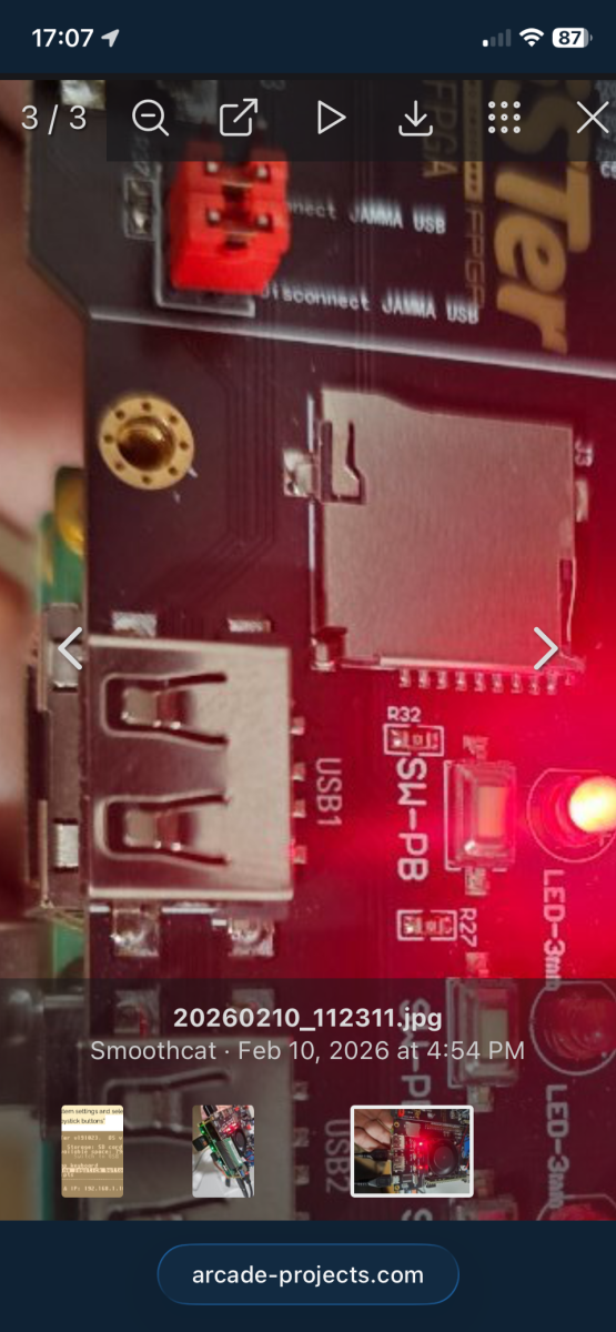

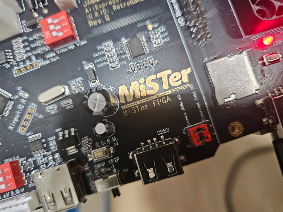

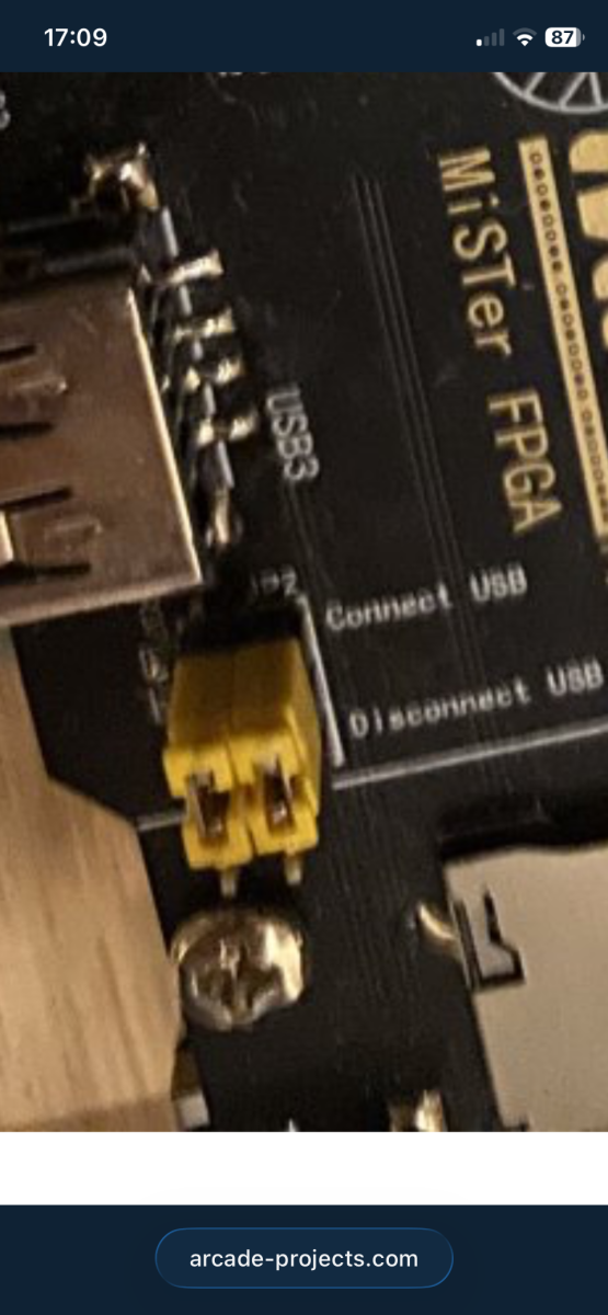

When you get it , you may have to change a couple jumpers, but mine worked out of the box. only thing I had to change was the jumpers to get the kickharness to set the buttons correctly.I ordered this
She just came in, thanks for the link..fingersWhen you get it , you may have to change a couple jumpers, but mine worked out of the box. only thing I had to change was the jumpers to get the kickharness to set the buttons correctly.
This post and above have the info, https://www.arcade-projects.com/thr...c-to-an-arcade-cab-shall-we.20382/post-484124
