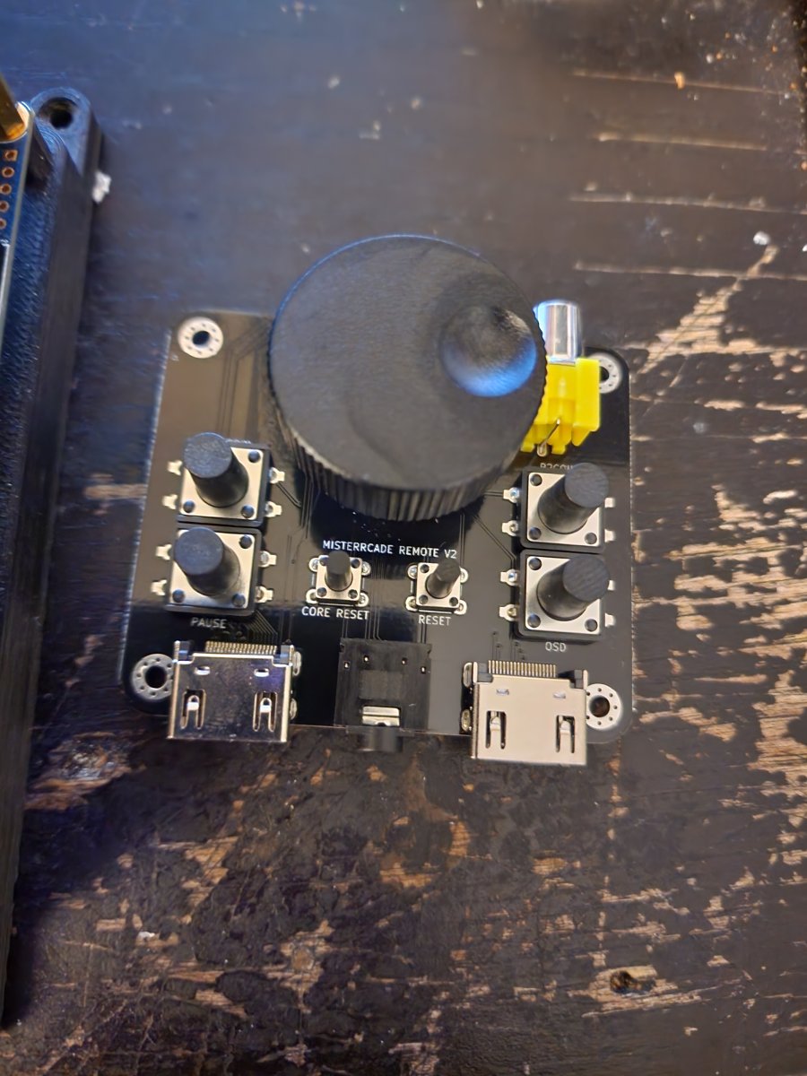

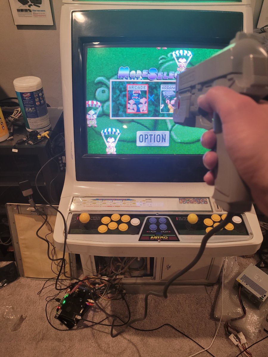

so i hooked up the top board i needed and the xl board and stuff, along with the remote v2 and i couldnt get my guncon 2 to work. idk if the guncon worked in the first place but sometimes some buttons do what they are supposed to do, and sometimes they dont and the gun never shoots nor aims. i can aim with my joystick though. p1 and 2 were both set to guncon, running on blast city with the 15khz .ini. also tried it in vga and still got same result. sync attached to the remote board and usb from guncon plugged into a spare usb port, not the snac port. just thought you would like to know, @misteraddons . ill keep fiddling with it sometime next week. cool as hell concept.
gonna go do that right now
I could be wrong, but I think GunCon 2 requires a different board: https://misteraddons.com/collections/parts/products/guncon-accessoriesnope. i bet its the guncon.
im using the remote boardI could be wrong, but I think GunCon 2 requires a different board: https://misteraddons.com/collections/parts/products/guncon-accessories
Also, I may be remembering incorrectly, but using the SNAX adapter, I had my controller set to 'SNAC' instead of 'GunCon' when I was testing my GunCon 1. Unfortunately I didn't have a CRT/cab to test with yet, but the buttons were working 100%.
Hopefully SeñorAddons can shed a bit more light.
Correct, and I'm not sure how it works with GunCon 2 since that has a USB connection. However, I know whenever I'm connected to the remote board, I need to set the controller to SNAC.im using the remote board
and use the snac port as well?Correct, and I'm not sure how it works with GunCon 2 since that has a USB connection. However, I know whenever I'm connected to the remote board, I need to set the controller to SNAC.
That’s where the GunCon 1 and Guncon 2 have a big difference. The G1 uses a PlayStation connector, (so setting your controller to SNAC may not work at all) and I have to set controllers to SNAC in order for them to work with the remote board.and use the snac port as well?
