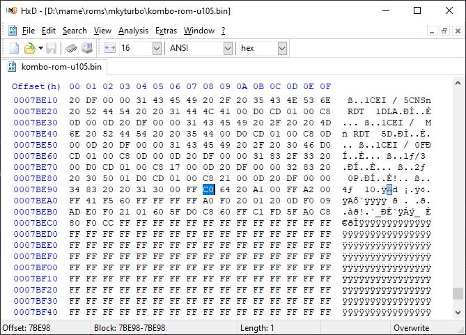

@stj sorry to bother you with this question but I simply forgot how to find an address like this one 0007:be98 can you help me?
PS: If someone could help I appreciate THX!!!!
Download HxD.
Open kombo-rom-u105.bin with it.
Scroll down to 0x7BE98.
Change C0 to 60.
Then go to 0x7BEA3, and change 60 to C0.
Profit?
