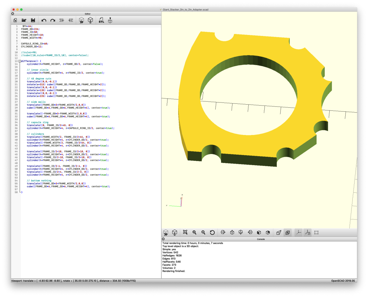

OpenSCAD is something I use frequently that hasn't been mentioned yet? It's essentially a scripted CAD. I think it's really useful if you want to do parametric based modeling where everything generated on geometric principles. Obviously it doesn't excel at organic shapes, but it is super useful for creating things out of geometric primitives and boolean operations. It is what I go to if I want to bust out a quick replacement part. For instance here is a part I made for the Giant Stacker machine:
