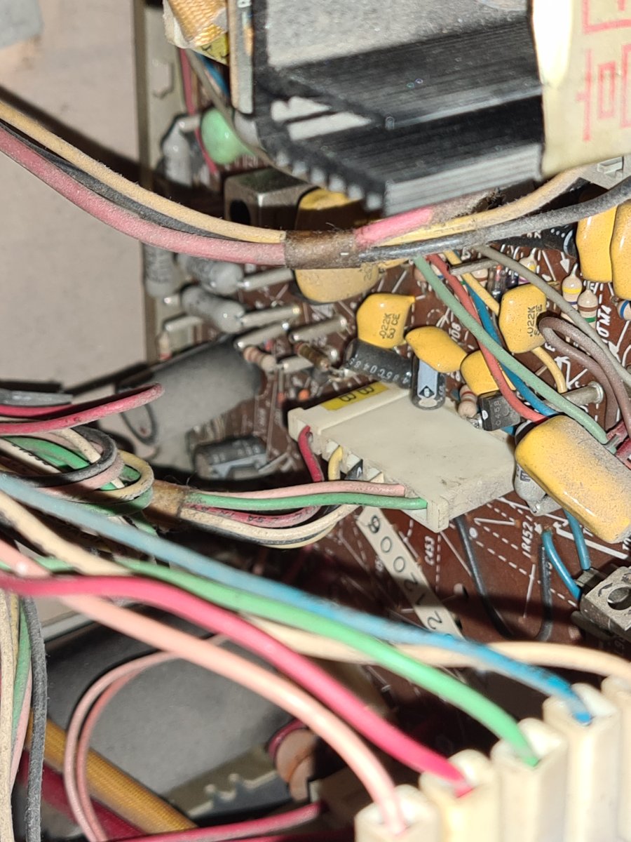

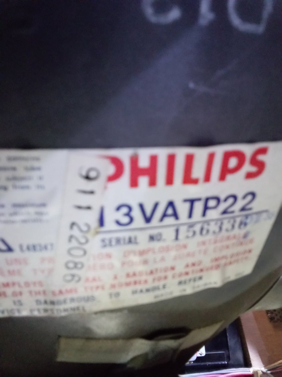

hi yeah I've tried the pots and checked things are connected fully. unfortunately I've never been able to identify the monitor chassis as it has no markings or names i think its probably Japanese. its been in our family for over 35 years so its pretty old because it wasn't new even then. i think it was originally a space invaders cab but was converted into Ms pacman here are some pics it does say Philips under the monitor but i thought that was just who made the tubes but I'm guessing to be honest

If nothing was changed and its a gameboard that has worked in it previously without fault I would think it that if its rolling rather than scrambled that it could point to some leaky caps if nothing is lining up after tweaking the v or h holds If something was changed it could be mixed up cabling or hold need to be mm fine tuned (gunblade UKVAC/grantspain AO not sure if he is on here) Is a good monitor tech in the uk for repairs if you getting nowhere.
yeah I think maybe something died like you say ill have a look to see if I can see any leaking caps I've tried 2 different boards in its and its the same. its never been recapped so i wouldn't be surprised if its something like that.
so I've had a look cant see any leaky caps but I've noticed the picture is more scrambled now basically its all over the place
