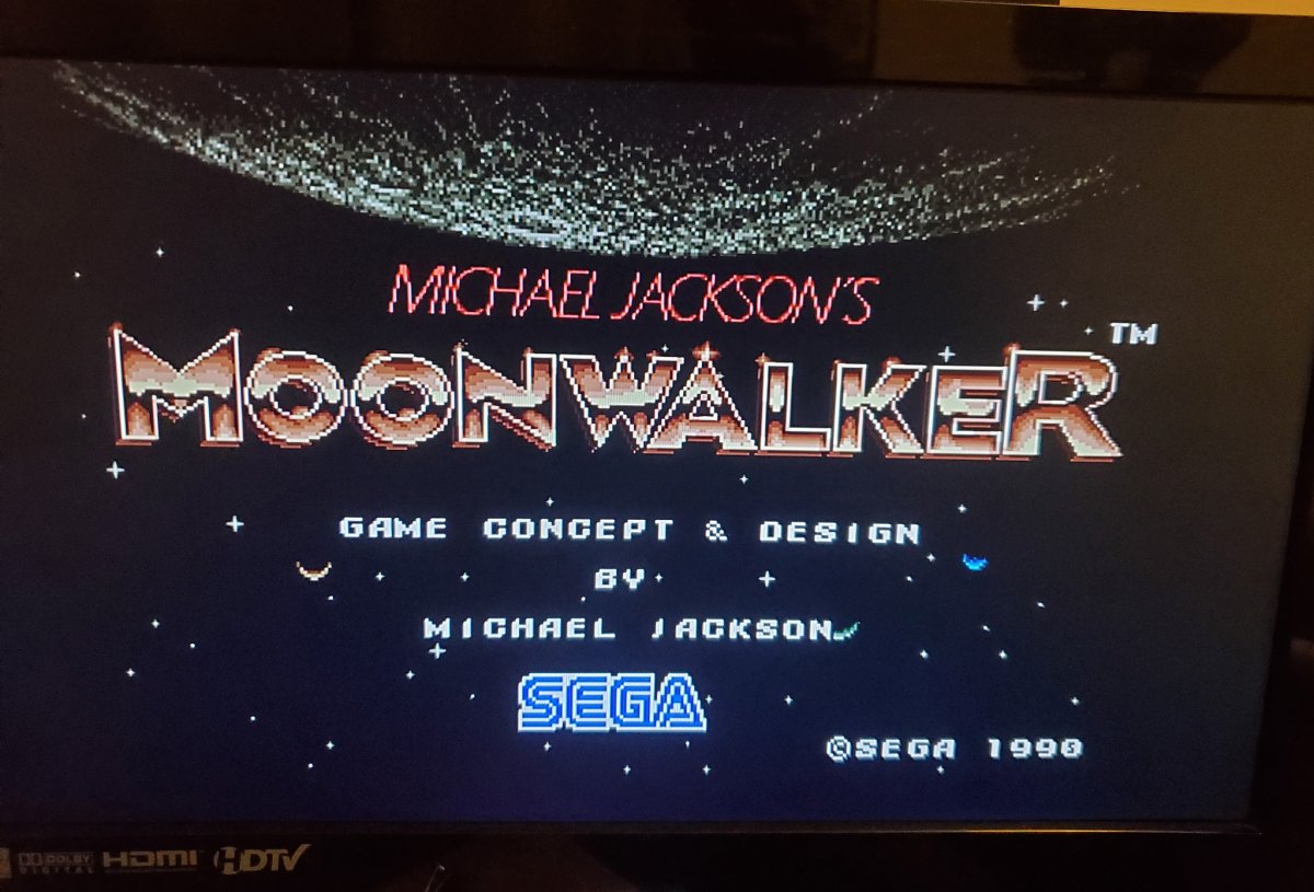

Well...it's working now, at least on a supergun.
Cannibalized a broken title fight and ended up replacing a TON of chips.
As a sanity check I tested all previous configurations and they all worked.
original roms, mcu and reprogrammed FD1094
decrypted roms, mcu and 6800
no mcu roms, no mcu and 6800
