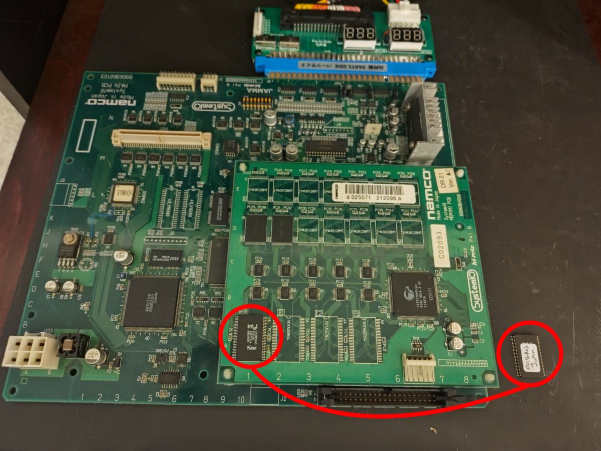

This is probably the lowest effort "conversion" that I've done and I debated even posting it, but in case anyone wants to do the same thing - per the MAME source, it looks like most System 10 games share the same security chip across multiple regions so region conversion comes down to just a simple ROM swap.

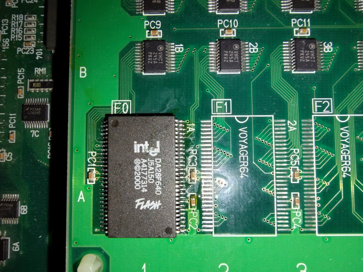

In this case, it's only the SSOP56 Intel DA28F640J5 chip at location F0 on the ROM board. Truthfully, being that it's a flash eeprom, I probably could have just erased and reprogrammed the DR21 chip, but I don't like messing with original ROMs if I don't have to.
Used the SSO-056 adapter on my Xgecu T56 with a Intel DA28F640J5 chip sourced from AliExpress.

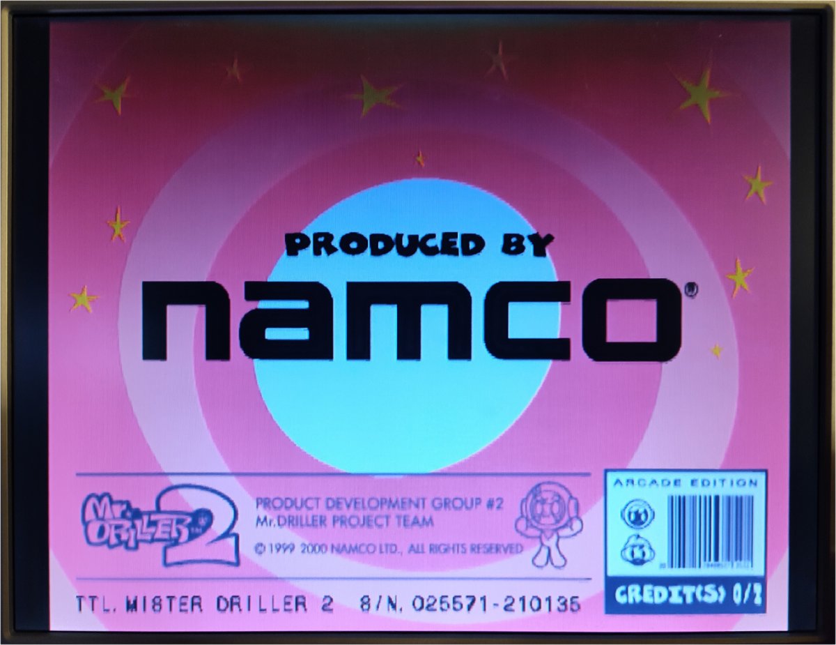

And yes, it is now the same serial number as the DR23 set in MAME and, hence, your board :saint: S/N. 025571-210135
