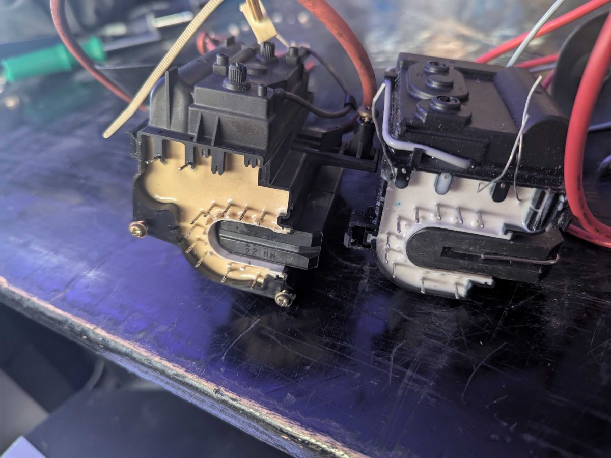

So I've got an MS2934 that appears to have a bad flyback.
board's recapped and continuity tested, transistors appear fine. 180V @31KHz pin on the flyback is not outputting.
The labels on both flybacks I have as samples are long since worn.
The service manual I've been able to locate does not a part number for the flyback, so I'm not 100% on which flyback it actually is.
Does anyone know what flyback is in this? is it the same one as the 2931/2932?
Or does anyone have a more complete service manual, with a BOM?

I've asked an expert and received a tentative answer that the MSU1FUS11 from the MS2930 and MS2931 should be compatible. Up for an experiment?
