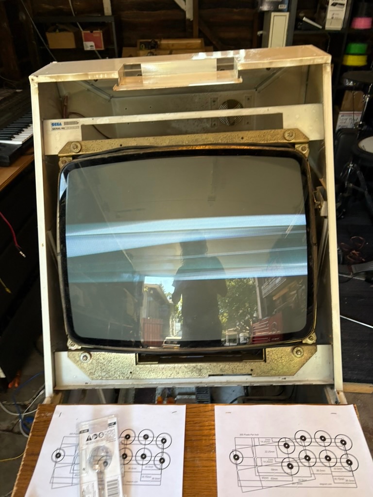

After installing everything back into the chassis, I fired it up and the picture was way too small and kind of dim. Adjustments didn't help. Something was wrong. If I leave it on, eventually the picture would stretch out horizontally, and it made the worst squeal i've ever heard in my life. This seems temperature related because it usually takes 10 minutes or so for it to happen. If I unplug for a few seconds, it'll be fine for a few seconds and then happen again. If I wait until it cools down, it takes 10 minutes to happen.

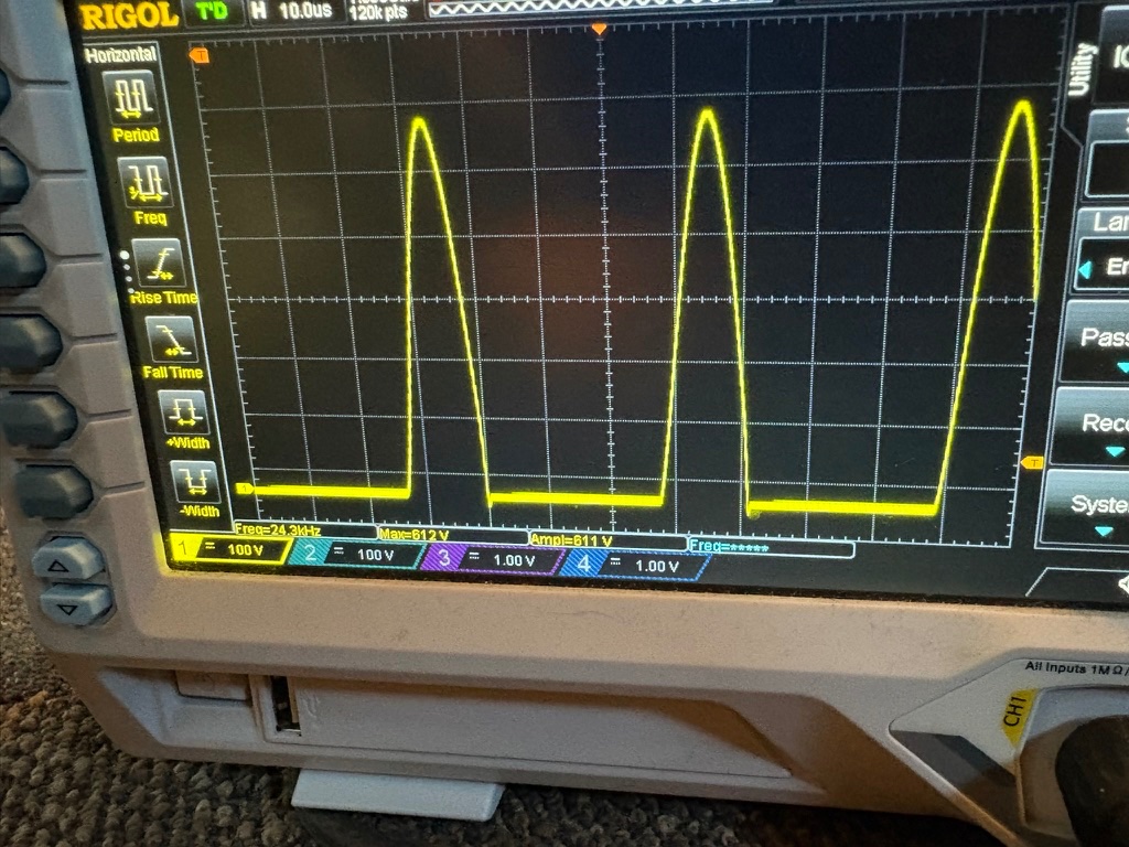

I stuck an oscilloscope on the collector of HOT and it was running at 24.3Khz? To my limited knowledge, this should be around 15khz. Just as a test, I moved the tap to the 24khz plug on the board just to see what happens. I get the same frequency, although the waves look a little different, and vertical collapse on the screen.

raster on cold start, picture too small.
if left on for 10+ minutes, accompanied by awful high pitched sound.

Oscilloscope probing the HOT. 24.3khz.
