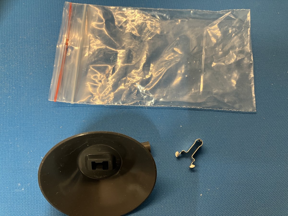

Progress update. I fixed this a few days ago, and thought I'd document everything here.
I got a replacement anode cap + clip from a friend. Unused and very similar to the one on the MS9 flyback:

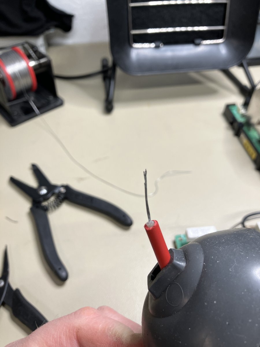

Here's what the old broken one looks like, it's soldered together with the wire:
So I just cut it and stripped the wire:
