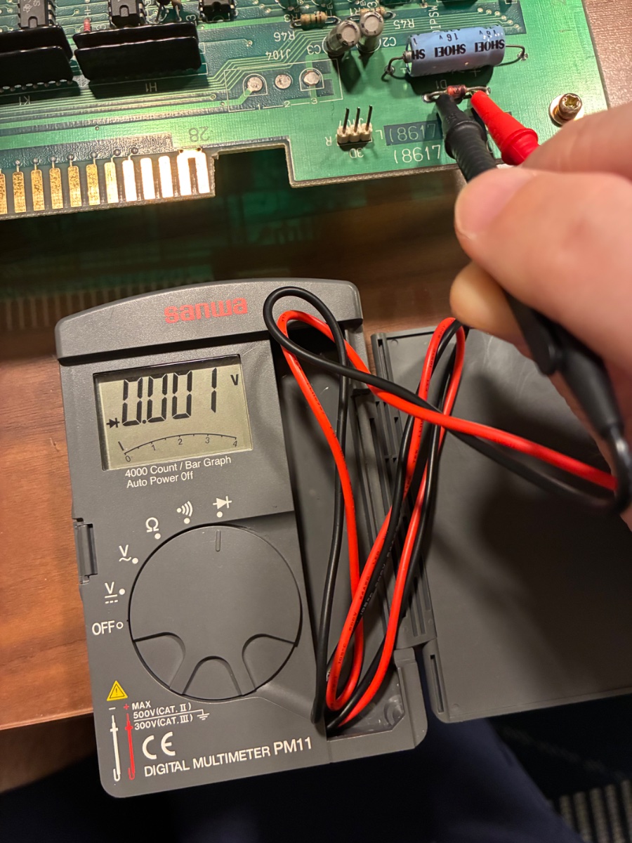

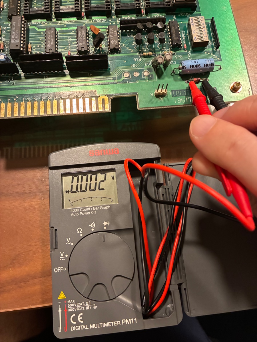

Is it enough to prove that the diode is shorted ?
I think so,
to be sure, you have to desolder or cut one leg...........
The board runs even without the diode,
hopefully, nothing else is broken...........

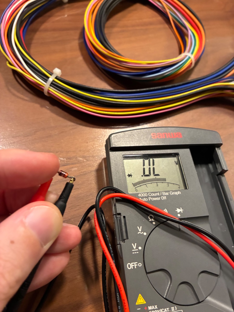

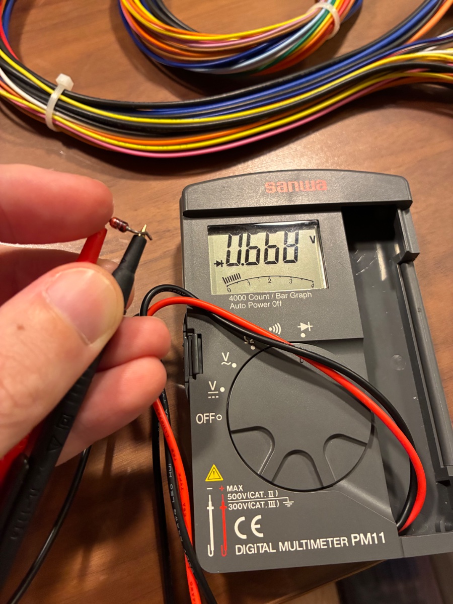

The diode was still functional. When I plugged the jamma board and power on, I measured the 5V with my meter and it was 0.87v. I calibrated the meter to 5V before plugging the jamma to the board

Then there is a short circuit somewhere else,
you have to find it...........
It will be very difficult to locate the fault without specialized equipment.
I suggest sending the board to a professional..........
