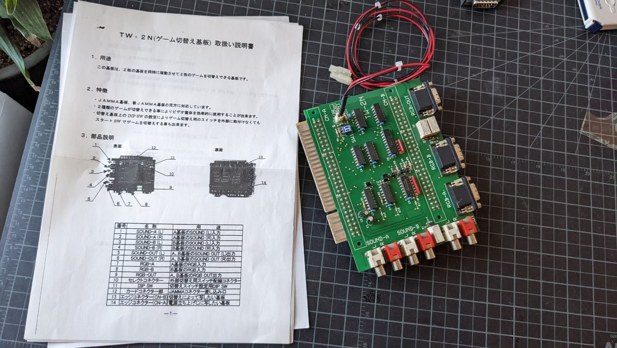

Sanwa made two official switchers that are very high quality, the TW-2 (JAMMA) and the TW-2N (JAMMA + JVS). If you can track either of these down they are worth the money.

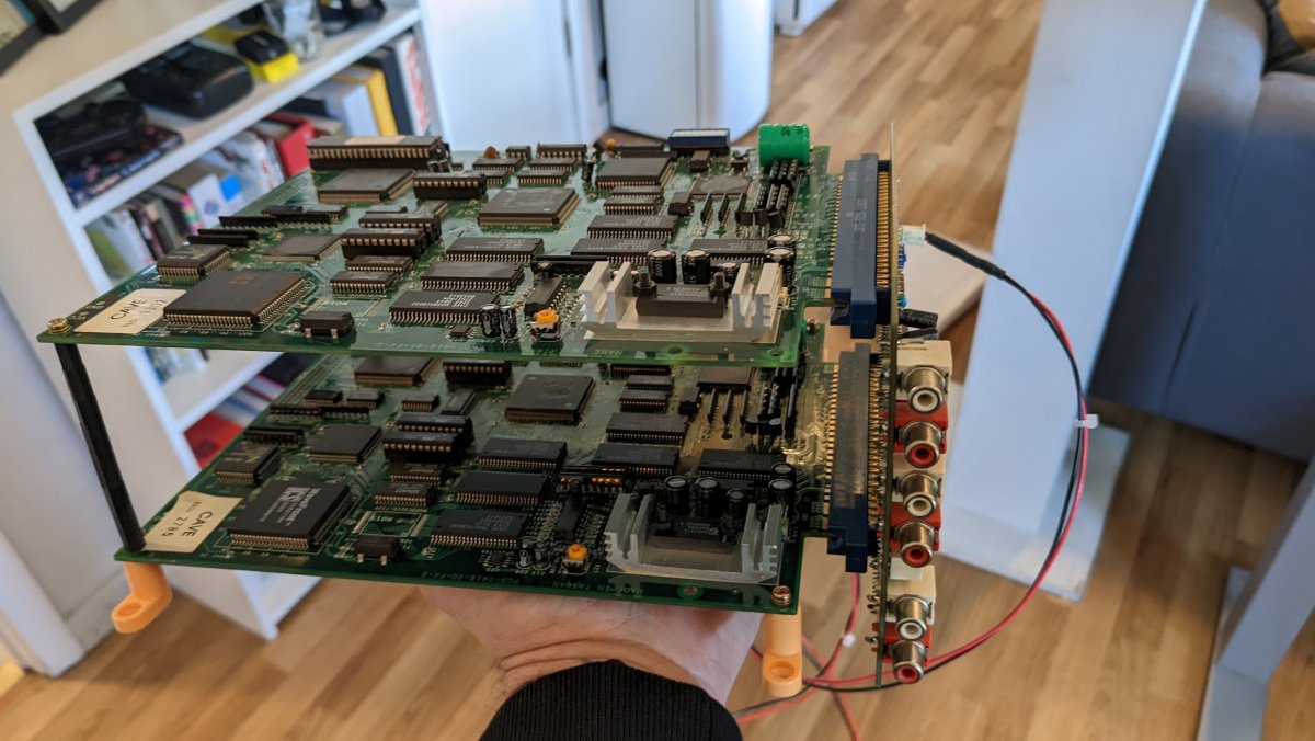

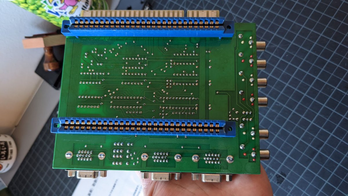

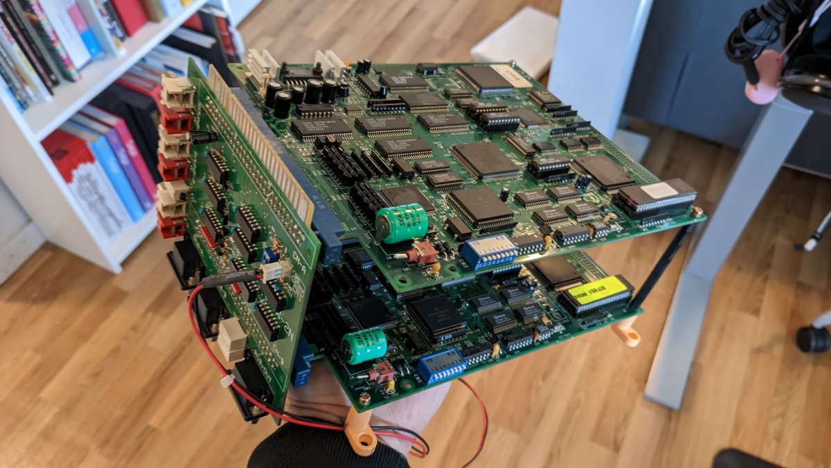

Here are some (cursed) photos of it with Ketsui and Galuda installed at the same time. And here is a video of the switching in action.
The space between the JAMMA connectors is approx 75mm. After this photo, I purchased some M3x75mm aluminum standoffs to replace the nylon tower in these pics.
In terms of space management, it mounted quite easily inside an Egret 2. I imagine if you are using boards that are different shapes and dimensions though it could get tricky!

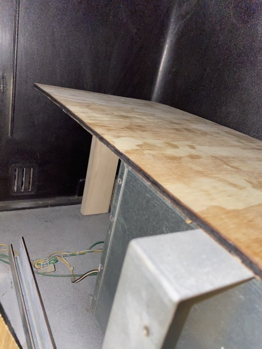

Regarding having multiple boards in one cab, I’ve been able to fit 4 boards in an Astro City at once.
I’m utilizing the space behind the coin door by installing a wood shelf designed by @Softdrink https://github.com/Softdrink117/new-astro-city-cashbox-shelf
Works well for boards that have multiple parts like the Naomi.
I’ve been able to put 2 beside the PSU, and 2 stacked on the coin shelf.
Always glad to see people making use of it! :thumbsup:
There's a thread here about it too, with a couple more pictures than the github repo.
(Also just realized I forgot to add final photos to the shelf repo and thread... eek! I'll try to do that in the next couple days) OK, updated!
