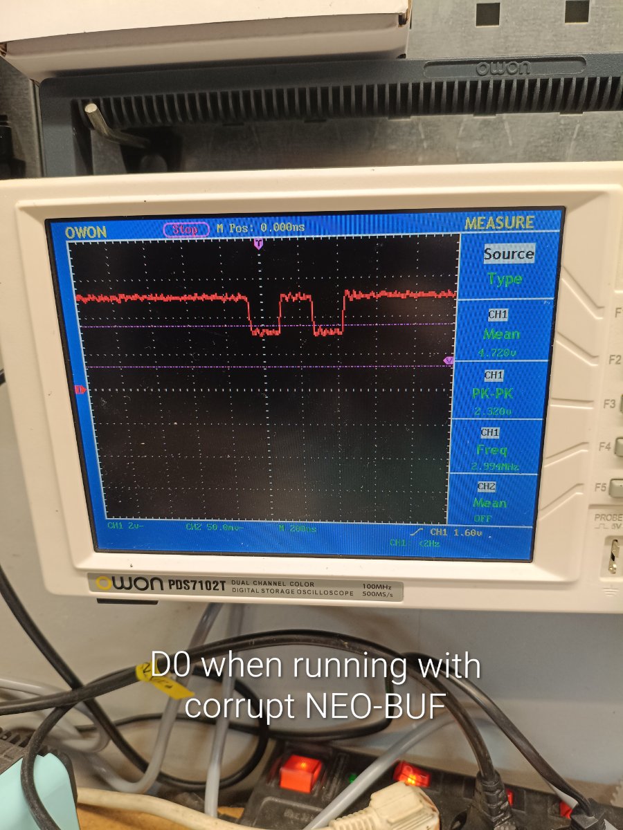

Checked the adress and data lines on the bios. D0 had a dc offset which probably messed upp the whole operation. These errors I usually hunt by lifting the affected line at each chip, one at a time.
Experience told me to start with the NEO-BUFs and sure enough, when D0 at Neo buf at ga8 was lifted the bias went away.

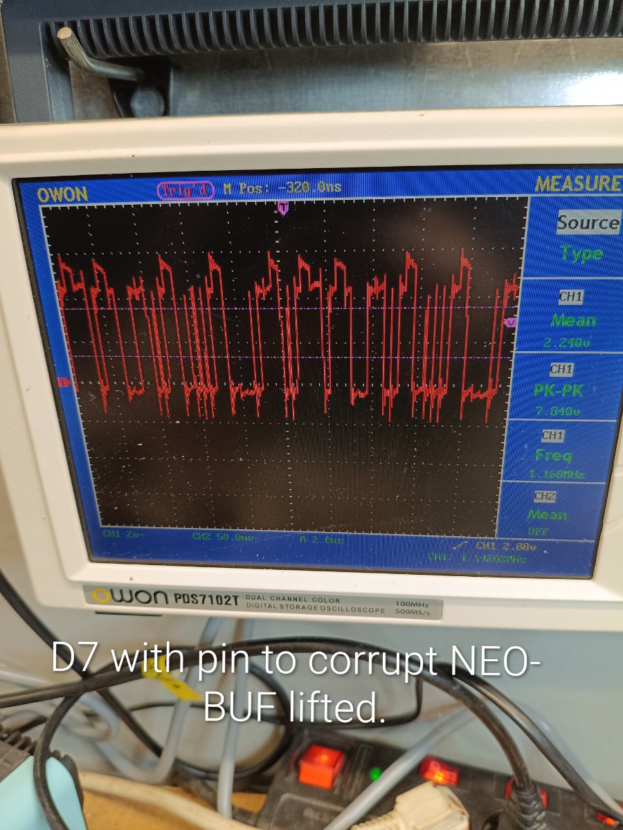

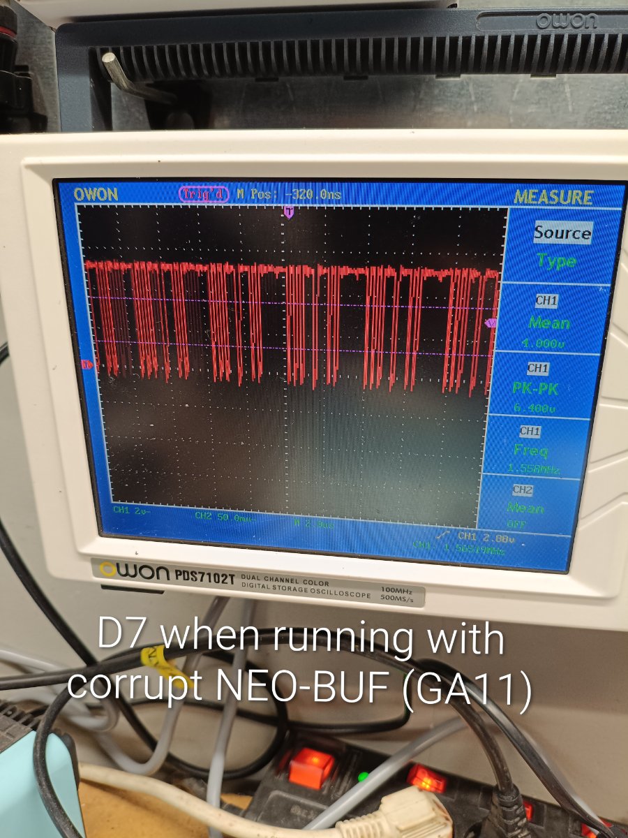

To make a long story short I checked the adress lines and data lines again. Seemed ok. Then I did my math and took a closer look at D7. And while it was pulsing it behaved different, inverted, than its corresponding pin at the lower wram. Checked with a working board and sure enough, in comparison D7 on the project board was corrupted.
Same procedure. Started to lift pins and found another faulty neo-buf, this time at GA11.

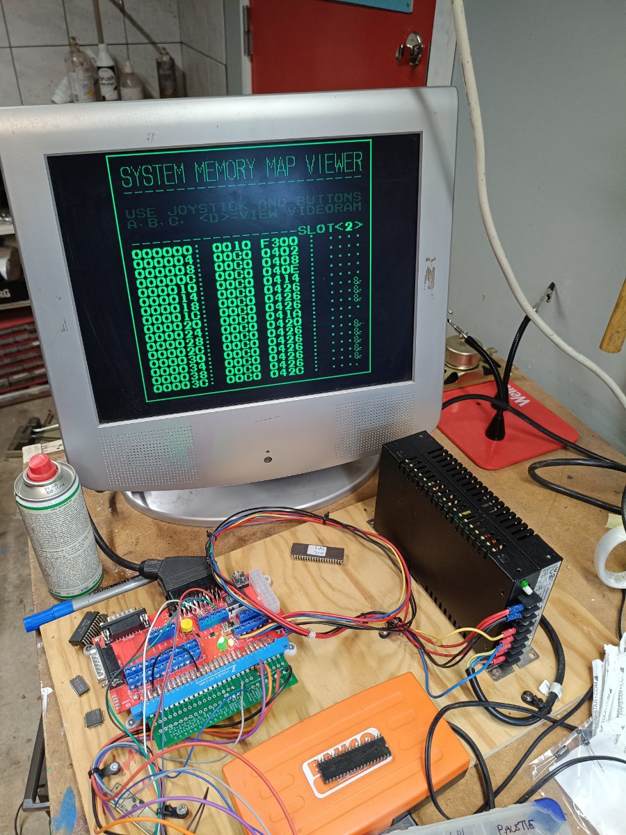

Put in Unibios but no change. Ran the memory viewer. I did't really understand the data being presented. But with a cart in I noticed that the system tried to read from Slot 2.

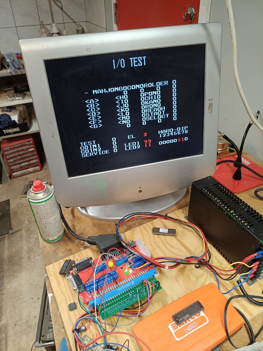

Rebooted a couple of times and then the controls went crazy ... managed to get to the input tests and was presented with a somewhat corrupted ... Mahjong controller screen. LOL!
This made me suspect the neo-f0 which handles slot select and dip switch readings (dip 3 is Mahjong). Input tests said that dip 3 was off. But still the system wrongly believed otherwise.
Then the all of a sudden the slot switch error returned. Long story short: changed sm1 - no change. Changed to another Z80 and got the all tests passed again.
Still the dip switch drama and not booting carts so decided to change Neo-f0. Since this the random Mahjong controller issue stopped. But still no boot.

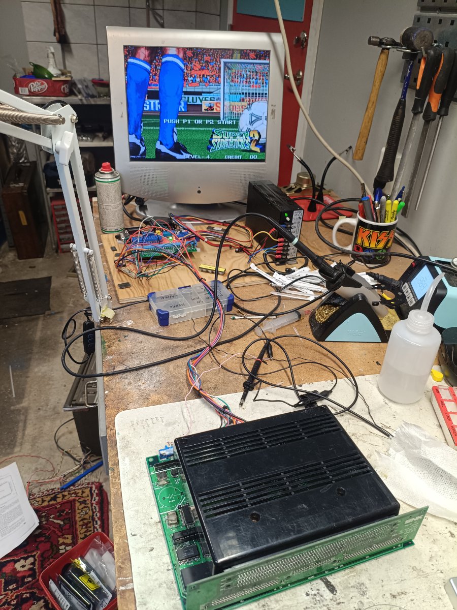

Put in super sidekicks 2 and scoped ROMOE on the backside of the cartridge board (vertical oriented). This was pulsing on start up. Scoped all the pins on the progboard. When I looked at the data lines many of the looked suspicious. They were pulsing but the signals looked weird and/or had an offset of around 1 volt (sorry no pictures). I traced the data lines which led me to a NEO-BUF @ GA11. This had been replaced earlier but this time I used a repro from furrtek. Put in super sidekicks 2 and booted to a perfectly running game.
